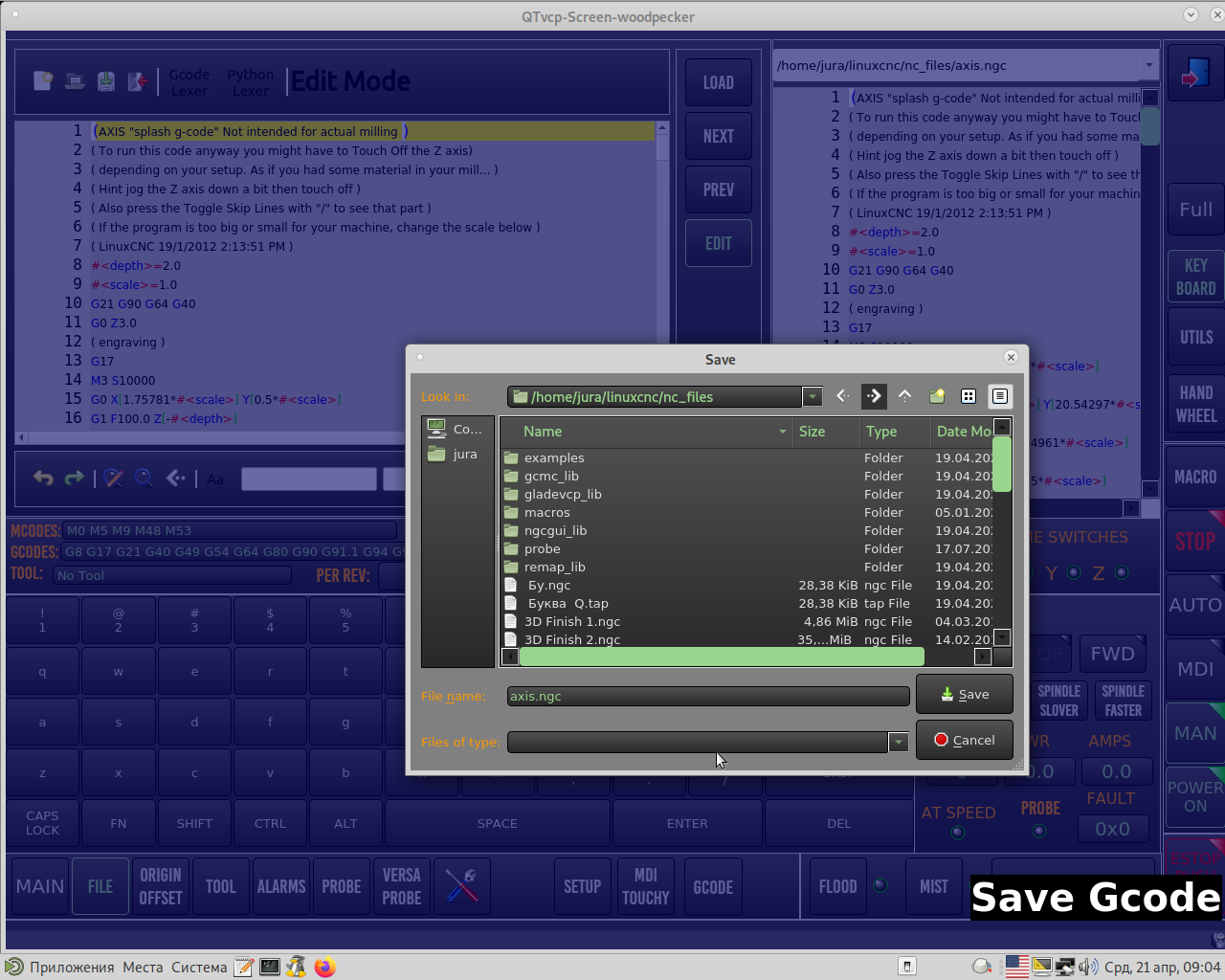

When you say use_keyboard breaks down, do you mean that you can no longer jog after you close the editor?

You add such lines to the handler and you will see everything for yourself. Thanks for attention.When you say use_keyboard breaks down, do you mean that you can no longer jog after you close the editor?

But what is EDITOR? Where is it defined?

What were you trying to get the editor to do that it didn't before ?
EDITOR is not a reference in the linuxcnc version of woodpecker.
Are GCODE and EDITOR the same widget class ?

This allows the existing file name to be overwritten when saving. The tooltip doesn't get in the way.
I took these lines from the qtplasmac handler. Thank you!

keyboard works, but the effect disappears when the file is saved.
Replied by hottabich on topic Gcode Editor saving issues
Thanks for the hint, but if you writeBut what is EDITOR? Where is it defined?
from qtvcp.widgets.gcode_editor import GcodeEditor as EDITORPlease Log in or Create an account to join the conversation.

I am willing to try to help, but I don't use woodpecker, and even still without you describing the problem you're seeing, it's difficult to know if I'm seeing the same thing, especially on a GUI I'm not familiar with...
Assuming you cant jog after closing the editor... and thinking back to when Phill added those lines to QtPlasmaC, I think after their addition we saw an issue with being unable to jog after the editor was closed.
I believe the fix was to add this line at the right spot:
Replied by snowgoer540 on topic Gcode Editor saving issues
ACTION.SET_MANUAL_MODE()Please Log in or Create an account to join the conversation.
