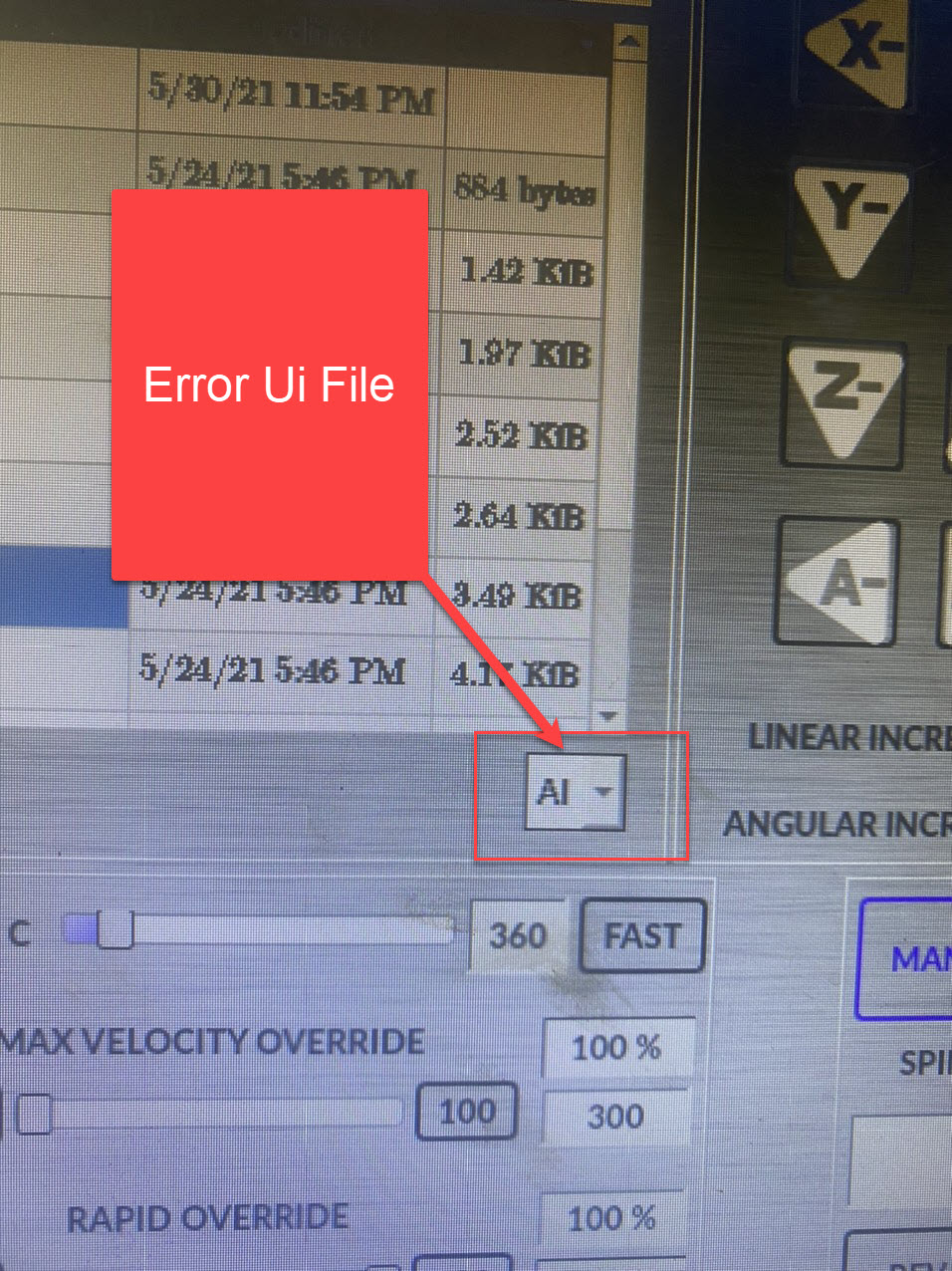

dear all,
Can you help me check this issue? It can't full display in my dragon gui.
thanks
thanks

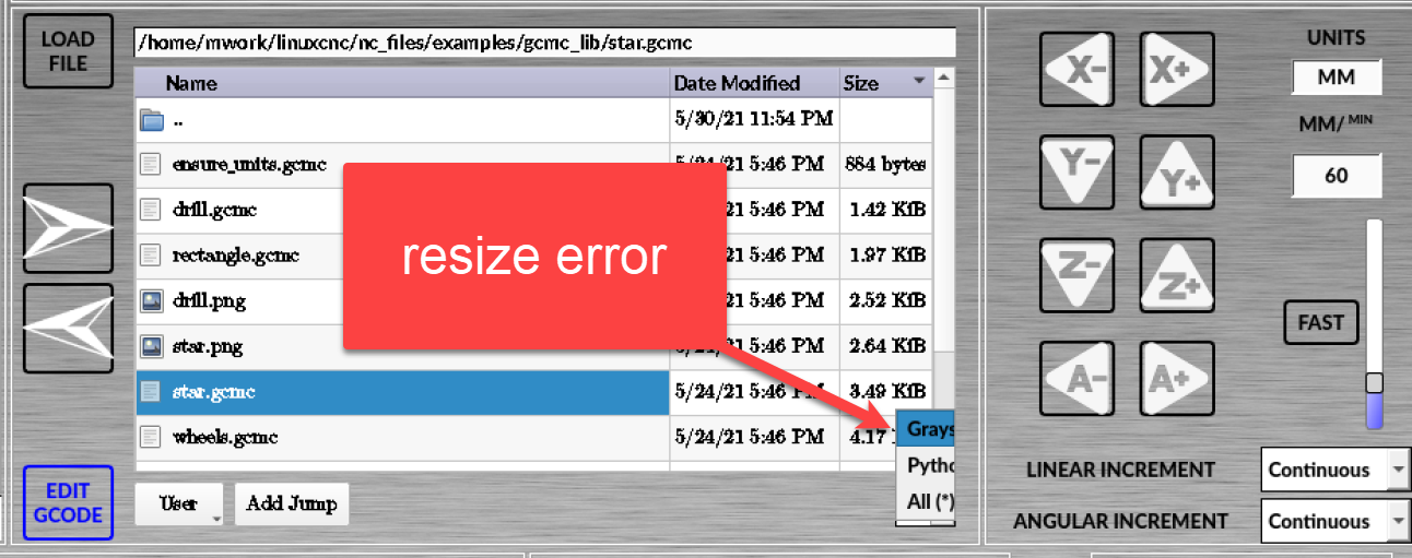

dear sir,
I'm using V2.9.0 Pre0. I build from the Github master brand.
Yes, this is qtdragon. I just resize the button on the screen.
Can you give me the information to change this theme?
can I modify this? I can't find this UI file
thank you for your helping

dear sir,
I added this code to qss file. It solved this issue
thanks#filemanager QComboBox {
min-width: 300px;

excellent - i'll see about adding that to the default theme.
