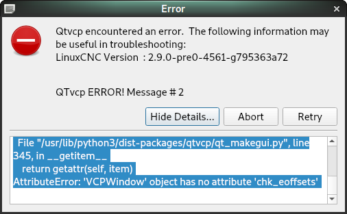

Hi there
I don't know if this is the place to report this but after I have done an update using the latest development version I try to start QtDragon.
If there is a better place to report errors like this please let me know.
Thanks.

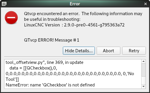

unfortunately that isn't the info I can use.
See how it says error #2 - press retry until it says error #1 - and please post what it says.
Chris
Chris

I think i figured it out - and pushed a fix. Thanks!

Sorry I was a bit slow getting back to you.
I have done an update & it does appear to be working again.
I have attached the info you asked for just incase there is anything useful.
