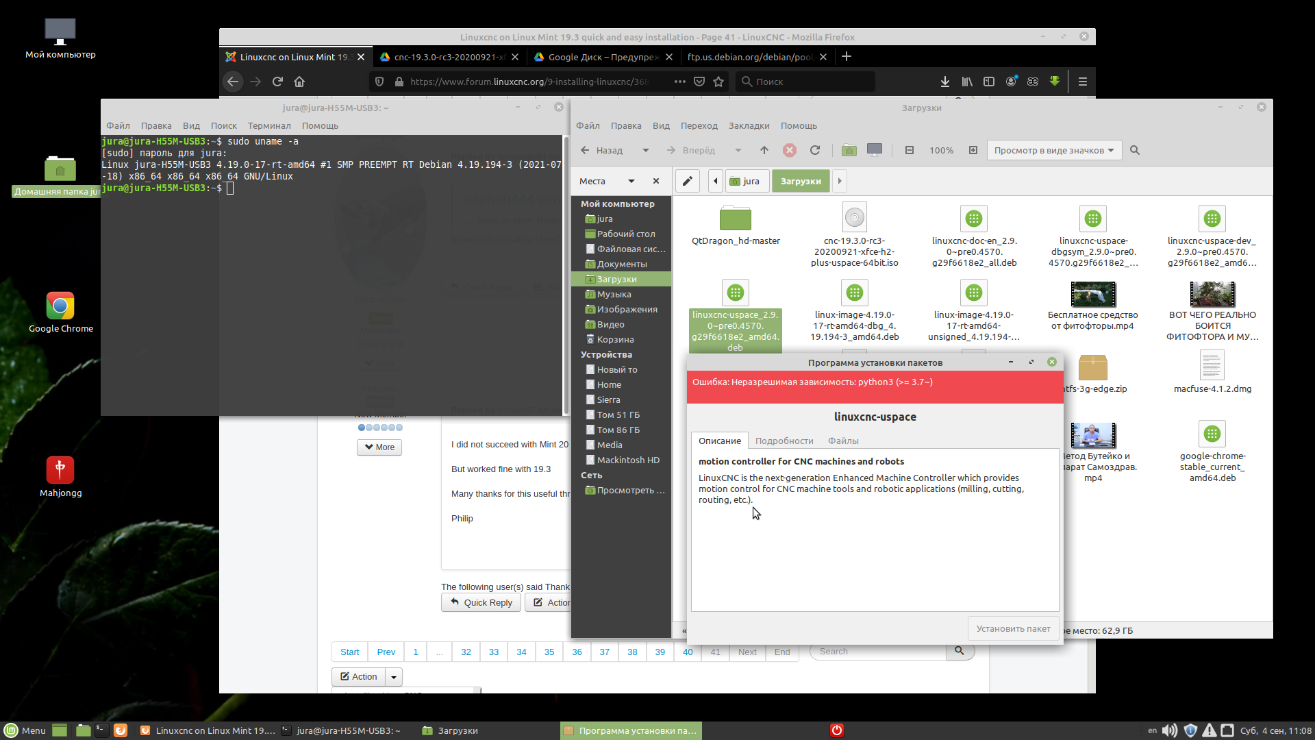

Sorry that this is not the topic, but in the subject of Linuxcnc Install I have not received help. LinuxCNC 2.9 PRE stood on Mint 19.3, when upgrading from BuildBot is required Python 3.7 How to fix it did not find information. I thought a man would say.

This will help you: stackoverflow.com/questions/22739382/how...n-runs-from-terminal
Replied by ikkuh on topic QTDragon_hd with auto toollength measurement

Thank you for your attention and help. I will try. I think everything will work out.
