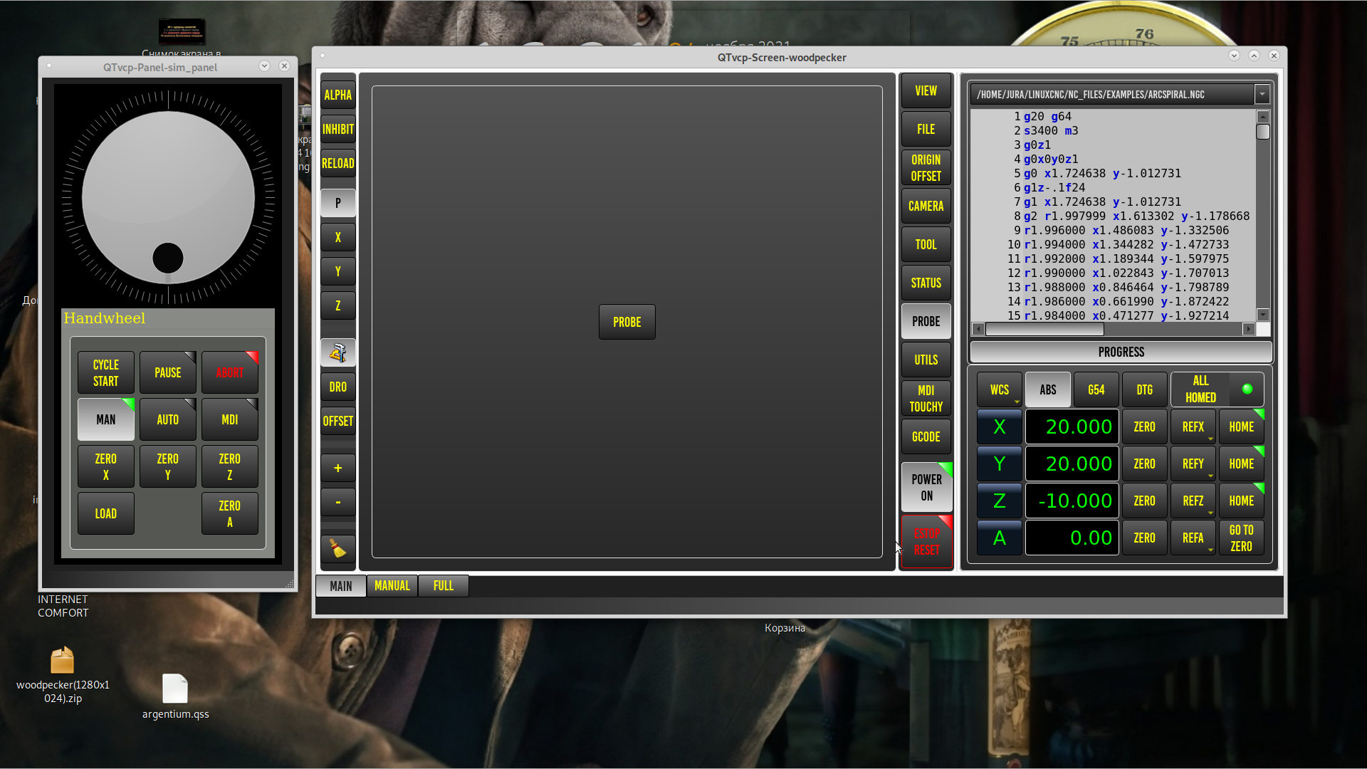

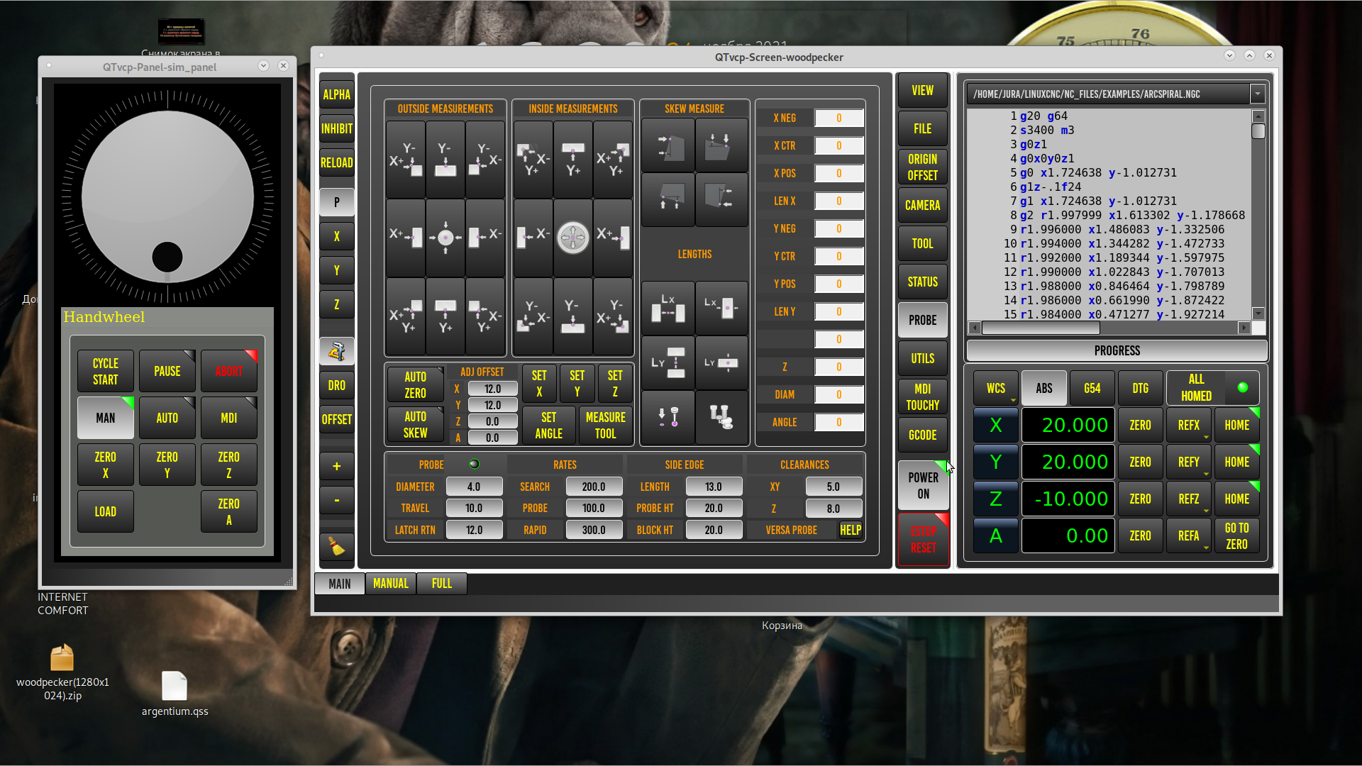

And if you add a tab on the VersaProbe page and place what you need there.

All variables in one place is not very convenient. I think it's logical to place variables for Measure Tool with Versa Probe. The example in the screenshot is also QtDragon with a different face.

If I may, I would like to add my $0.02 worth. In qtdragon, there are 2 types of probing. The first is single axis (Z axis) probing for finding the top of the workpiece, either through use of a touch plate or through use of a tool setter device. The probe parameters that you see on the Settings page are only for these operations and are not used for any other probe routines. The second is 3 axis probing implemented by either the versaprobe or basicprobe screens. The main difference between them is the graphical appearance. Many of the probe routines are implemented with the same python code and even the unique routines are defined in the same python library module. The probe parameters used by these routines have nothing to do with the parameters on the Settings page. Through the [PROBE] section of the .ini file, a user can opt for using versaprobe, basicprobe or none. As Chris mentioned, they can also be used as a dialog session. For these reasons, IMO, it is not advisable to combine all the parameters into the Settings page. I will concede however, that the probe parameters in the Settings page could be renamed, so as not to be confused with the parameters for the probe routines.

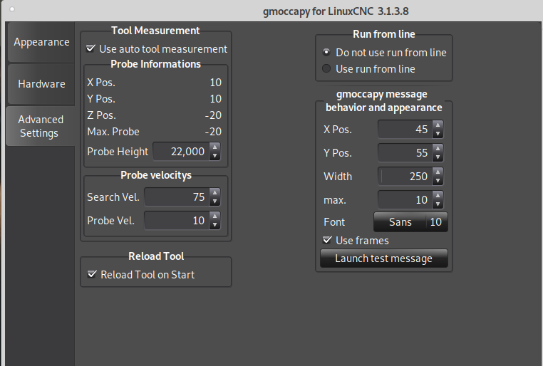

All settings are set on the settings page, I agree with you if the settings are divided into separate groups, such as in gmocappy.
