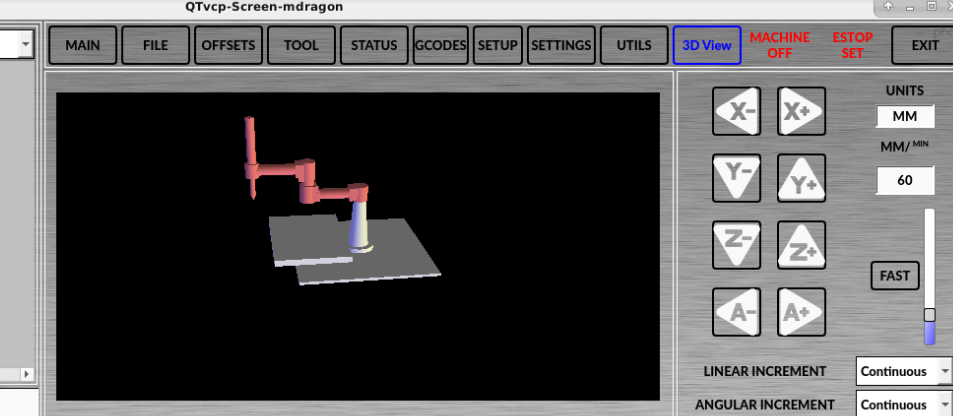

On a semi-unrelated note, we found this post (www.forum.linuxcnc.org/qtvcp/43377-import-tk-vismach-to-qtvcp) where annhandt09 managed to embed the scara tk vismach into qt_dragon. We can't seem to figure out what to replace "self.w.xxxx.addWidget(machine)" with. Any help?

- Posts: 7368
- Thank you received: 2181
11 Mar 2022 19:30 #236972
Replied by cmorley on topic [QtDragon] Simple vismach window
guessing that you already figured out how to modify qtdragon's handler.
The problem is that you are trying to place the vismach widget into a widget in qtdragon that does not exist. try this:
self.w.horizontalLayout_3.addWidget(machine)

- RomeReactor
- Posts: 35
11 Mar 2022 19:55 #236974
by RomeReactor
Replied by RomeReactor on topic [QtDragon] Simple vismach window
Thanks for your last reply. Embedding worked with:
and:
import press_brake as MILLmachine = MILL.Window()
self.w.horizontalLayout_3.addWidget(machine)Please Log in or Create an account to join the conversation.
