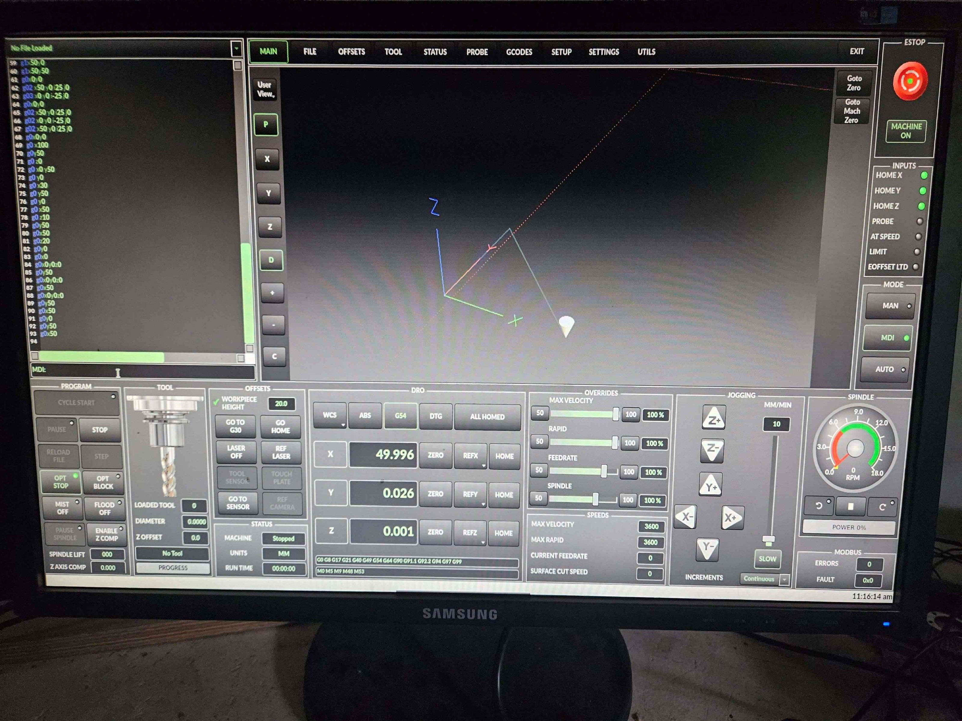

Hello all!
I am currently building a small CNC router using LinuxCNC and QtDragon_hd as GUI. The GUI loos great by the way!
I am having some difficulties on tackling last oddities/bugs out of my system so any help would be greatly appreciated here.
I configured the machine to use XYYZ kinematics with kinstype=both. However my machine axis layout is actually YYXZ as how the axis are arranged in respect to each other. Does this have any impact on the operation? I tried changing the kinematics configuration to YYXZ from .ini file and remapped the joint-pins to the correct drives to reflect the new kinematic configuration. The machine jogs and moves correctly in the coordinated mode (after homing) but joint moving (before homing) seems to be messed up after the change. The Z axis buttons are only ones that can be pressed and they seem to drive the X axis. Y and Z axis buttons throw a message that "cannot jog joint N because home sequence is synchronized". The X axis has only motor so that at least should not be synchronized axis.

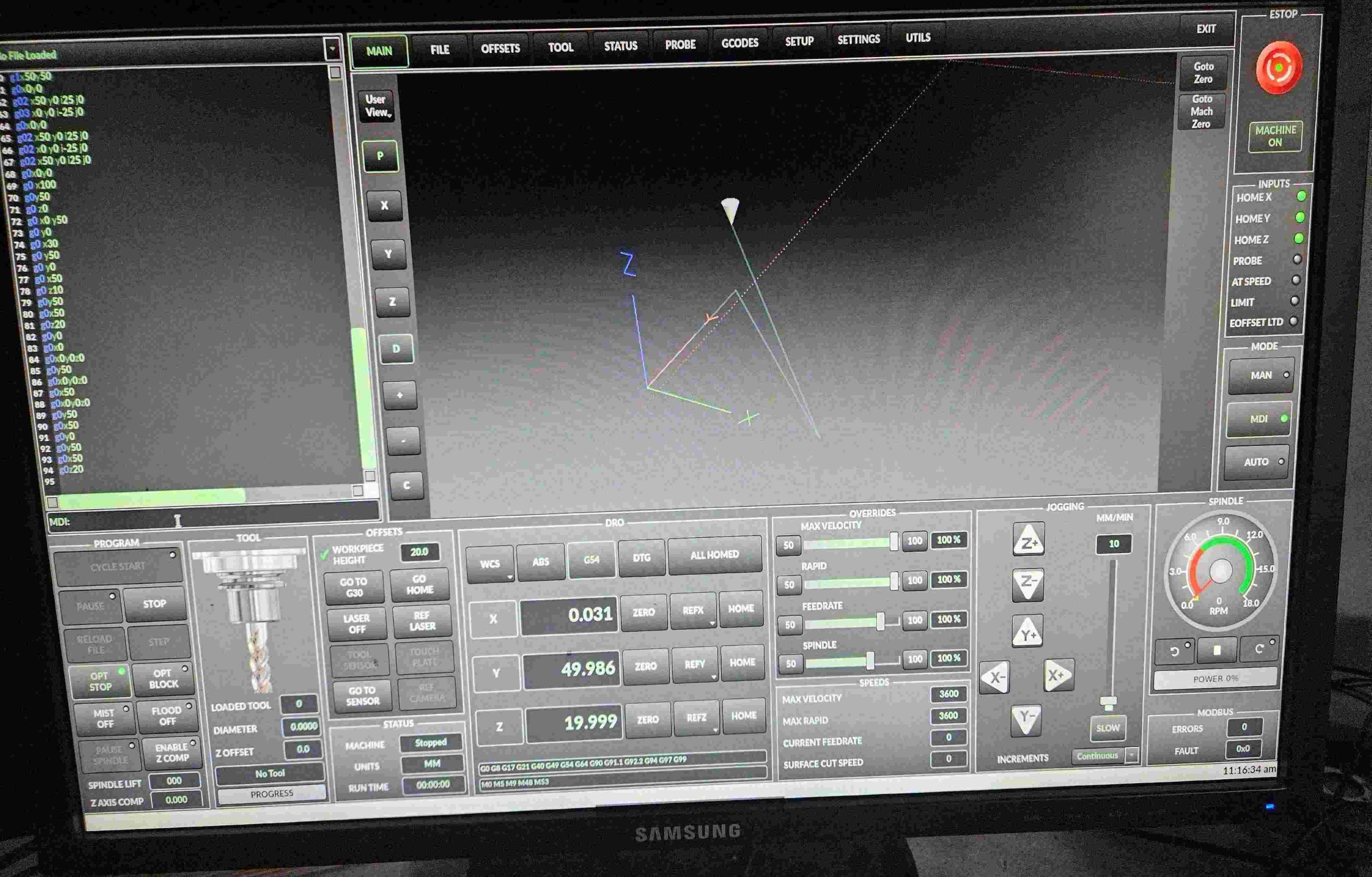

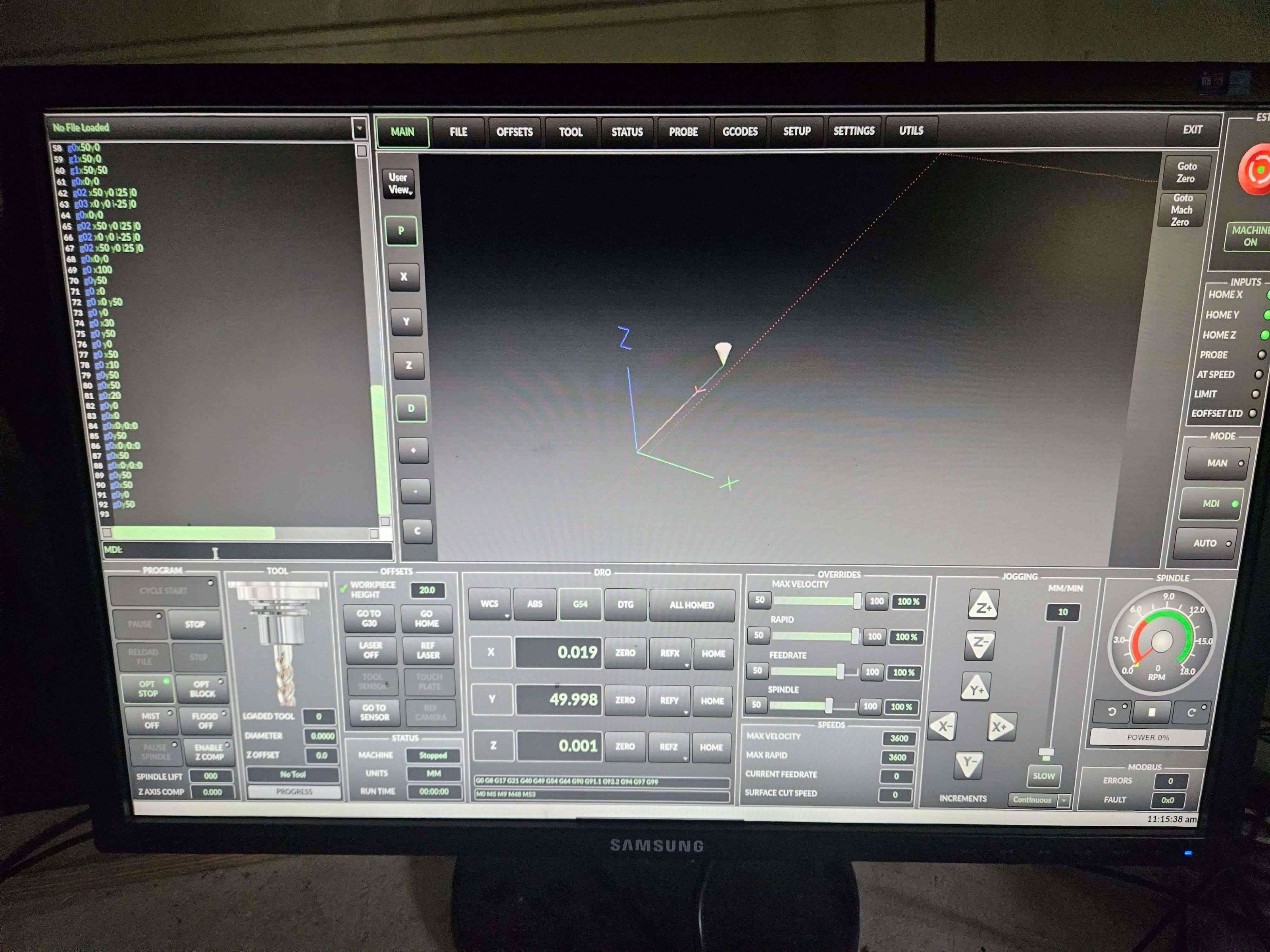

Other issue is with MDI. The machine oddly moves all three axis even when one axis  is commanded to move. Ill give you some examples:
(Using the YYXZ kinematics model)
1st move is G0 Y50: Machine moves as expected only on one axis
2nd move is G0 X50: Machine moves on Y and X axis
3rd move G0 Z20: Machine moves on all three axis
If I hit Esc in between the MDI commands it seems to move only one axis at the time for the first command I input. I bet this is some kind of mode I am not figuring out here. I think QtPlasmaC and some GRBL CNC controllers just moved the axis you typed to G commands and you could omit the other axis references from the line. As a note here that the machine moves indeed correctly if I always type in all the axis coordinates on all lines.
Any help would be golden here!

04 Oct 2023 04:17 #282240 by cmorley
I confirm the behavior on the latest 2.9.
I think the joint jogging code assumes X is always joint 0.
I'll look into it.
I'm curious why YYXZ is better then XYYZ ?
04 Oct 2023 05:24 #282248 by cmorley
I pushed a (hopeful) fix for this.
Not sure how long it takes to come out.
The following user(s) said Thank You: JiiPee
