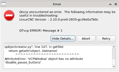

21 Feb 2024 11:35 #293905
by MarcoGaspar
Replied by MarcoGaspar on topic Tool images for qtdragon

21 Feb 2024 19:40 #293921
by MarkoPolo
Replied by MarkoPolo on topic Tool images for qtdragon
I received a similar error, but after reinstalling linuxcnc it started working properly.
Try this: "apt reinstall linuxcnc-uspace linuxcnc-uspace-dev"
Then replace these 3 files and it should work. I tested it several times.

21 Feb 2024 21:50 - 21 Feb 2024 22:05 #293930
by MarcoGaspar
Its the same.... tried fresh install linuxcnc iso and he same.... maybe i'm not putting the files on the correct place (i'm newbie with qtvcp scrrens)
can i give you my anydesk id so you can check?
This email address is being protected from spambots. You need JavaScript enabled to view it.
whatsapp +351 919324274

21 Feb 2024 23:41 #293936
by MarkoPolo
Does the normal, unmodified version run normally?
The files "qtdragon.ui" and "qtdragon_handler.py" should be placed in the directory "/usr/share/qtvcp/screens/qtdragon/"
The file "tool_offsetview.py" should be placed in "/usr/lib/python3/dist-packages/qtvcp/widgets/"
Try replacing just qtdragon_handler.py first to see if that causes an error.

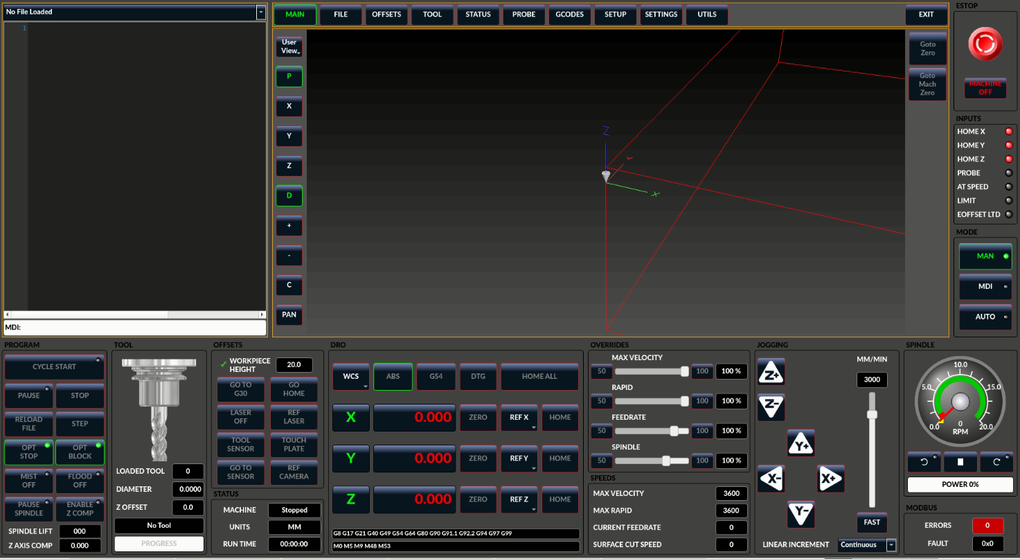

22 Feb 2024 10:08 #293967
by MarcoGaspar
- MarkoPolo
- Posts: 319
- Thank you received: 90
22 Feb 2024 12:38 #293976
by MarkoPolo
This is a modification of qtdragon. Qtdragon_hd is in a different directory. If you really want, I can also modify qtdragon_hd.
Meanwhile, run qtdragon (not qtdragon_hd) and check if this modification works.

22 Feb 2024 14:54 #293984
by MarcoGaspar
Hello,
Using qtdragon directory and your screen files i get this screen .
It's not full desktop and qtdragon_HD look
This is a modification of qtdragon. Qtdragon_hd is in a different directory. If you really want, I can also modify qtdragon_hd.Meanwhile, run qtdragon (not qtdragon_hd) and check if this modification works.Hello,Using the qtdragon directory and your files
Hello,
