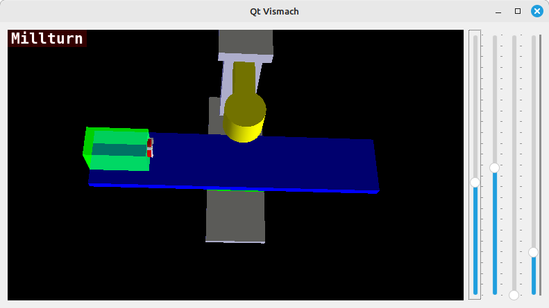

I did simulations of my xyza machine and I have a problem with the tool trace in the A axis. I would like the entire tool path to rotate around the A axis, which would result in drawing a milled solid.
Does anyone have a qtvismach file with a similar configuration as an example that would help me configure it properly?
The second problem is the transparency of the solid.
e.g. "solid = Color([1, 0.6, 0.6, 0.5],[solid])" I think the third parameter 0.5 should be the color opacity or transparency value, but it doesn't work.
Is it possible to make semi-transparent objects in qtvismach?
Marek

Replied by cmorley on topic qtvismach, a axis toolpath
I needed to modify primitives.py Color class for transparency:
class Color(Collection):
    def __init__(self, color, parts):
        self.color = color
        Collection.__init__(self, parts)
    def apply(self):
        GL.glPushAttrib(GL.GL_LIGHTING_BIT)
        GL.glMaterialfv(GL.GL_FRONT_AND_BACK, GL.GL_AMBIENT_AND_DIFFUSE, self.color)
        if self.color[3] < 1:
            GL.glEnable(GL.GL_BLEND)
            GL.glBlendColor(0, 0, 0, self.color[3])  # rgba
    def unapply(self):
        GL.glPopAttrib()
        GL.glDisable(GL.GL_BLEND)
The the alpha setting is honoured.

Replied by Aciera on topic qtvismach, a axis toolpath
If you mean the tool path to be drawn wrapped around a zylinder, this is currently not possible. All the logger, that is used to draw the toolpath history, does is collect collect coordinate values. It has no concept of a rotational center at all.

I modified the primitives.py file, but it didn't change anything, there is no transparency. I tested on various configurations. Is there anything else that needs to be modified?
As for the tool trace, the lathe configuration does not change anything either.
In this video you can see that the tool path rotates around the C axis, so I think it can be done.
well aside from setting the color opacity of the part like you showed, but the opacity is  1.0 most clear - 0 solid.
that does seem back wards so you could change the code a bit to do the opposite.:
            GL.glBlendColor(0, 0, 0, 1 - self.color[3])  # rgba
You can see the A axis spindle is see through.

Yes, I thought you wanted a straight line to wrap around a cylinder (ie a synchronized AX move to be shown as a helix).
What you want is quite standard, you just need to attach 'work' to your rotary table.
This is an example from '/src/hal/user_comps/vismach/xyzac-trt-gui.py'
work = Capture()
ctable = Collection([
         work,
         CylinderZ(-18, 50, 0, 50),
         # cross
         Color([1,1,1,0], [CylinderX(-50,1,50,1)]),
         Color([1,1,1,0], [CylinderY(-50,1,50,1)]),
         # lump on one side
         Color([1,1,1,0], [Box(42, -4, -20, 51, 4, 5)])
ctable = HalRotate([ctable],c,"rotate-c",1,0,0,1)
Examples can be found in all the vismach models with work side rotation (eg xyzac-trt-gui.py, xyzbc-trt-gui-py, xyzab-tdr-gui-py)

As for open glTransparency:
As cmorley said, the alpha channel is broken and you have to use 'BLEND' and affiliated functions. I find it terribly confusing and I usually end having it where I did not want it.
To check if it works on your system you could just start the 'axis' simulation config and home the machine, Then look at the tool cone (which should be transparent):
I know it's not in vismach or qt but it's all opengl in the background:
