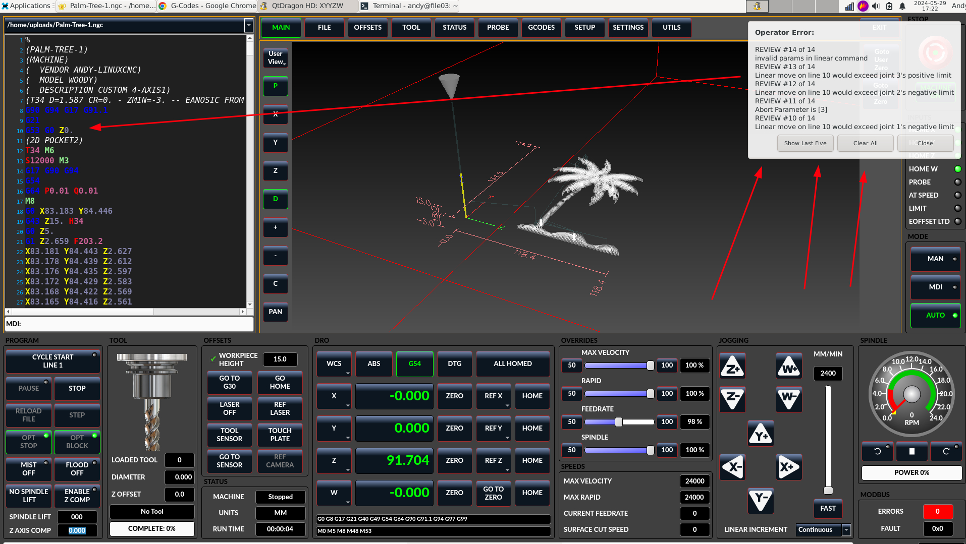

29 May 2024 17:33 #301781
by gardenweazel
Replied by gardenweazel on topic Simplest install of QTDragon from Axis
- Posts: 7368
- Thank you received: 2181
29 May 2024 20:02 #301787
Replied by cmorley on topic Simplest install of QTDragon from Axis
If any of the motion commands move outside the red boundary box, you will get this error.
Hard to tell from this angle. Is g53 z0 inside the machine limits?
A G53 line will use the machine coordinates rather then the user (G5x) coordinates for the commanded move.

29 May 2024 21:35 #301803
by gardenweazel
I just ran the exact same file in Axis with no issues.
Additionally, I commented that line out, ran it from QTDragon and it still gave me the same error.
- Posts: 7368
29 May 2024 22:08 #301808
The fact it runs in AXIS means the program is ok - that's good.
If the user system is not set quite right it won't run in AXIS or QtDragon.
Are any of the plot lines outside the red boundary box? This includes rapid points.
Does the machine move at all? i wonder it it's actually the tool change.
Sometimes linuxcnc lies about what number the problem line is.
Chris
Chris
