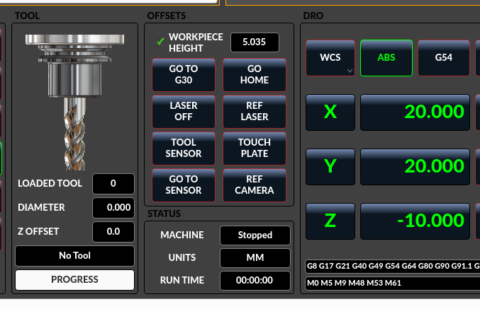

Replied by vre on topic Help,How to customize language of QtDragon's interface
I have returned back to 2.9.4 but i will try again master.
In qtdragon_hd i can't find touch plate z axis probing.
This exists in qtdragon but can't find it to hd version.
Is somewhere hidden?
- Posts: 7368
- Thank you received: 2181
04 Apr 2025 18:44 - 05 Apr 2025 01:52 #325703
Replied by cmorley on topic Help,How to customize language of QtDragon's interface
It's in a library file. qt_action.py
github.com/LinuxCNC/linuxcnc/blob/2.9/li...cp/qt_action.py#L754
Last edit: 05 Apr 2025 01:52 by cmorley. Reason: Add the actual linenumber

05 Apr 2025 02:50 #325733
by vre
I mean this where is in qtdragon_hd gui
linuxcnc.org/docs/html/gui/qtdragon.html#_touch_plate

09 Apr 2025 07:50 #325969
by vre
search_vel, probe_vel, max_probe, z_offset, retract_distance, z_safe_travel, rtn_method
In this function where in the GUI can set the parametersIt's in a library file. qt_action.py
- Posts: 7368
10 Apr 2025 03:54 #326014
This is the call that starts the touch probe routine with those settings.
Here is the actual probing program code.
github.com/LinuxCNC/linuxcnc/blob/2.9/li...f_subprogram.py#L179

13 Apr 2025 17:23 #326226
by vre
Where can set the probing parameters for this ?
