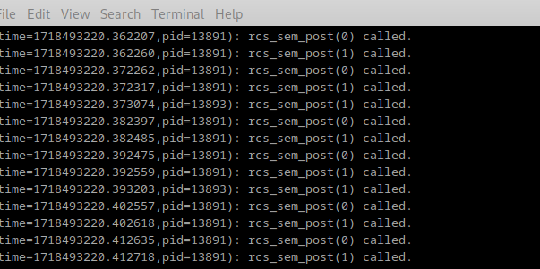

Well, haven't worked with the mill for a while, but back at it. Have some parts to make for cash.
I updated to the latest .deb on buildbot2: linuxcnc-uspace_2.10.0~pre0.3238.g28fc559dc4_amd64.deb
Ok, works fine. I use a simple .bat file to copy a few files: .ui, .qrc, .qrs, and the handler.
Been working file for a several previous updates.
This time I'm getting a very weird error.
I run from a cmd window, so I can see what's going on.
Now, it's getting stream of messages in the cmd window. See the image.
What the heck is that all about?
This is the message: (time=1718493234.121713,pid=13891): rcs_sem_post(0) called
It just streams, fast.
Linuxcnc and QtDragon seem to be functioning ok.
I copied out the cmd window, trimming a very series of messages. see the txt file
Also, here is my .ini file.
So, what's going on? how can I get rid of this messaging????

Pid number might let you look up what is printing the message. I don't recognize it.

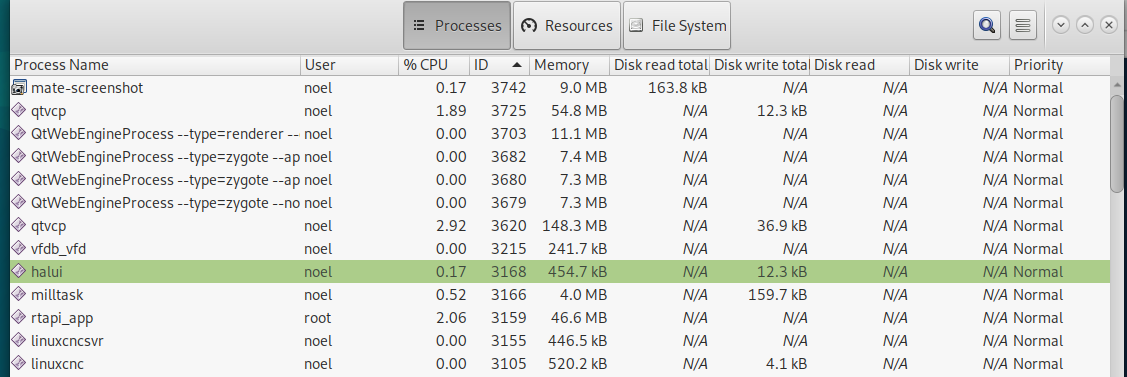

I think System info can show you running pid processes

Also try setting DEBUG in INI to zero

Chris.
thanks. I thought about changing the debut in the .ini, but that would only hide the problem.
I'll see if I can find the pid in system info. not sure how to do that but I'll look into it.

ok, found the processes....
it's bounding between halui and milltask.
see the image and the file..
So, what's up????
UPDATE
In reading the DEBUG doc, I set
So, what's up????
UPDATE
RCS_DEBUG = 0, and the streaming stopped.....Attachments:
