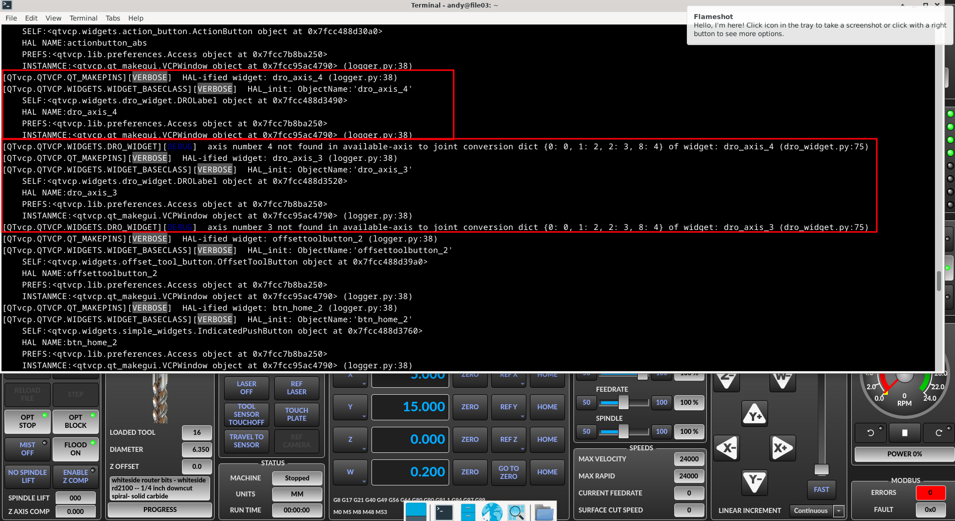

Something seems off in the code for this widget. I've highlighted the two lines below and looked at the code briefly.
My setup is XYYZW. The code is placing "8:4" into the dict.
I believe that line 73 may be where the error is occurring:
self._jointNum = INFO.GET_JOINT_NUM_FROM_AXIS_INDEX.get(self.joint_number)
<QTvcp QTVCP QT_MAKEPINS><VERBOSE> HAL-ified widget: dro_axis_4 (logger py:38)
<QTvcp QTVCP WIDGETS WIDGET_BASECLASS><VERBOSE> HAL_init: ObjectName:'dro_axis_4'
SELF:<qtvcp widgets dro_widget DROLabel object at 0x7fe5f22b7490>
HAL NAME:dro_axis_4
PREFS:<qtvcp lib preferences Access object at 0x7fe6289fab90>
INSTANMCE:<qtvcp qt_makegui VCPWindow object at 0x7fe62abc0790> (logger py:38)
<QTvcp QTVCP WIDGETS DRO_WIDGET><DEBUG> axis number 4 not found in available-axis to joint conversion dict {0: 0, 1: 2, 2: 3, 8: 4} of widget: dro_axis_4 (dro_widget py:75)

I believe that the axis numbers are coming from the INI file which seems correct to me:
Here's what I have set:
<DISPLAY>
GEOMETRY = xyzw
<KINS> JOINTS = 5
KINEMATICS = trivkins coordinates=XYYZW kinstype=BOTH
<TRAJ> COORDINATES = X Y Y Z W
<AXIS_X>
<JOINT_0>
<AXIS_Y>
<JOINT_1>
<JOINT_2>
<AXIS_Z>
<JOINT_3>
<AXIS_W>
<JOINT_4> Please Log in or Create an account to join the conversation.

Adding a screenshot which may help.

Replied by cmorley on topic Axis not found
These messages are red herrings.
These DROs are initialized with axis guesses then later Qtdragon sets them correctly.
The debug messages comes from wrong guesses. It's expected.
You can confirm the axis display by looking at linuxcnc status - it will show axis absolute position and joint position.
The DRO will not affect your motors.
Chris
Chris
The following user(s) said Thank You: gardenweazel

11 Jul 2024 14:45 #304919
by gardenweazel
Replied by gardenweazel on topic Axis not found
Thanks Chris.
Rather odd but, then I do have debug running so expected.
Appreciate the feedback.
