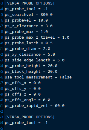

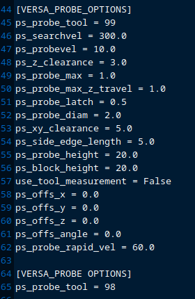

20 Jul 2024 20:47 #305723
by Roguish
Replied by Roguish on topic Spindle Inhibit while Probing.....
Chris,
it's there. I built from latest source on 7/19.
just ran the qtdragon_xyz sim. changed the probe to versa_probe in the .ini
below is an image of the .pref file.
Interesting it has both the misspell and the correct spell.

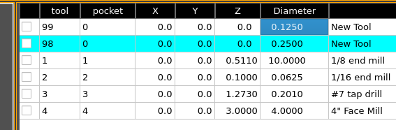

I added a tool 99 and a tool 98. and set the
I manually changed tool with the M61Qn button twice. once for each tool, 98 and 99.

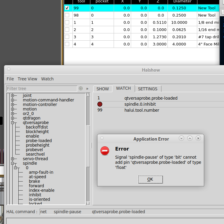

Did a manual spindle forward and it appeared to spin. At least no notice or warning and it
so, checked a bunch more through hal_show.. it's using the correct spelled pref section name probe number...good.
when are the qtversaprobe hal pins formed???
seems to have other issues. see the last image of the hal_show....
