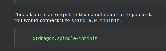

Chris. appologies for bring this up again.
I have notices a pin named 'qtversaprobe.enable'
what is it? and where does it come from?
it is an output of something......

22 Oct 2024 18:37 #312888
Replied by Aciera on topic Spindle Inhibit while Probing.....
The following user(s) said Thank You: Roguish

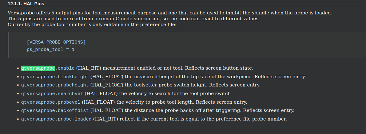

23 Oct 2024 17:07 #312984
by Roguish
Replied by Roguish on topic Spindle Inhibit while Probing.....
thanks for the reference. I had not noticed that.
BUT, I have tested probing, and qtversaprobe.enable never comes on.
and qtdragon.spindle-inhibit does not come on either.
I have some hal set up to inhibit the spindle when the probe is loaded. Neither .enable or .spindle-inhibit are used. they are both outputs.
Outputs of what?????? that's what I would like to know,
fyi. I am using a deb from Seb's buildbot2 for bookworm/master. about a week old.
- Posts: 4819
- Thank you received: 2176
23 Oct 2024 18:42 #312992
Probably what the docs say, you would connect .spindle-inhibit in hal to.:
.enable reflects the screen button state.
spindle.0.inhibit.enable reflects the screen button state.
- Posts: 7368
- Thank you received: 2181
24 Oct 2024 03:19 #313023
Replied by cmorley on topic Spindle Inhibit while Probing.....
To add a liyttle more detail:
-> qtversaprobe.enable
reflects the state of the 'measure tool' button on the versa probe screen.
This is a manual selection button (to ignore auto probing)
It doesn't do anything unless the remap code utilizes it such as:
-> qtversaprobe.probe-loaded
true when the tool number equals the preference files entry:
ps_probe_tool = 1
It doesn't do anything unless connected to other logic such as spindle.0.inhibit.
If you have multiple signals to connect to spindle.0.inhibit, then you must use an OR logic component.
o300 if [#<_hal[qtversaprobe.enable]> EQ 0]
(MSG, Auto Tool probe disabled )
G43 ;turn back on tool offset mode before returning
o300 return [3] ; indicate no tool measurement
o300 endif-> qtversaprobe.probe-loaded
ps_probe_tool = 1
