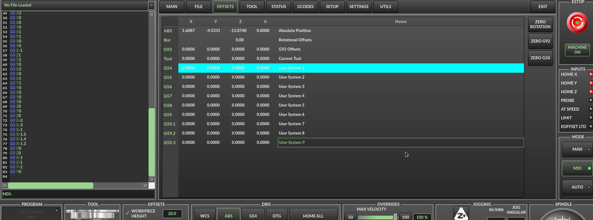

I am having an odd issue with the qtdragon_hd UI MDI. Doing a rapid on one axis causes one of the other axes to move. But it's only the axis that I've commanded previously. In the video example, I never sent commands to the Z axis so it didn't move here. I'm not sure what could be causing it. It is also changing the DRO, so it is sending the commands to both axes for some reason.
I tested in AXIS and it wasn't an issue, so it must be something to do with qtdragon. Is it possible the default gcodes are causing it in some way? The only one I can think of that is active is G99 but I don't know if that would be capable of causing this issue.

Can you check on the offsets tab if there is any rotational offset?

by Trevy3
Replied by Trevy3 on topic Weird Multi Axis MDI Issue in QTDragon_HD
- Trevy3
- Posts: 21
08 Sep 2024 13:13 #309690
by Trevy3
I have also just tested this in the default qtdragon_hd_xyza sim setup and it does the same thing there.
