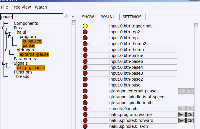

Hi all
I am trying to setup a USB (DragonRase) pendant to do various functions on my test cnc.
When using the UI this is what happens
Start the machine to the point where it begins cutting.
Press the "pause" button. The spindle raises up & stops spinning.
Press the "pause spindle" button. Spindle starts up. Press OK in the dialog box.
Spindle lowers & program resumes.
Great
I have connected my USB to the pause button with the following line
net ext_prg_pause <= qtdragon.external-pause <= input.0.btn-top
When I press the button the spindle raises & stops.
If I press it again the spindle stays paused & the machine starts doing air cuts.
My question is... is there a hal pin for the "pause spindle" button to start the sequence correctly?
I'm using Debian 12
LINUXCNC - 2.9.2-168-ge7cd5217d9
QTDragon (not HD)
Alex

I did set this up by loading Debian & then adding linuxcnc as deb files but that is the version as listed....
And attached is a pic of the pause buttons.
I am happy to format the computer & setup again from scratch if that is going to give me an answer.
If you can give me a recommendation I'm happy to try.
Alex

- Posts: 7368
- Thank you received: 2181
24 Sep 2024 00:57 #310678
Replied by cmorley on topic pause spindle using USB pendant
Well I don't know why it says 2.9.2 and has the external-pause pin but lets put that aside for the moment.
The external-pause pin expects to be set high to pause and low to unpause.
Does your pin drive it like so or is it momentary high to pause and a momentary high to unpause?
Chris
Chris

24 Sep 2024 08:08 #310693
by frayja2002
Replied by frayja2002 on topic pause spindle using USB pendant
qtdragon.external-pause is momentary.... This causes qtdragon.spindle-inhibit & spindle.0.inhibit to go high.
If I press the button again the spindle does not restart & the spindle does not lower into the work piece. It just makes air cuts with the spindle paused.
However if I press the spindle paused button (next to reload on the ui) the spindle starts up. I get the dialog box & the spindle lowers to the correct height to continue the program.
I need to find a HAL pin for that spindle paused button.
Alex
