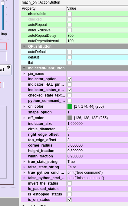

Thanks for your answer. I want to use a Push Button (action_button) with an led indicator, yes. But the led should follow a LinuxCNC status such as 'machine_on' e.g., not a HAL pin status. I have attached a designer screenshot of the property settings.

The last update step obviously turns the led off again after it was set on by the _flip_state function. So I prevented the _update function in indicatorMixIn.py from calling the indicator_update function (the code change in blue color). Thus, the led remains in true-state according to the current machine state.
def _update(state):
print(f"** _update from connected press/release signals {self.objectName()} state={state}")
self.setChecked(state)
if self._HAL_pin is False and self._ind_status is False:
self.indicator_update(state)
Don't know whether it could cause unwanted side effects. As far as I could see it works in my context.

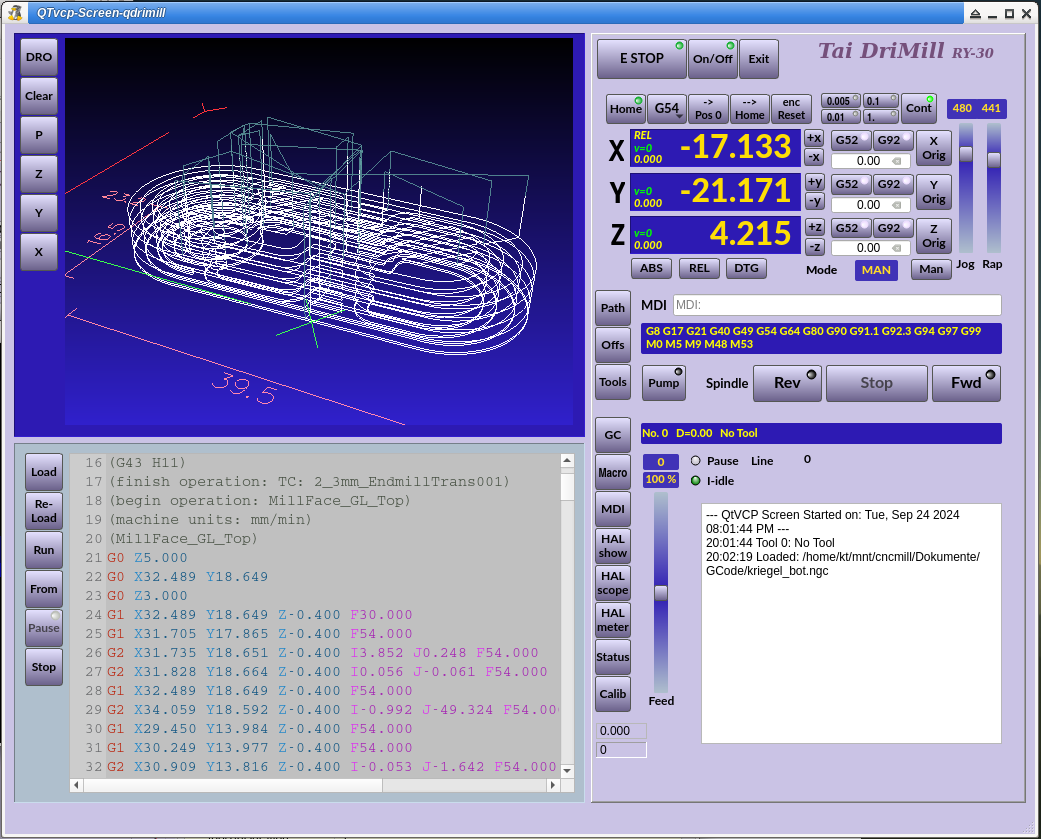

Could you show an image of your custom screen? I'm happy that Qtvcp was flexible and documented enough to convince you to try something unique.

Ok, fine! Sure I can. But it's a very light weight implementation. Only those features I need for my use case are implemented. Actually, most time I use the macrotab feature, even more than applying G-code (from FreeCAD).
Yes, I'm also happy that I tried to apply Qtvcp. It fits perfectly my needs and I was amazed how little code I had to write in my handler file.

Looks nice, clean and uncomplicated! Thanks for showing it.
