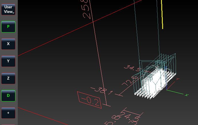

Hello, everyone! I'm writing here so as not to clutter up the forum with unnecessary topics.
I can't seem to properly configure the display of the rotation axis on QtDragon.
I tried setting GEOMETRY=AXYZ and GEOMETRY=!AXYZ, and I changed both TRAJ and KINS, but the rotation axis is still not displayed. For example, in this code there are 4 rotations of the A axis, but it draws like this

- Posts: 6803
- Thank you received: 2181
11 months 3 weeks ago #337932
Replied by cmorley on topic Rotary axis in Qtdragon_hd
Can you post your config files?
- deltafox24
- Posts: 13
11 months 3 weeks ago - 11 months 3 weeks ago #337941
by deltafox24
Replied by deltafox24 on topic Rotary axis in Qtdragon_hd
Yes, of course, here it is.
I removed it from there.
GEOMETRY = AXYZ
from there because it doesn't work for me anyway.
