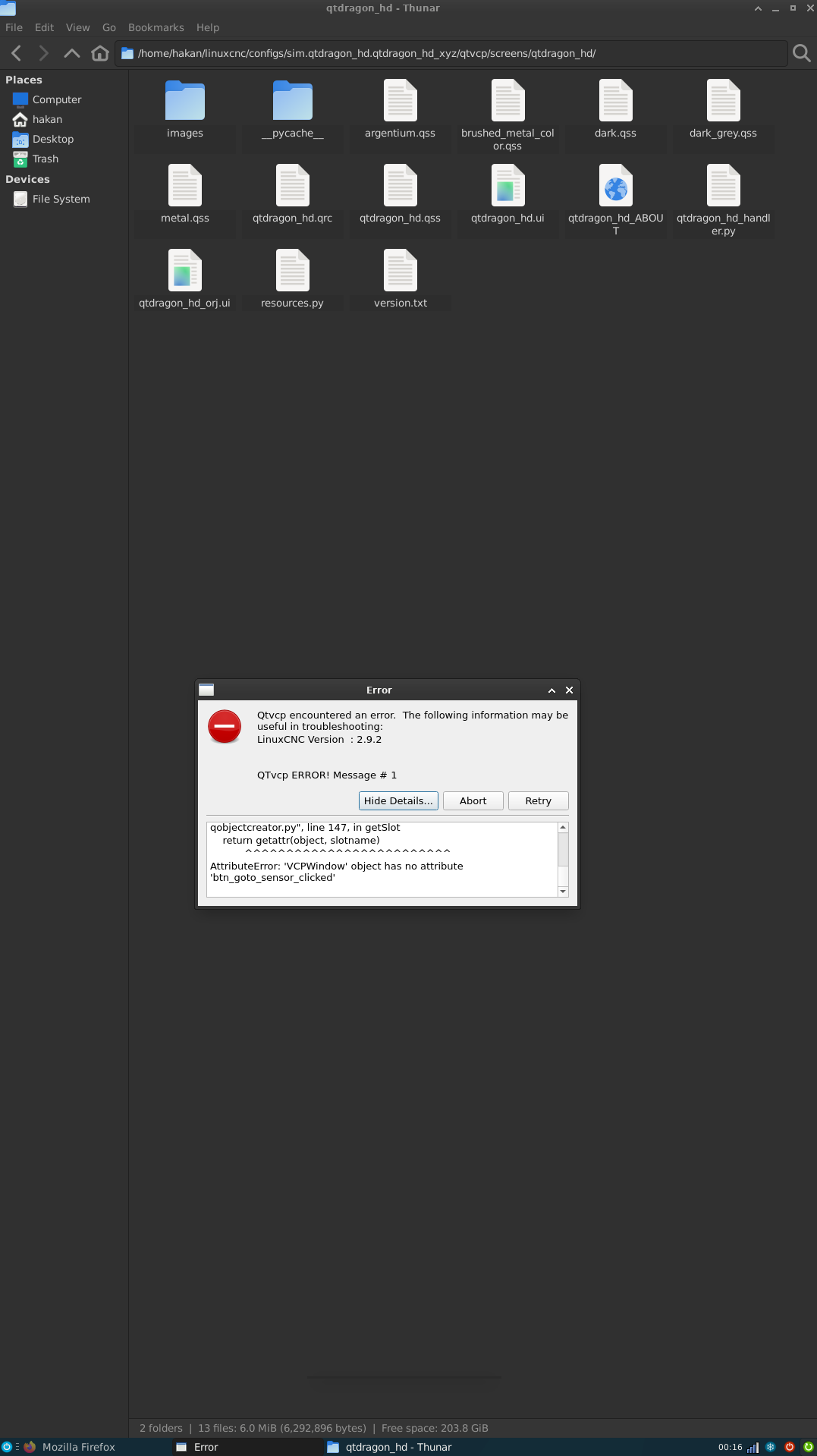

while loading horizontal qtdragon_hd it says version 2.9.2 and attached is the error when i change the .ui file with vertical
Error report created by /usr/lib/tcltk/linuxcnc/show_errors.tcl:

[QTvcp.QTVCP.QT_ISTAT][[33mWARNING[0m] Missing [DISPLAY] ANGULAR_INCREMENTS- using defaults. (qt_istat.py:317)
[QTvcp.QTVCP.QT_MAKEGUI][[41mCRITICAL[0m] 'VCPWindow' object has no attribute 'btn_goto_sensor_clicked' (qt_makegui.py:212)
[QTvcp][[41mCRITICAL[0m] Retry from Error Dialog
Qtvcp encountered an error. The following information may be useful in troubleshooting:
LinuxCNC Version : 2.9.2

AttributeError: 'VCPWindow' object has no attribute 'btn_goto_sensor_clicked'

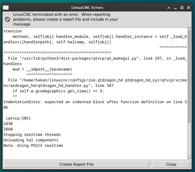

tcl: 8.6
tk: 8.6
glade: not_in_PATH
linuxcnc_var all:
LINUXCNCVERSION: 2.9.2
LINUXCNC_AUX_GLADEVCP: /usr/share/linuxcnc/aux_gladevcp
LINUXCNC_AUX_EXAMPLES: /usr/share/linuxcnc/aux_examples
REALTIME: /usr/lib/linuxcnc/realtime
RTS: uspace
HALLIB_DIR: /usr/share/linuxcnc/hallib
PYTHON: /usr/bin/python3

04 Mar 2025 06:35 #323125
Replied by cmorley on topic How to open QT ui file in LinuxCNC

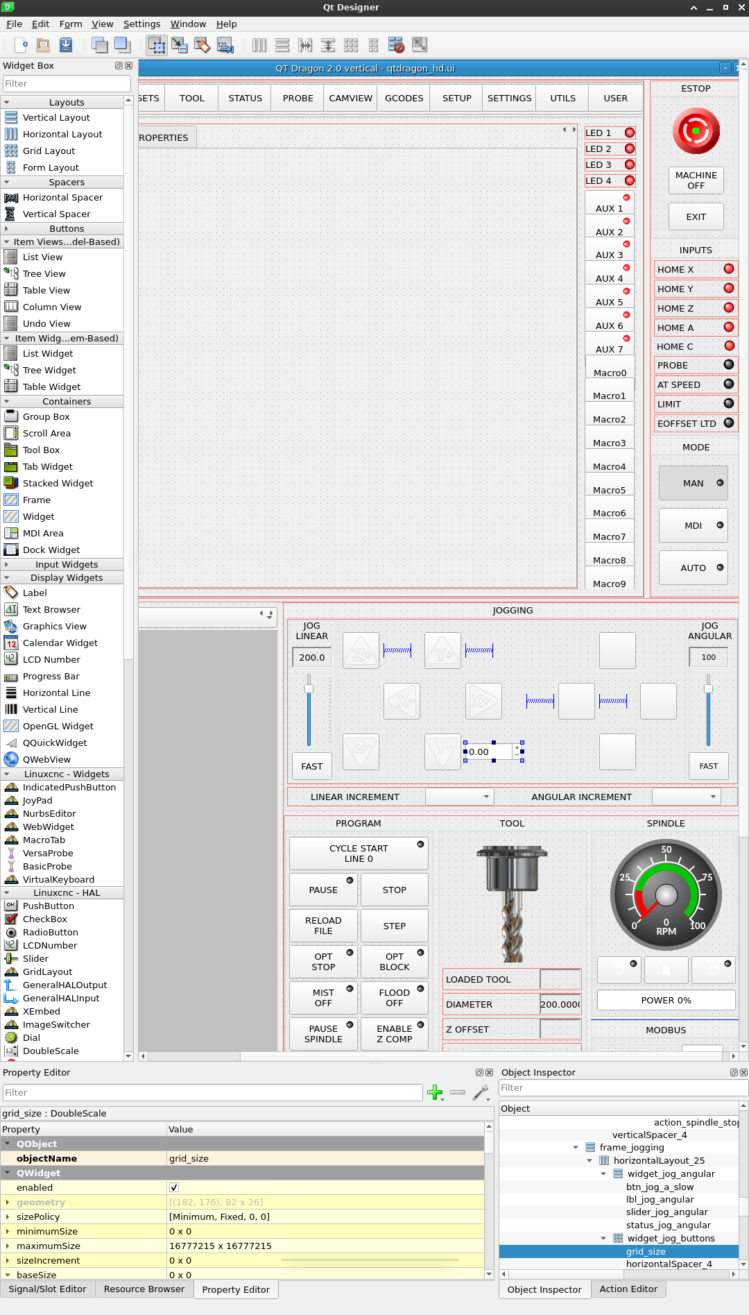

Try this version for 2.9.
name it qtdragon_hd.ui
put it in YOUR CONFIG FOLDER/qtvcp/screens/qtdragon_hd/
Chris
Chris
- hakinen2255
- Posts: 13
04 Mar 2025 14:45 #323144
by hakinen2255
Replied by hakinen2255 on topic How to open QT ui file in LinuxCNC
Hi Chris,
yes that worked and it loaded the screen, thanks.

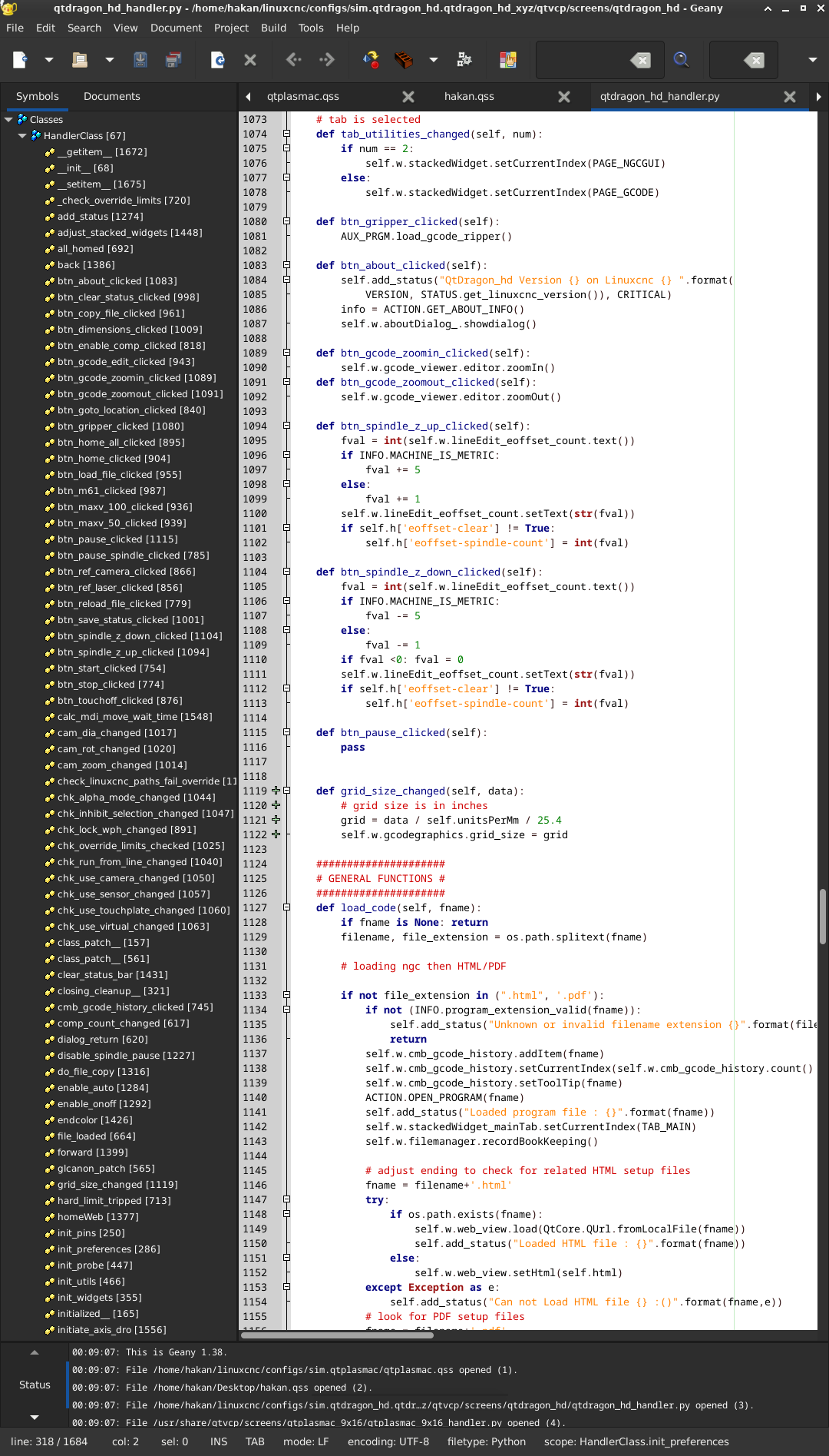

- hakinen2255
- Posts: 13
25 Apr 2025 20:20 #327056
by hakinen2255
Hi Chris,

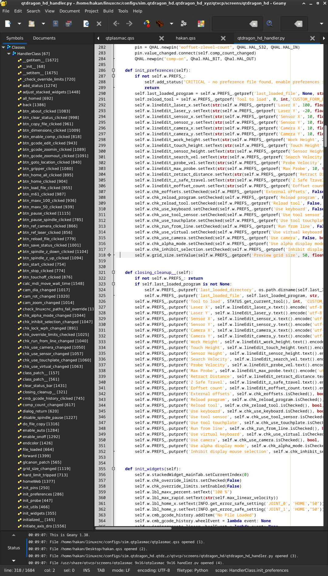

I am trying to add a grid to the 3d graphics before i start with adding a 3d model of the machine, same grid with the qtplasmac, i checked its code and added the lines(i think that its related with drawing a grid in the viewport) to the qtdragon_hd_handler.py(lines with the + signs next to line numbers in the attached screenshots) but i can not see a grid in the viewport. as u know i dont know the programming language i am just copying and pasting, i also added a doublescale box in qt designer, i can see the grid size as 50 in startup as i entered in the code but there is no grid still in 3d graphics.
have u tried adding a grid to 3d graphics before or do u know how to do it? Thanks in advance.
Hakan
Hakan

- Posts: 7368
- Thank you received: 2181
26 Apr 2025 21:10 #327102

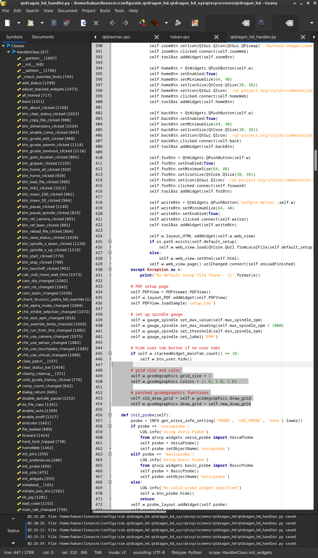

Sorry for cryptic message - I am away from home for work.
I did not know that QtPlasmac was patched to show a grid in P view - those plasma guys are very crafty!
I also didn't realize QtDragon had no builtin way to show grids
(I assume your gcode graphics widget is called gcodegraphics in designer)
To get XYZ grids to show you must set a grid size:
self.w.gcodegraphics.grid_size = 1
setting the grid color is possible (Red,green,blue):
self.w.gcodegraphics.colors = (1.0, 1.0, 1.0)
add those to bottom of init_widgets() function.
to get grid in perspective too require patching.

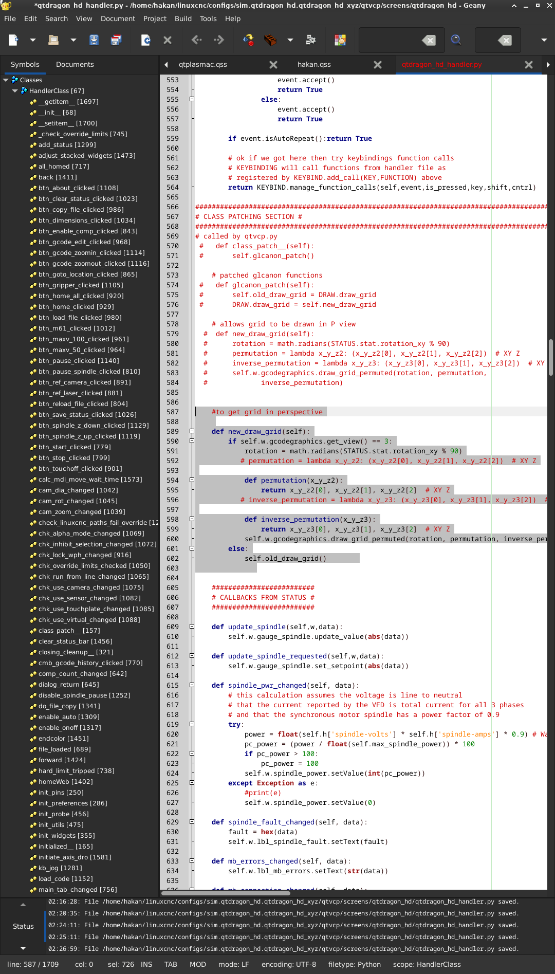

add to bottom of init_widgets() function:I think I should modify the underlaying code so the patching is not necessary - on the todo list.
def new_draw_grid(self):
if self.w.gcodegraphics.get_view() == 3:
rotation = math.radians(STATUS.stat.rotation_xy % 90)
# permutation = lambda x_y_z2: (x_y_z2[0], x_y_z2[1], x_y_z2[2]) # XY Z
def permutation(x_y_z2):
return x_y_z2[0], x_y_z2[1], x_y_z2[2] # XY Z
# inverse_permutation = lambda x_y_z3: (x_y_z3[0], x_y_z3[1], x_y_z3[2]) # XY Z
def inverse_permutation(x_y_z3):
return x_y_z3[0], x_y_z3[1], x_y_z3[2] # XY Z
self.w.gcodegraphics.draw_grid_permuted(rotation, permutation, inverse_permutation)
else:
self.old_draw_grid()add to bottom of init_widgets() function:
# patched gcodegraphics functions
self.old_draw_grid = self.w.gcodegraphics.draw_grid
self.w.gcodegraphics.draw_grid = self.new_draw_grid
The following user(s) said Thank You: tommylight, snowgoer540

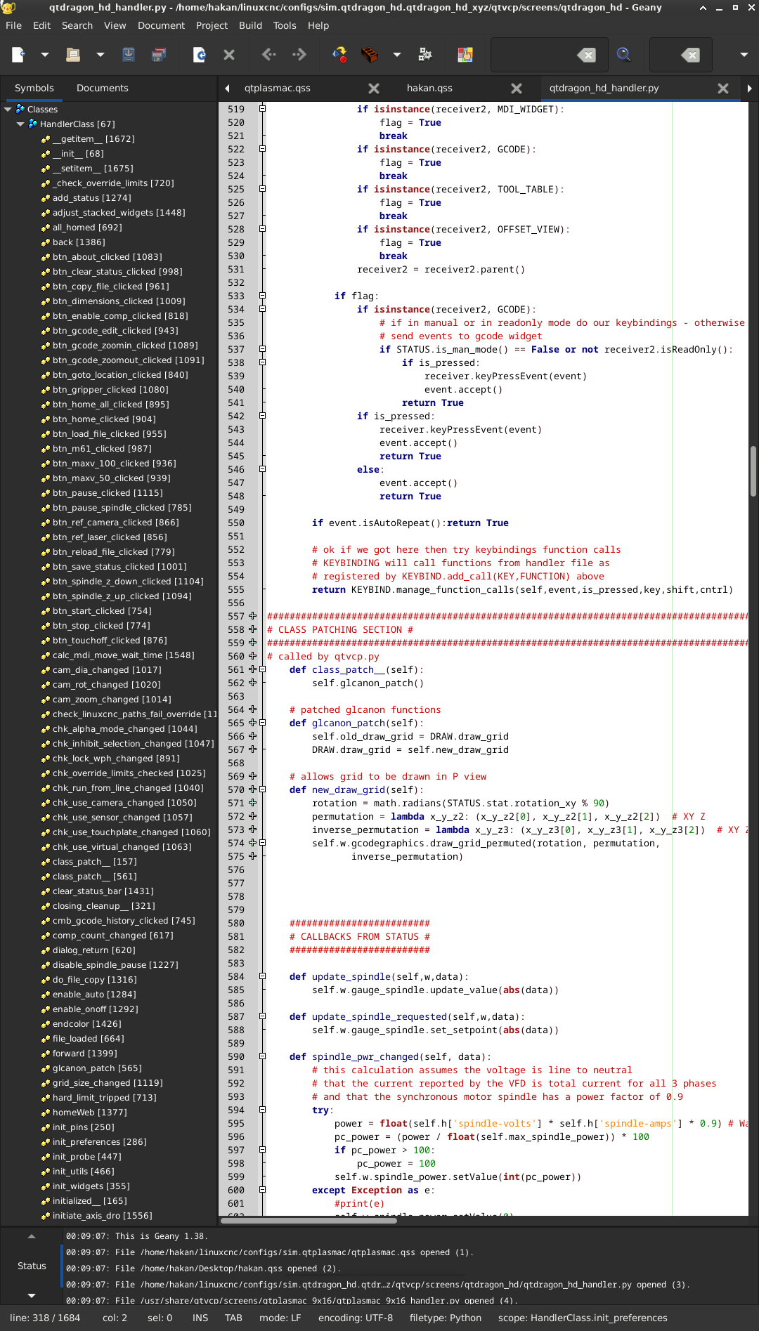

26 Apr 2025 22:26 #327107
by hakinen2255
Thanks for the detailed reply Chris,
I disabled all the lines i added to the code and added some of your code under init_widgets() function and put the rest where other functions or patches are defined, when i run the linuxCNC i got the attached error, did i miss something?
