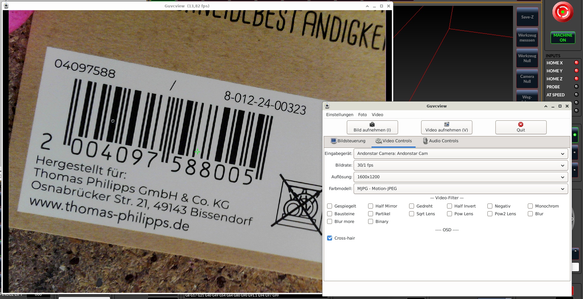

06 Oct 2025 15:11 - 06 Oct 2025 15:30 #335922
by wusel0464
Replied by wusel0464 on topic Change camera resolution Qtdragon?
Hello,
Thank you for your effort and patience.
I didn't expect it to be so easy either.
I searched the code on the net to try whether it could work with the camera before I gave any nonsense.
I just let the whole thing run in studio code.
Since I hardly have any idea from programming, I was glad to have something to run at all.
My thought was that you could do something like that in the scaling function and to simply make it handlebar via the qtdragon.pref.
What Qtdragon shows, I noticed when comparing the image with other programs and even if you use the zoom function, the image becomes pixelated very quickly.
Various Linux tools first read only 640x480 as a kind of standard.
v4L2-ctl --list format-ext shows the following resolutions:
640x480
352x288
320x240
176x144
160x120
800x600
1280x960
1600x1200
When I start GuvcView, the camera is first displayed 640x480, it can then select and the image quality changes.
Small addendum, you can see it even better:
Qtvcp -d -o Cam number = 14 cam_align
Two cameras are just connected here:
Port 1 Andostar
[QTvcp.QTVCP.WIDGETS.CAMVIEW_WIDGET][DEBUG] Port 1 is working and reads images (480.0 x 640.0) (camview_widget.py:520)
Port3 webcam
[QTvcp.QTVCP.WIDGETS.CAMVIEW_WIDGET][DEBUG] Port 3 is working and reads images (480.0 x 640.0) (camview_widget.py:520)
Thank you for your efforts and all the best, Frank.

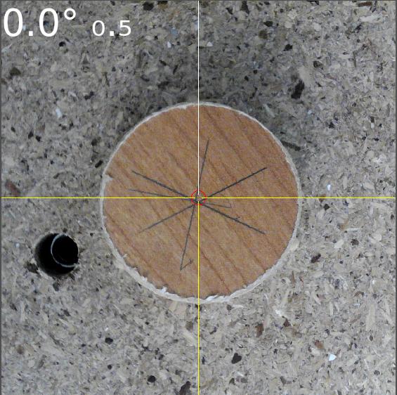

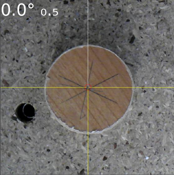

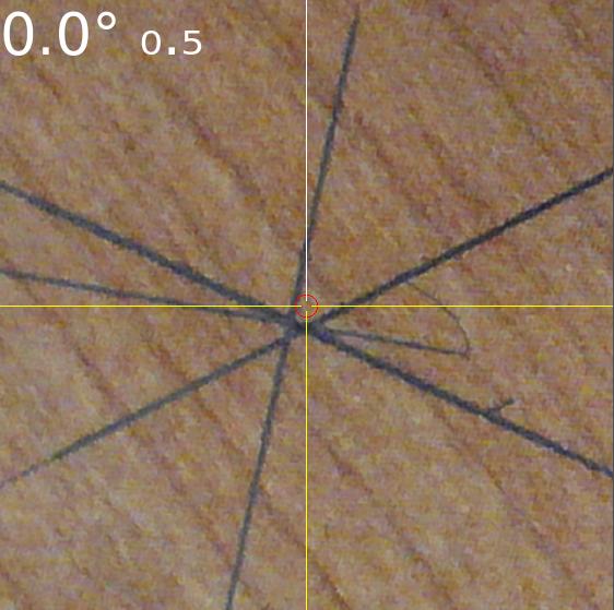

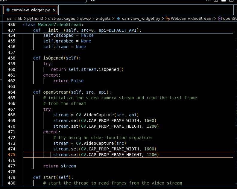

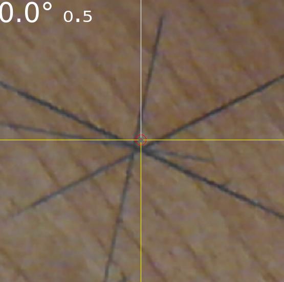

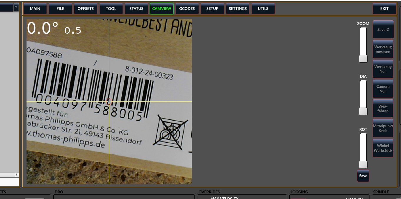

07 Oct 2025 15:39 #336019
by wusel0464
Hello,
Apparently I found the right place in the code, at least the image quality changes.
Enclosed the pictures I have reached, maybe you can use or expand it in the future.
Thanks to everyone and best regards, Frank
