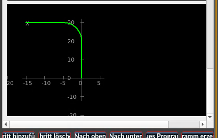

22 Dec 2025 21:58 - 22 Dec 2025 22:01 #340401
by aDm1N
Replied by aDm1N on topic LatheEasyStep – experimental QtVCP macro for step-by-step lathe programming
So, it seems I've managed to get the contour pretty well right. It's coming along slowly. It took me quite a while to get it to this point.
"op_type": "contour",
"params": {
"start_x": 0.0,
"start_z": 0.0,
"coord_mode": 0.0,
"segments": [
"mode": "xz",
"x": 15.0,
"z": 0.0,
"x_empty": false,
"z_empty": false,
"edge": "radius",
"edge_size": 5.0,
"arc_side": "auto",
"arc_side_raw": ""
"mode": "xz",
"x": 15.0,
"z": -15.0,
"x_empty": false,
"z_empty": false,
"edge": "none",
"edge_size": 0.0,
"arc_side": "auto",
"arc_side_raw": ""
"name": "radius"
"primitives": [
"type": "line",
"p1": [
0.0,
0.0
"p2": [
10.0,
0.0
"type": "arc",
"p1": [
10.0,
0.0
"p2": [
15.0,
-4.999999999999999
"c": [
10.0,
-5.0
"ccw": false
"type": "line",
"p1": [
15.0,
-4.999999999999999
"p2": [
15.0,
-15.0

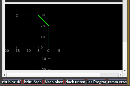

"params": {
"start_x": 0.0,
"start_z": 0.0,
"coord_mode": 0.0,
"segments": [
"mode": "xz",
"x": 15.0,
"z": 0.0,
"x_empty": false,
"z_empty": false,
"edge": "chamfer",
"edge_size": 5.0,
"arc_side": "auto",
"arc_side_raw": ""
"mode": "xz",
"x": 15.0,
"z": -15.0,
"x_empty": false,
"z_empty": false,
"edge": "none",
"edge_size": 0.0,
"arc_side": "auto",
"arc_side_raw": ""
"name": "Fase"
"primitives": [
"type": "line",
"p1": [
0.0,
0.0
"p2": [
10.0,
0.0
"type": "line",
"p1": [
10.0,
0.0
"p2": [
15.0,
-5.0
"type": "line",
"p1": [
15.0,
-5.0
"p2": [
15.0,
-15.0
Last edit: 22 Dec 2025 22:01 by aDm1N.
