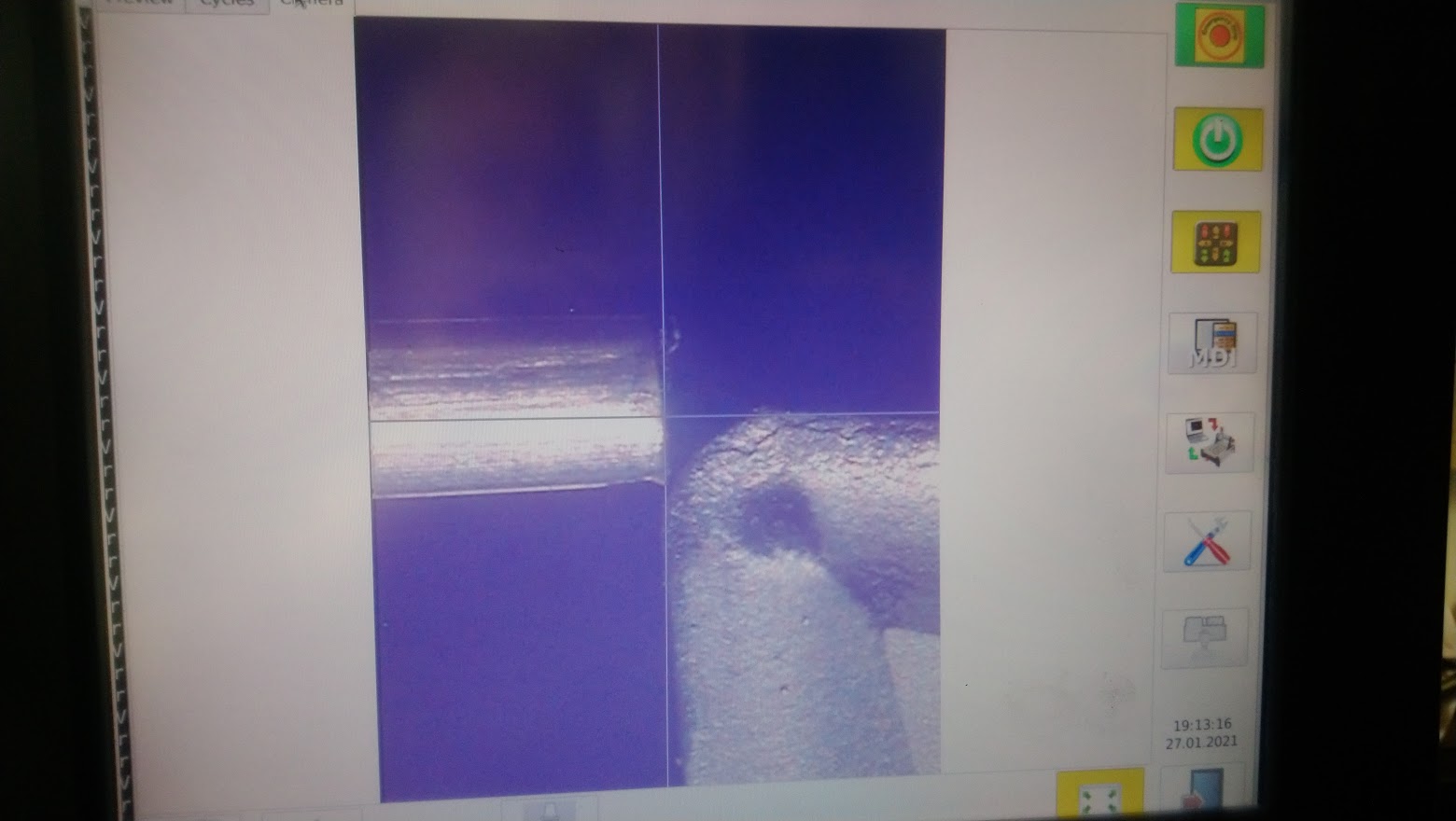

I am using Gmoccapy and have video in tab.

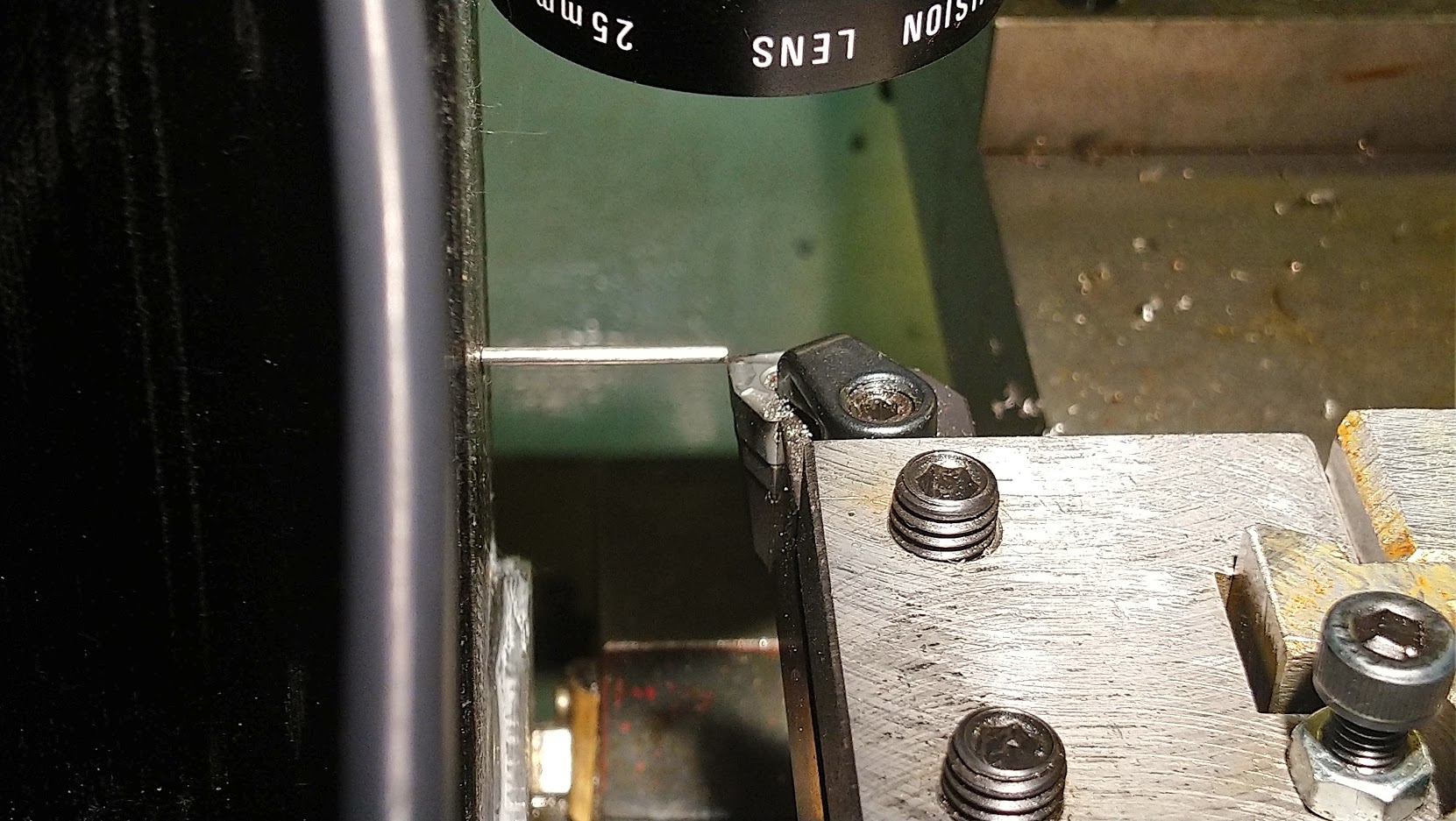

Above you can see a 1.6mm TIG welding rod centered in the view, this is for setting up the camera and verify position that is very close to X0. Only as a visual aid as all tools will be zeroed to the cross. Pretty high magnification to do this.
View from operators side with lathe tool.
