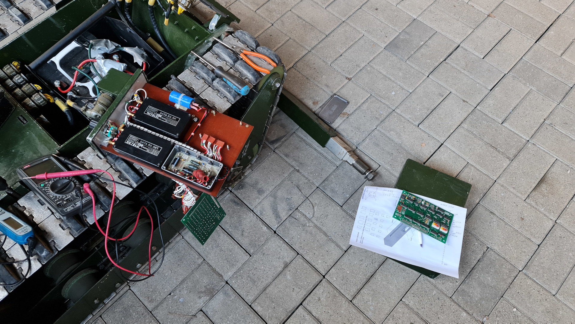

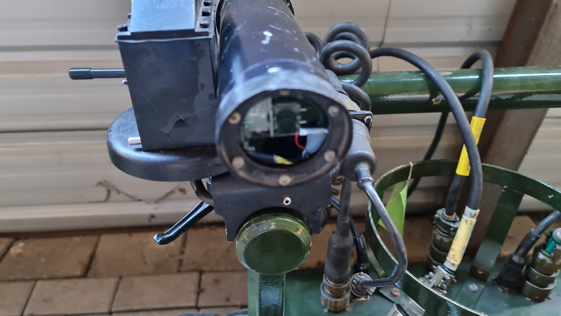

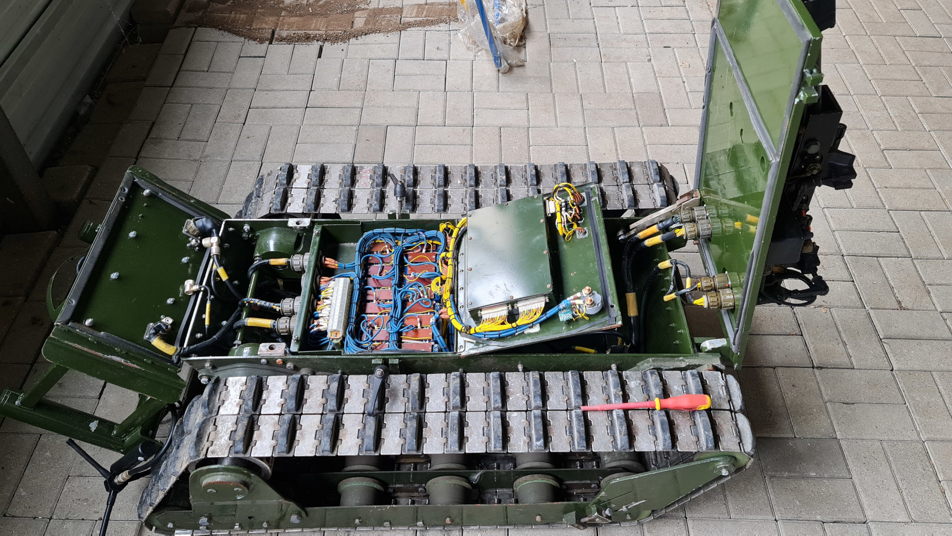

16 Nov 2023 16:35 #285665
Replied by tommylight on topic Retrofitting a TANK!

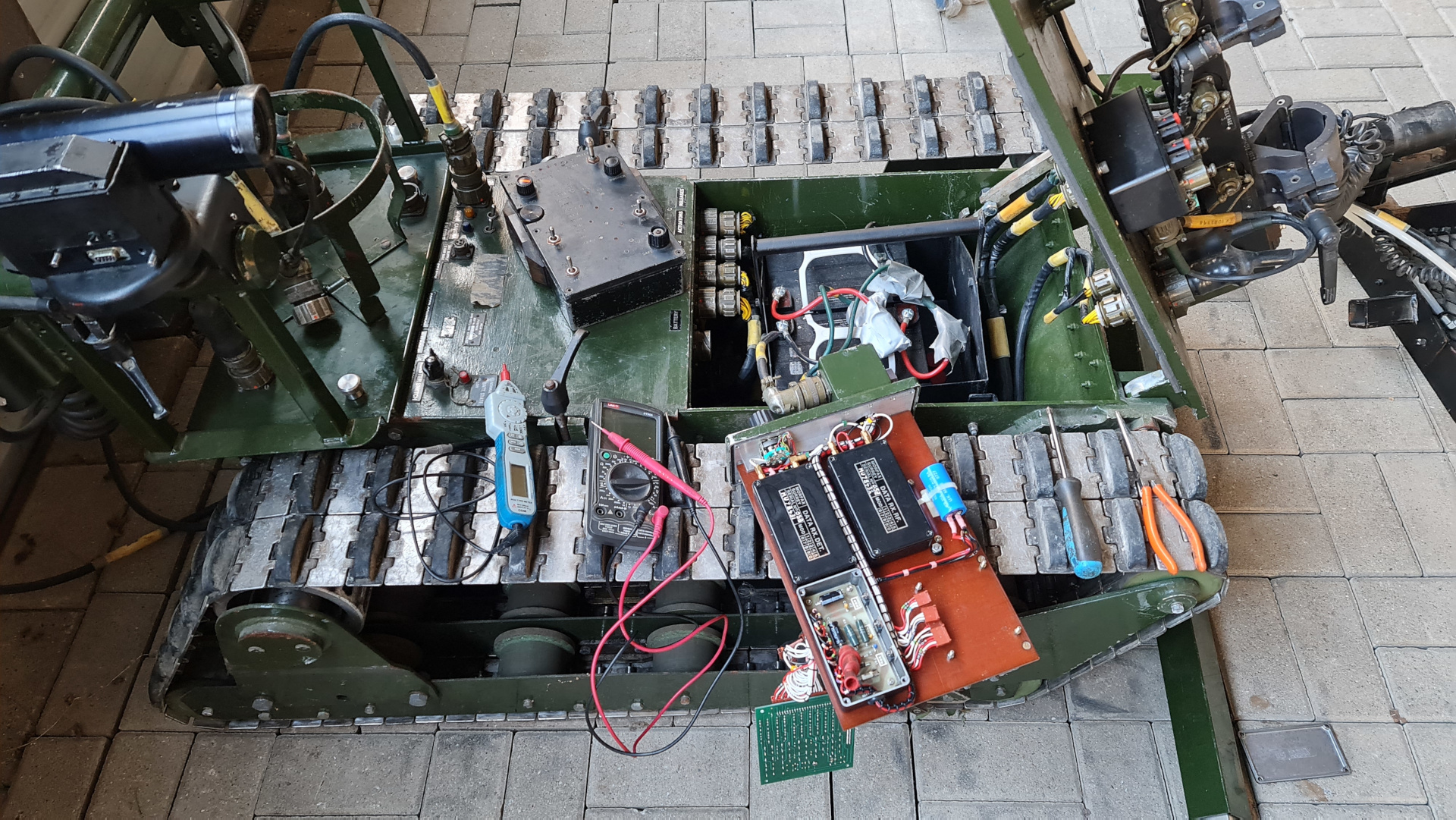

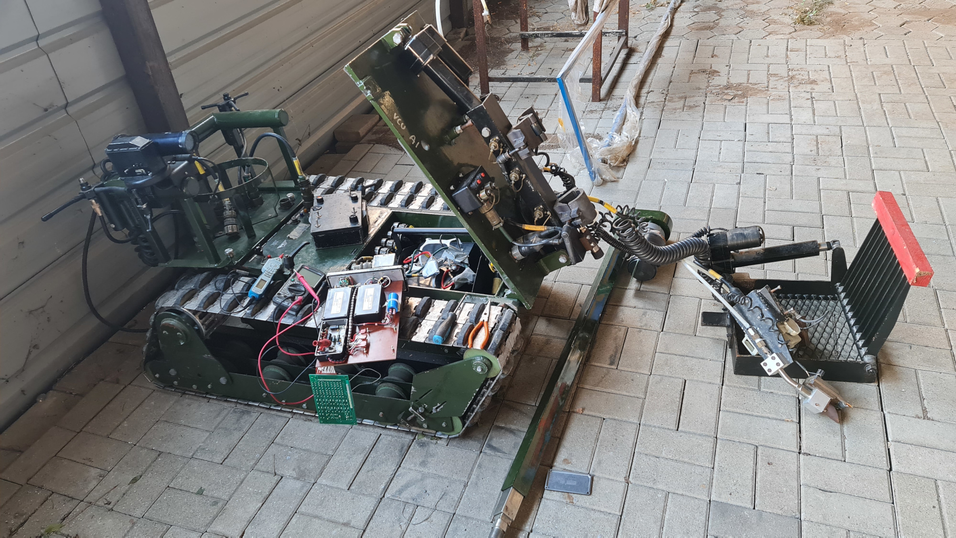

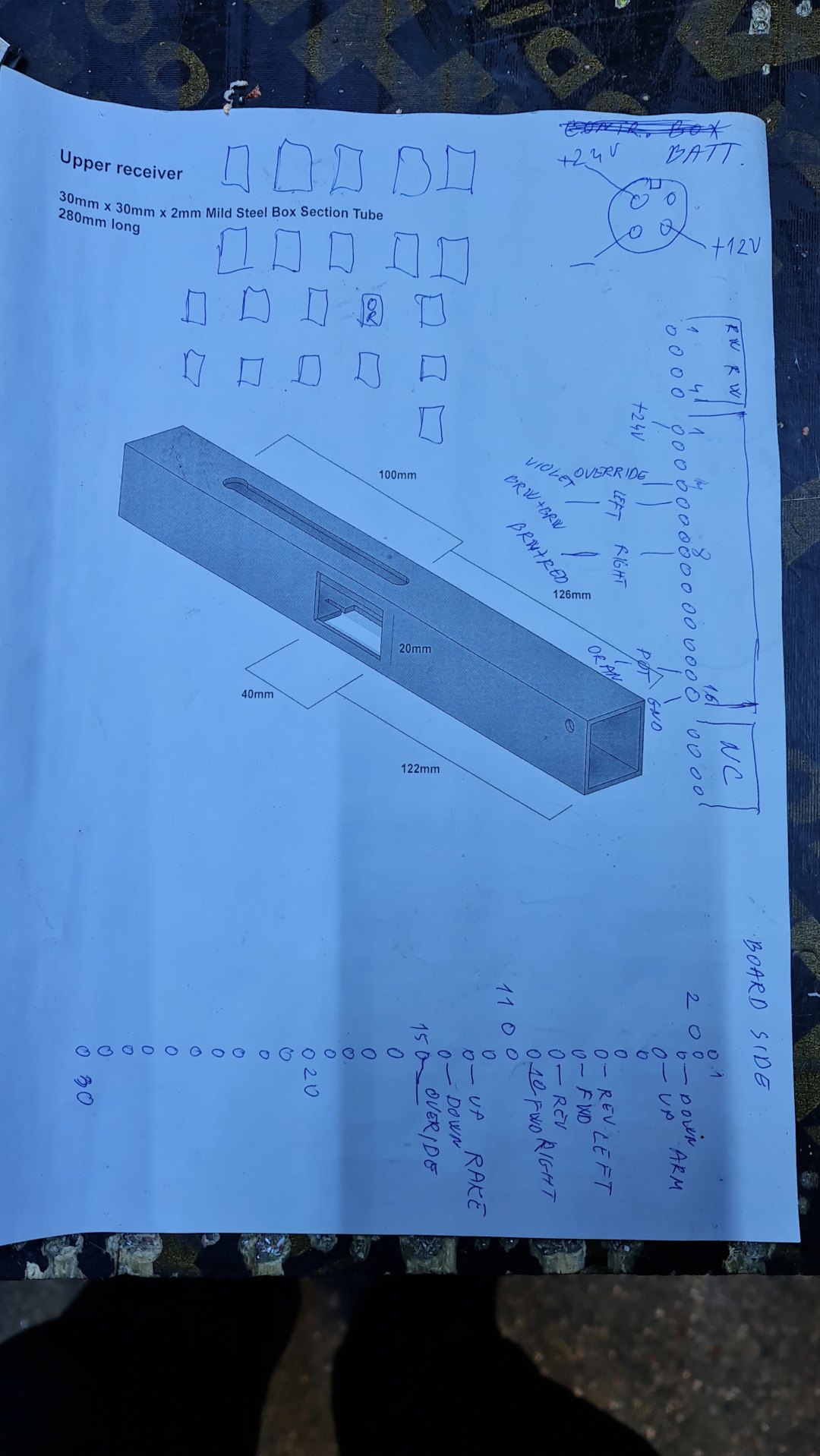

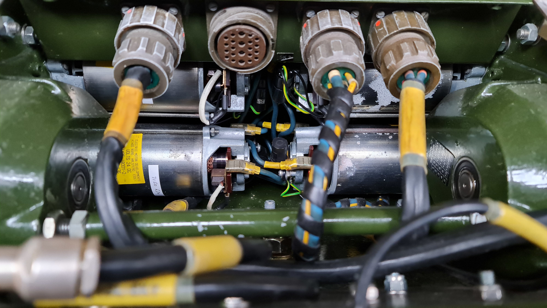

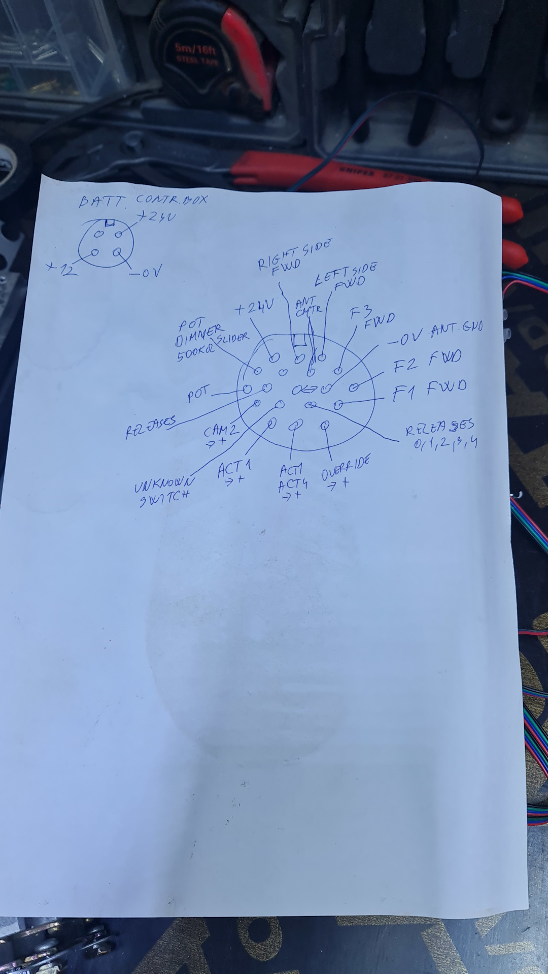

Been busy with this lately, got it, dismantled it, ordered some stuff, no drives for the drivetrain within the timeframe, assembled it again, reverse engineered the $hit out of it, got some of the ordered parts, did some tests, had a chat with them as to using everything from the old stuff and adding remote control or using only the drivetrain stuff and get rid of the rest so we can add new stuff.
This was due to how convoluted was the old control to use, with multiple buttons that each do multiple things through "mode" and "selector" switches, and any button press in the wrong mode messes things up in a hurry.
Much more work for me, but much easier to use as it will be used to train Ukrainian bomb disposal units.
Enjoy.
Enjoy.

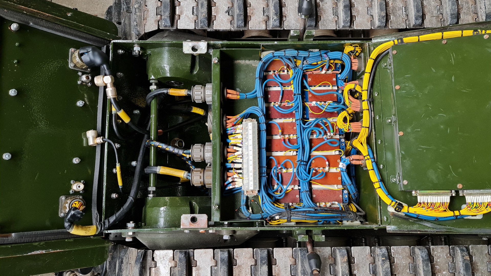

19 Nov 2023 18:35 #285980
Number 1 is finished!
Here is a video i quickly cobbled together, so go like and subscribe and enjoy.
