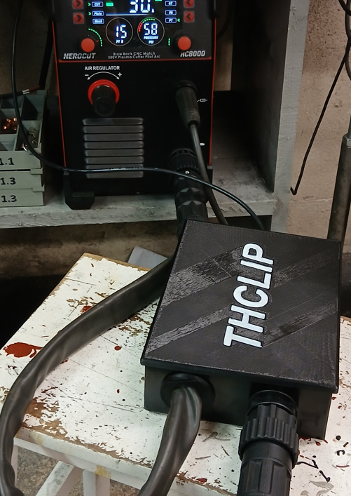

Unfortunately this goes back to work-in-progress state.
The normal arc voltage reader didn't give a reliable output during ohmic sensing.
I'll put in another voltage sensor, right over the 24V-ish supply to the torch and ground.
- Hakan
- Topic Author
- Posts: 1317
- Thank you received: 454

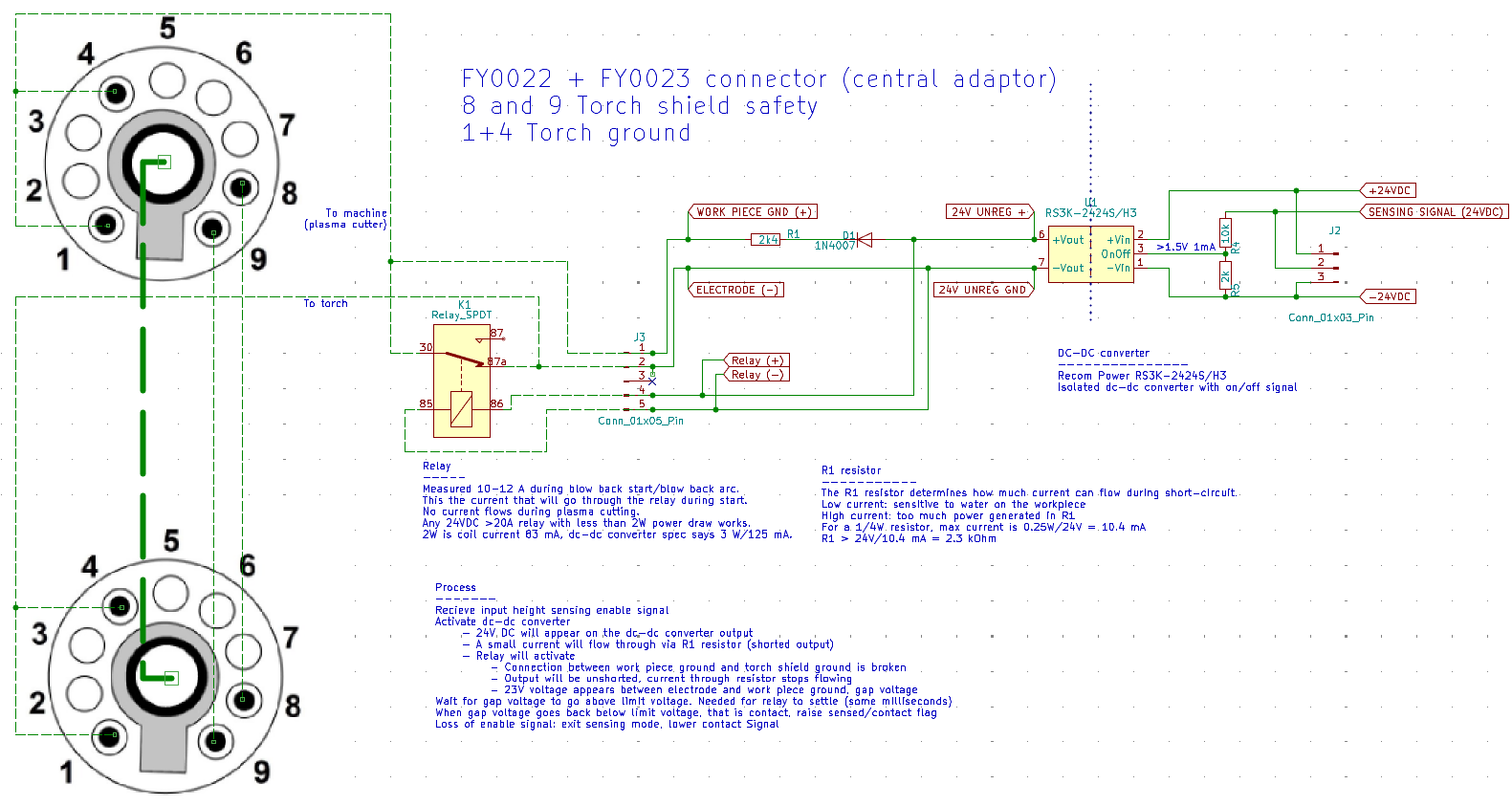

1 year 4 months ago #329973
by Hakan
Replied by Hakan on topic Ohmic sensing with IPTM-60

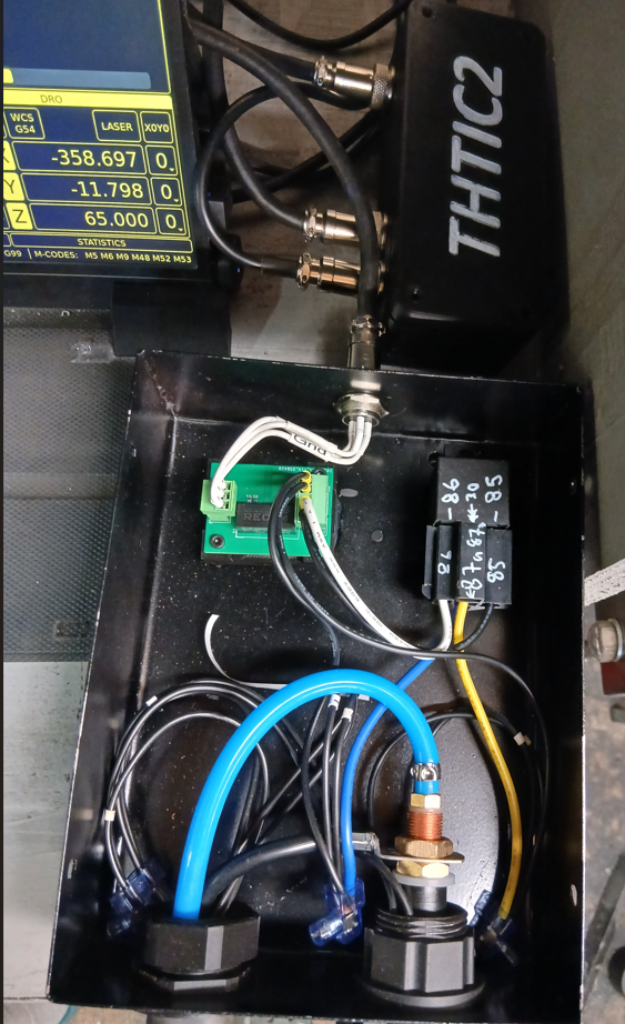

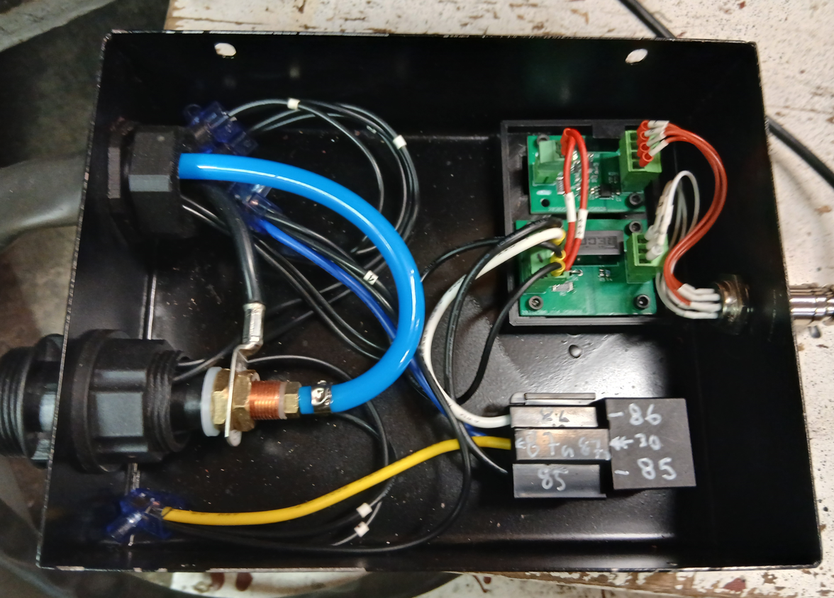

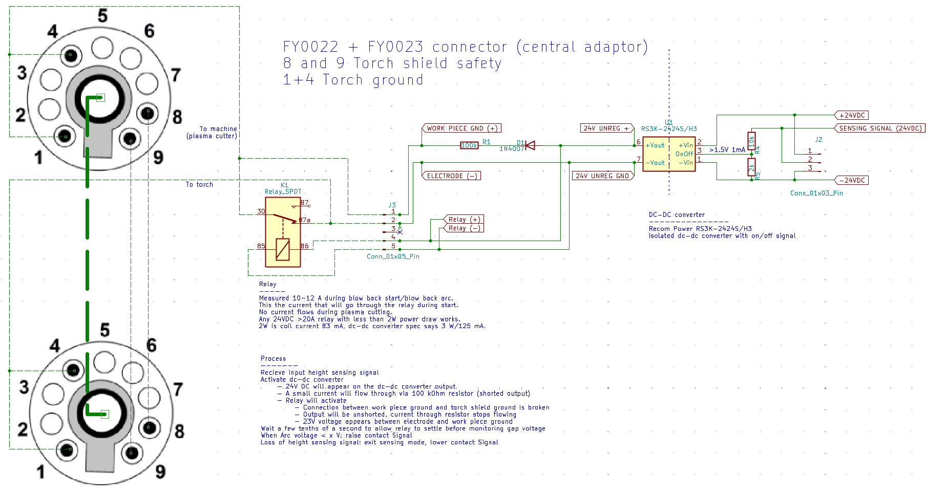

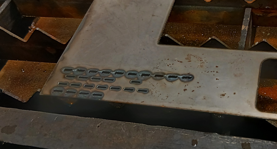

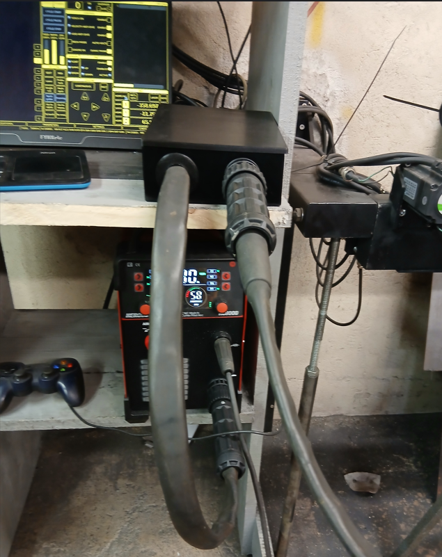

Now it works. Again
The arc voltage connector is not connected directly to the arc and the work piece. There is some electronics in-between I don't even want to know about. The arc voltage is fine when cutting, but not reliable at all when not cutting. And ohmic probing is not cutting.
Instead I had to resort to a second voltage reader and read the voltage where the probing voltage is applied.
And now it works reliably. At least on the tests I have done so far.
Test patterns. I might have used wrong material setting on some but that doesn't matter for the probing test.
A new voltage reader was put in the box, next to the relay that applies probing voltage.
Cover on and pushed in next to the plasma cutter.
Schematics and code is available at github.com/MetalMusings/MyOwnEtherCATDev...th-the-iptm-60-torch
It uses my own Ethercat device. But nothing hinders this principle to be used with other arc voltage measurement devices such as those from Mesa.

1 year 2 weeks ago #336411
by Hakan
Update of this project.
Regarding water on the table and difficulty to properly detect contact.
Yes, been there, done that.
It seems to be caused by too low R1 resistance. Which means too low current at short-circuit.
Stray currents through water are in the same order of magnitude as the short-circuit current
and influences the voltage measurements.
Too high R1 (low short-circuit current) and water on the table causes two things:
1. The measured voltage will only go to single-digit voltages, like 8V instead of 24V
2. The measured short-circuit voltage drop is only a few Volts. The voltage stays at some 8-3 = 5 V, where it should be 0V.
When looking at the voltage, well working means sharply up to some 23V, then sharp drop to 0V.
Not well working: Damped rise to some 10-ish V, damped drop of a few Volts at short-circuit.
Using R1 = 100 kOhm, short-circuit current = 0.24 mA. This is too low.
Using R1 = 2k7 kOhm, I = 8.9 mA works much better.

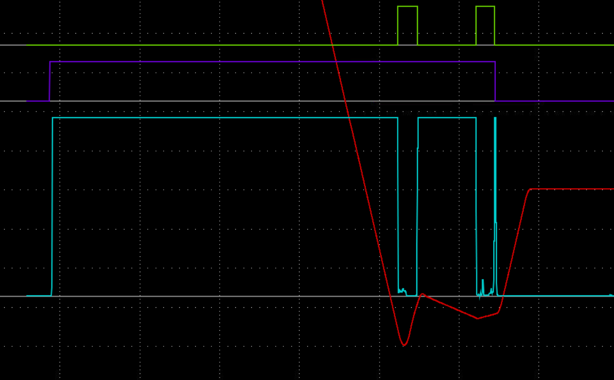

1 year 2 weeks ago #336415
by Hakan
Here is what a sensing cycle looks like under good conditions.
Green: Sensing output signal: 1 if contact, 0 of no contact
Cyan: Voltage between plasma tip and work piece
Purple: Enable ohmic sensing signal
Red: Z-axle position.
First there is a 15 ms reaction time for the relay to switch on, I call it setup time.
After the setup time has expired, the contact evaluation starts.
There are several conditions.
1. Voltage drop below a set voltage limit like 12 V
2. Voltage drop from voltage at end of setup, like 5V drop
3. Overall voltage drop over one cycle, like 5V
4. Overall voltage drop over three cycles, again like 5V.
For good conditions like then one in the picture all conditions triggers at the same time in principle.

1 year 2 weeks ago - 1 year 2 weeks ago #336417
by Hakan
With water on the table and too low short circuit current configured,
we get something like the orange curve. A damped curve with reduced "swing".
No sharp transitions between open and short circuit.
Of course I tried to fix this in software, therefor the four conditions to trigger a sensing contact
The right thing to do was to lower the R1 value and increase the short-circuit current.
