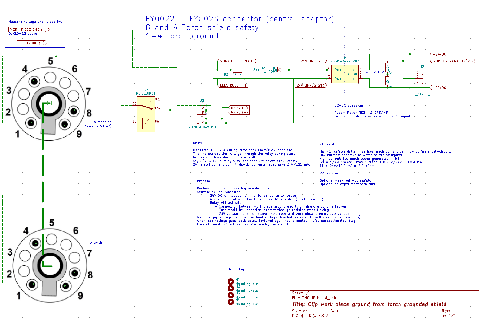

Led was easily solved with oneshot to qtplasmac.ohmic_led_in.
It works pretty well now. Time to wrap up this project.

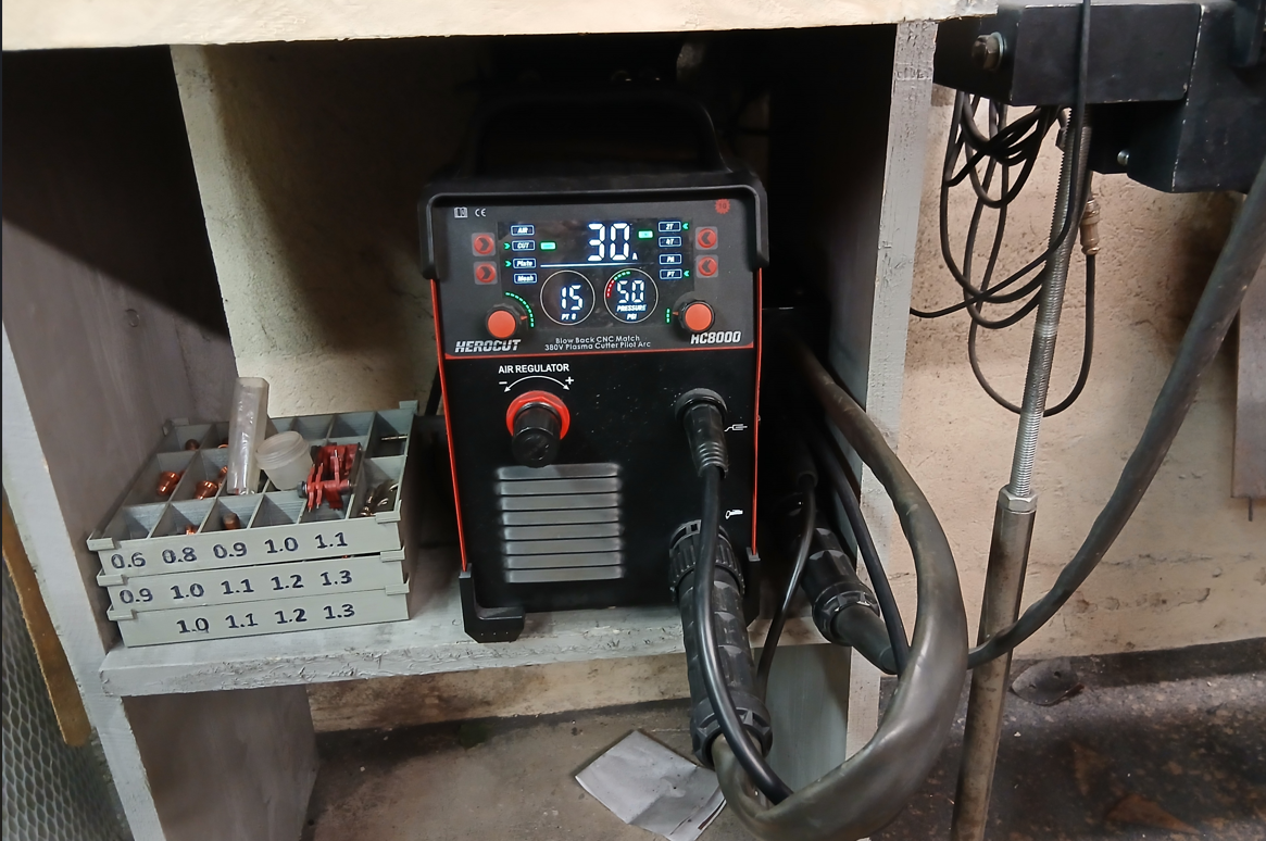

The goal was ohmic sensing with the IPTM-60 (and IPTM-80) torch
without modification to the plasma cutter. I think it came out really nice.

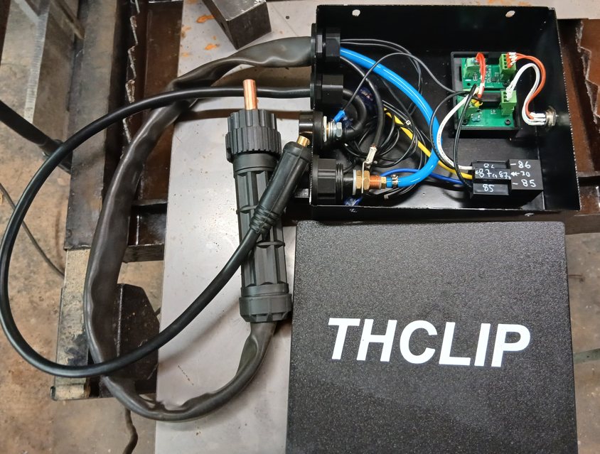

A new box was made, needed to measure on what we call the ground lead.
The box tucked away
Schematics.
All schematics, code etc are available on github
github.com/MetalMusings/MyOwnEtherCATDevice
specifically the Kicad files for the THCLIP board are here
github.com/MetalMusings/MyOwnEtherCATDev...n/Cards/THCLIP/Kicad
