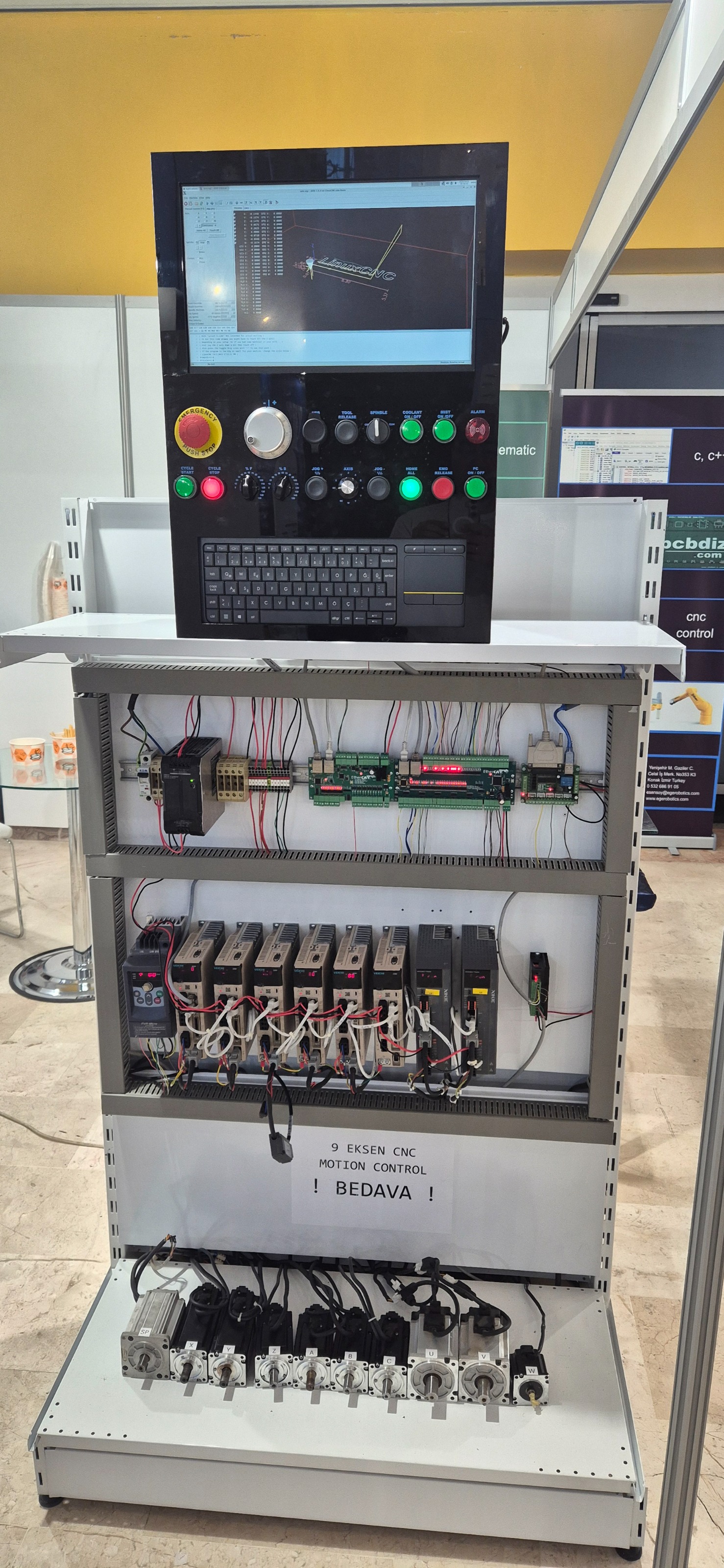

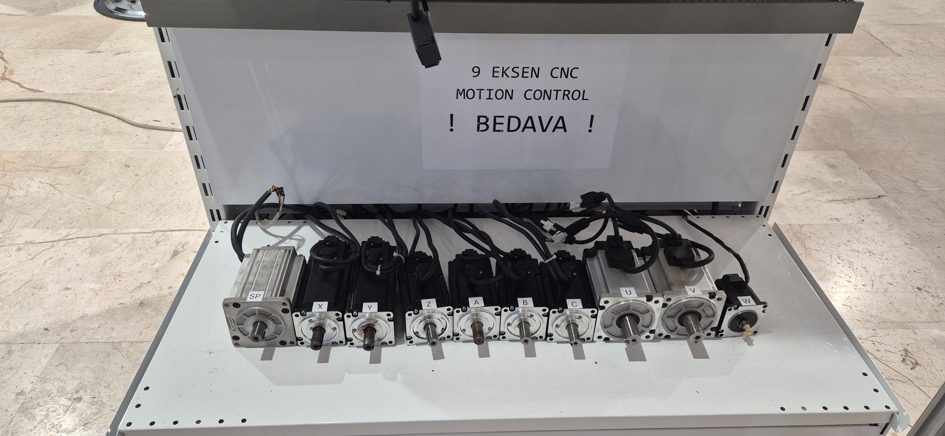

1 x spindle

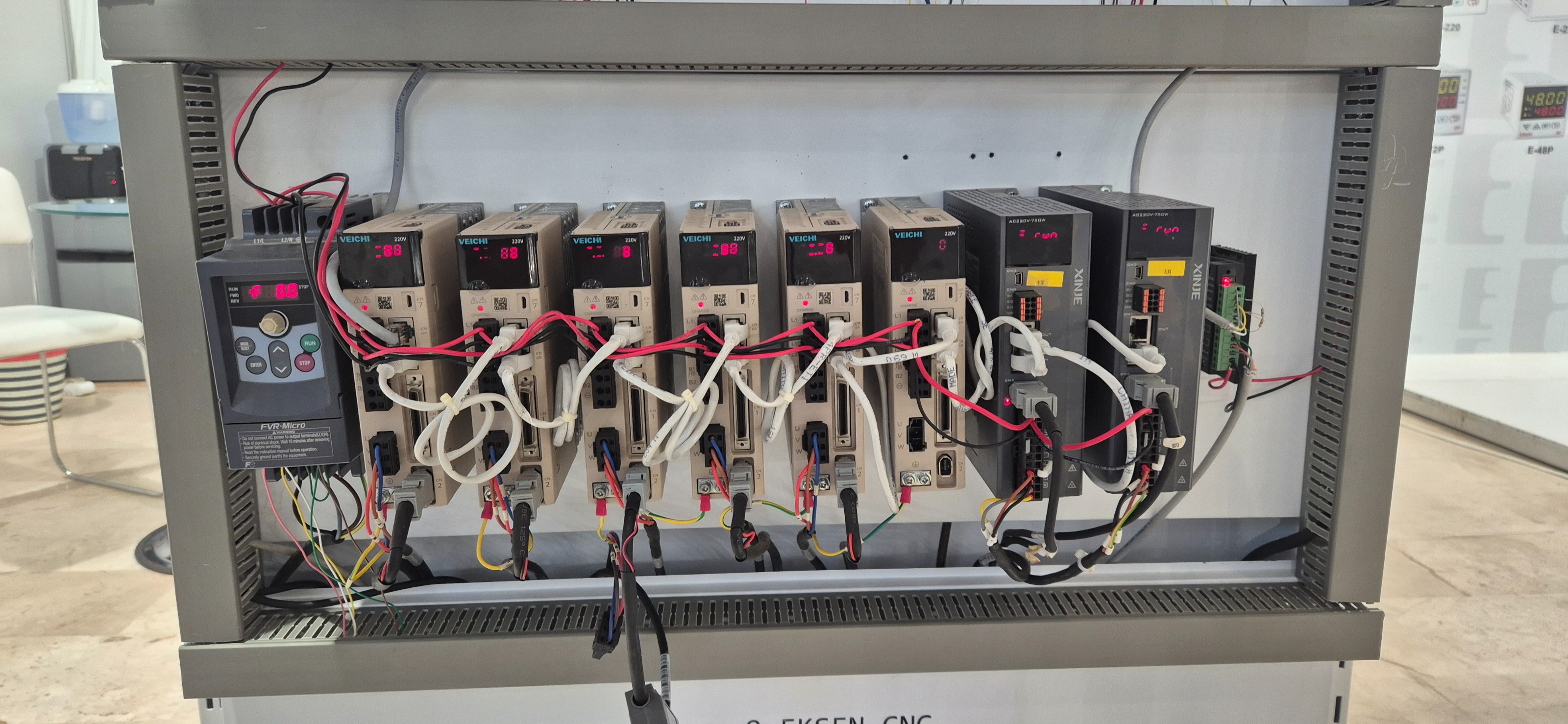

8 x ethercat servo motor
1 x pals dir step motor

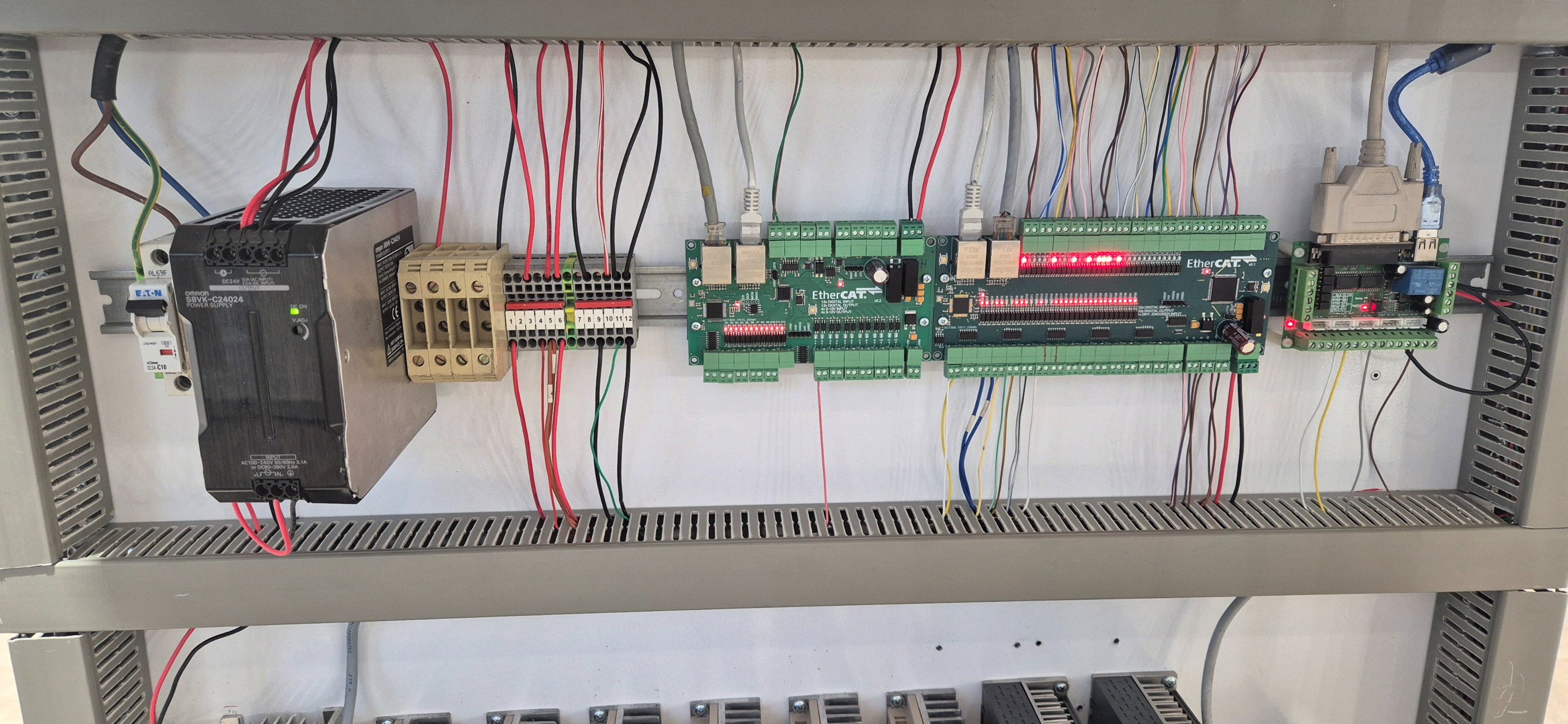

1 x ethercat 12x digital analog io card
1 x ethercat 32x digital io card

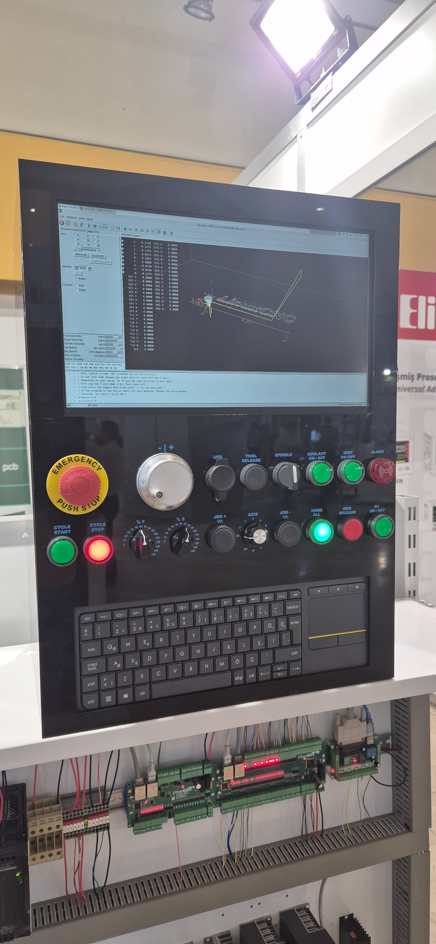

linuxcnc 2.9
linuxcnc 2.9

very nice, why not ethercat for all 9 motors?
Do you have a link to the ethercat I/O boards?

I put a simple stepper motor in the last row to show visitors that it can drive Ethercat motors along with stepper /dir motors.
YOu can find detailed information at;
www.egerobotics.com/ethercat-dig32-io-interface
www.egerobotics.com/ethercat-digital-analog-io-board
www.egerobotics.com/ethercat-encoder-interface
www.egerobotics.com/ethercat-pwm-rc-servo-interface
