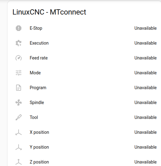

There seems to be a lot of systems like this recently.
The correct method is to use MTconnect which is a standards based read only API now included in LinuxCNC master branch.
With MTconnect you can publish the same data to Home assistant which can then trigger automations
mtconnect.org/
This took me all of 5 minutes to publish to Home Assistant (sorry Linuxcnc is not running right now...)
