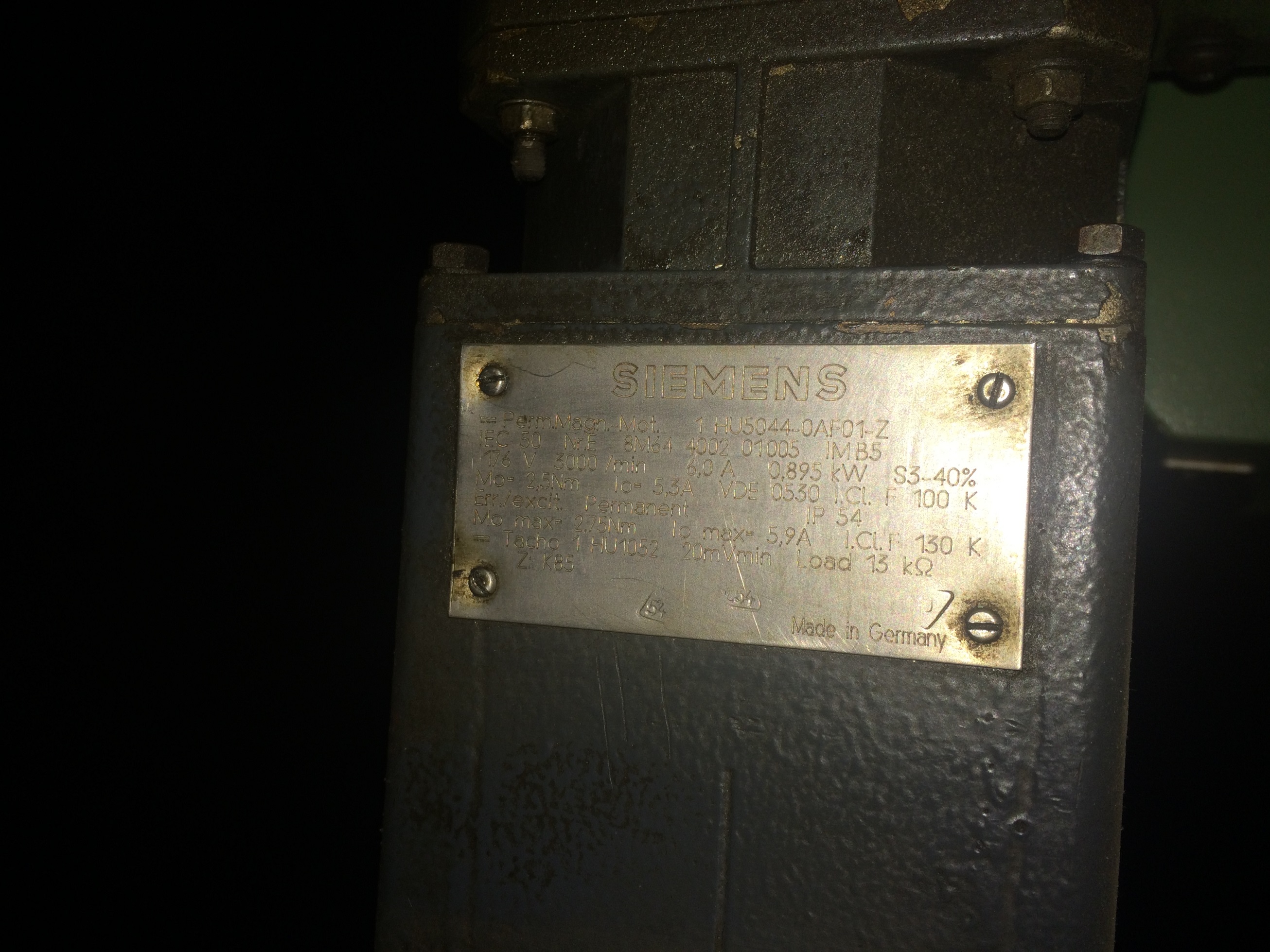

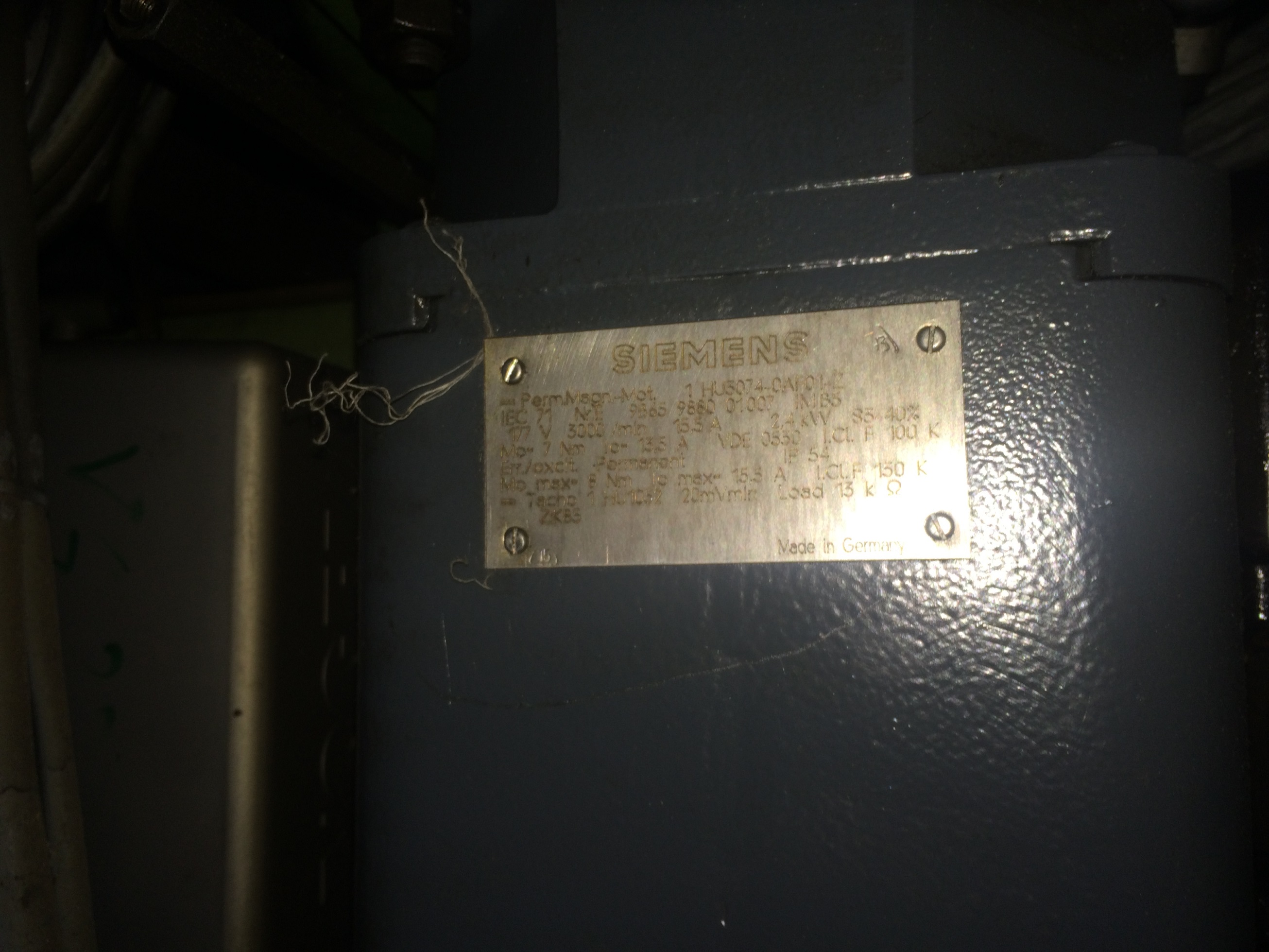

these are the photos of x and z axis motors.I have the three axis version.by the way the four red leds of driver light up when i power on the machine.can it be fixed? I should mention one of the contactors of machine that is on other side of machine is damaged.I only ask this becuase I don't want to sped money for the boards and later find out that the dirves are damaged too.
thanks in advance
p.s sorry for my bad english.It is my second language after all:)
thanks in advance
Last edit: 12 Dec 2016 07:14 by bahrabadi. Reason: wrong pics

There are tachos on both of them, 2V/krpm. i can not see any reference to encoders on the plate, and the pictures do not show the complete motors. Maybe a search for motor models can reveal more.

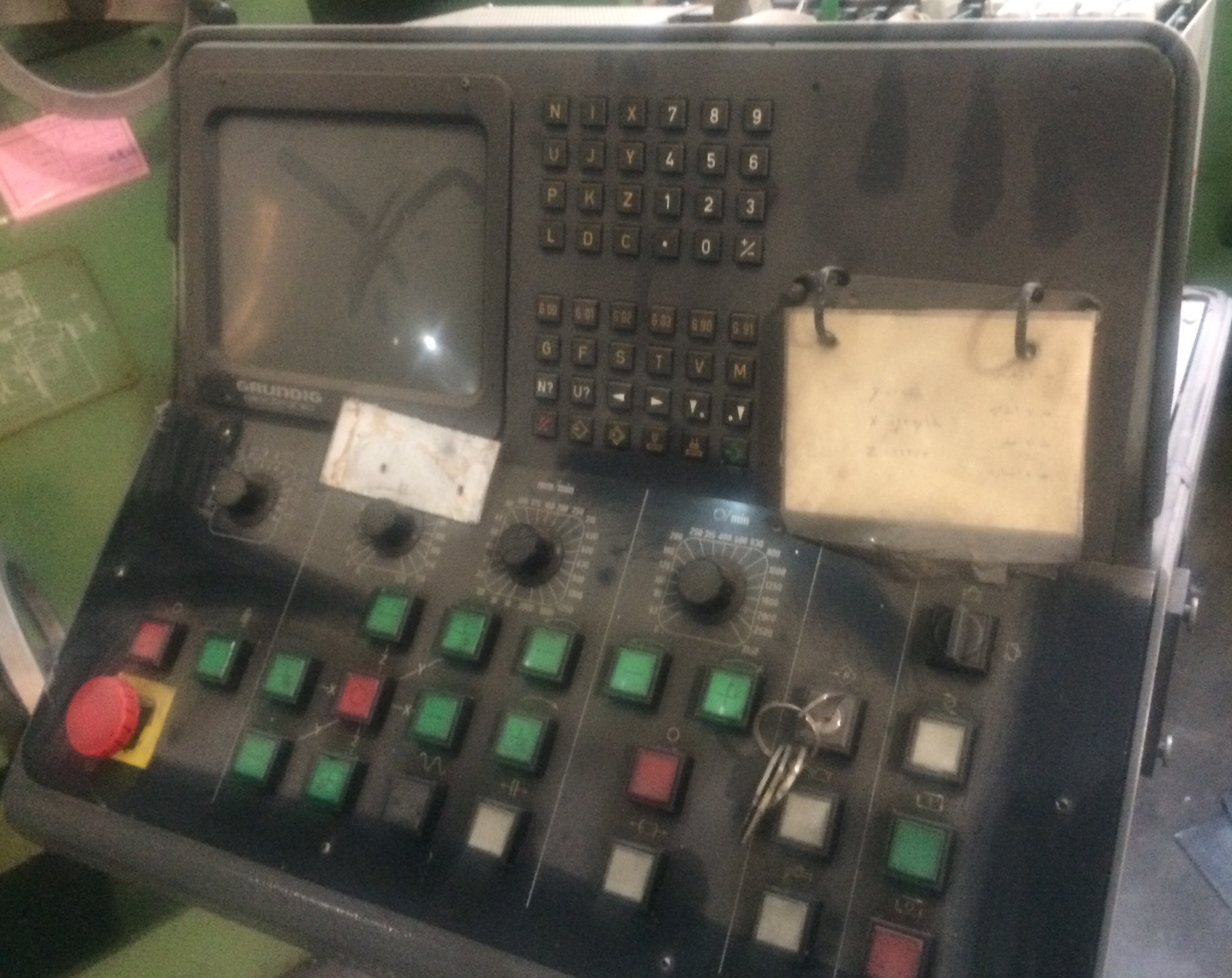

What control does / did the machine have?
Is the control broken? ... what functionality do you have?
It's likely to be either a Heidenhain TNC 300 series or a Grundig Dialog 11.
I know nothing about the Grundig control.
I have an FP2 with a Heidenhain TNC 315. You should have Heidenhain glass scale linear encoders on all the axis. There are no encoders on the motors or ball screws.
The encoders will likely have an 11ua sinusoidal output and a 20 micron grating pitch. Definitely if it's a Heidenhain control, very likely if its Grundig.

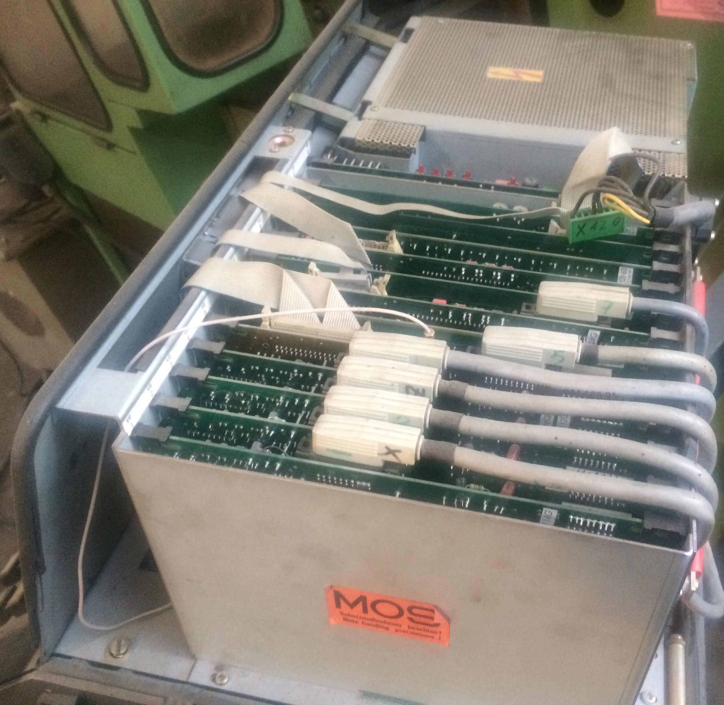

There should be several M23 plugs in the back of the cabinet coming from the encoders. these need to be plugged into the exe units and then a cable made up from the EXE to the 7i77
They will probably be labelled X1,X2 and X3 .... X Y and Z encoders accordingly.

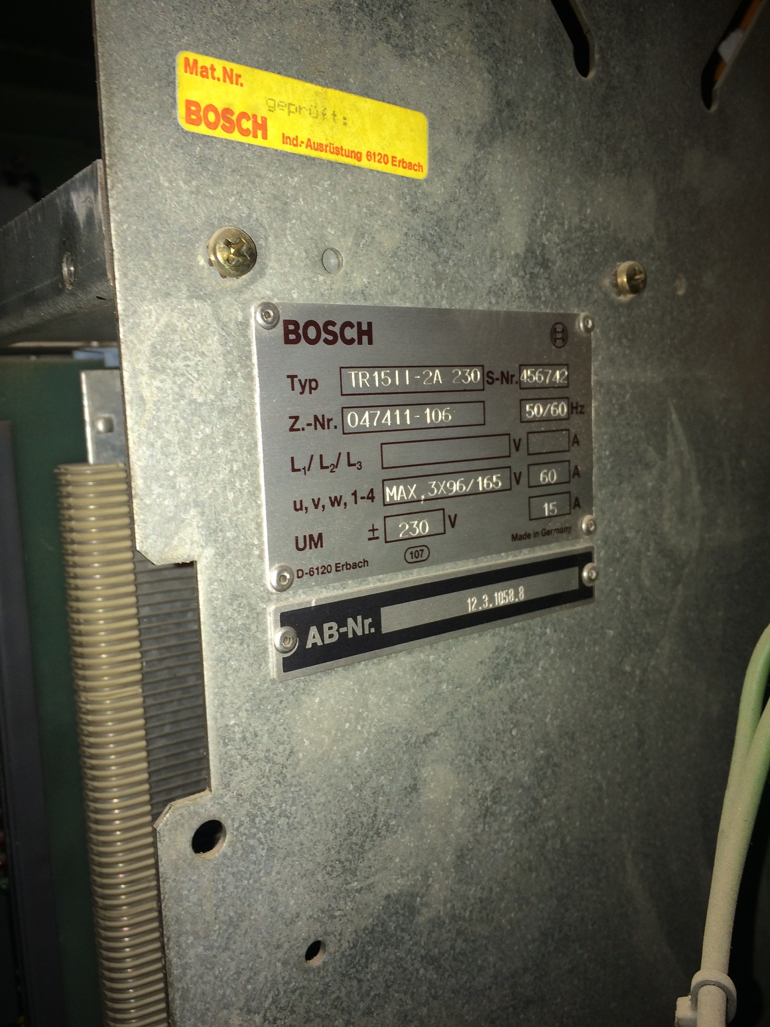

The bosch control will be expecting a +/-10V signal so the inputs to the drive can be wired straight to the 7i77. There will also be one or more enable signals and possibly a "drive ok" signal back to the control.
I would leave everything on the output side of the drive, motors, tachos ... cables .... everything well alone. Don't touch the pots on the cards that are in the drive.
You should be able to test the movement of the axis by applying a small voltage to the drive inputs ...0.5 ... 1V for example, and make sure the axis move. Once you have managed to get the drive enabled that is.

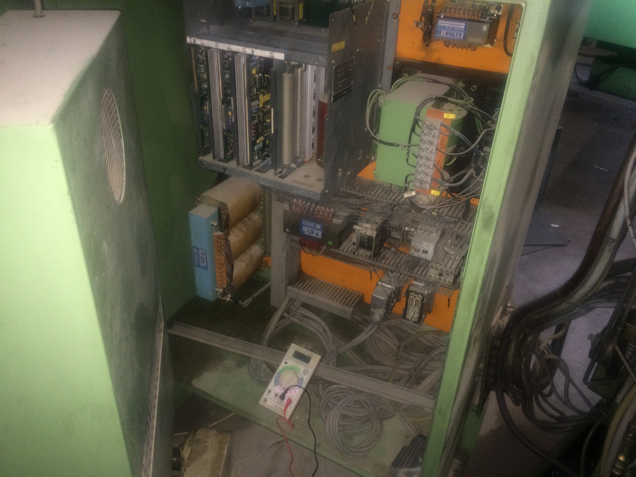

As Andy points out, the drive will not "enable" unless it sees the relevant signals from the control.
The LEDs on my drive are all red until I press the "NC ON" button and the control is happy with everything and then it will enable the drive. Assuming that you have a defective control, and that's the reason for the retrofit, you will never get the the drive to enable just by powering everything up. ... Hence the red LEDs
