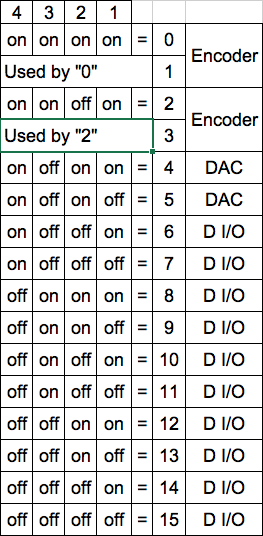

Yes, on-on-on-on = address 0. Switch 1 is the least significant bit, switch 4 is the most significant. On the newer encoder cards, switch 1 has no effect, as the boards need to be addressed to an even address.
As for the tests in the previous message, these show that the new encoder card (addr 0) is working correctly, and all other cards appear at the expected address.

27 Dec 2016 22:06 - 27 Dec 2016 22:56 #84765
by tjamscad
Last edit: 27 Dec 2016 22:56 by tjamscad. Reason: Fixed chart

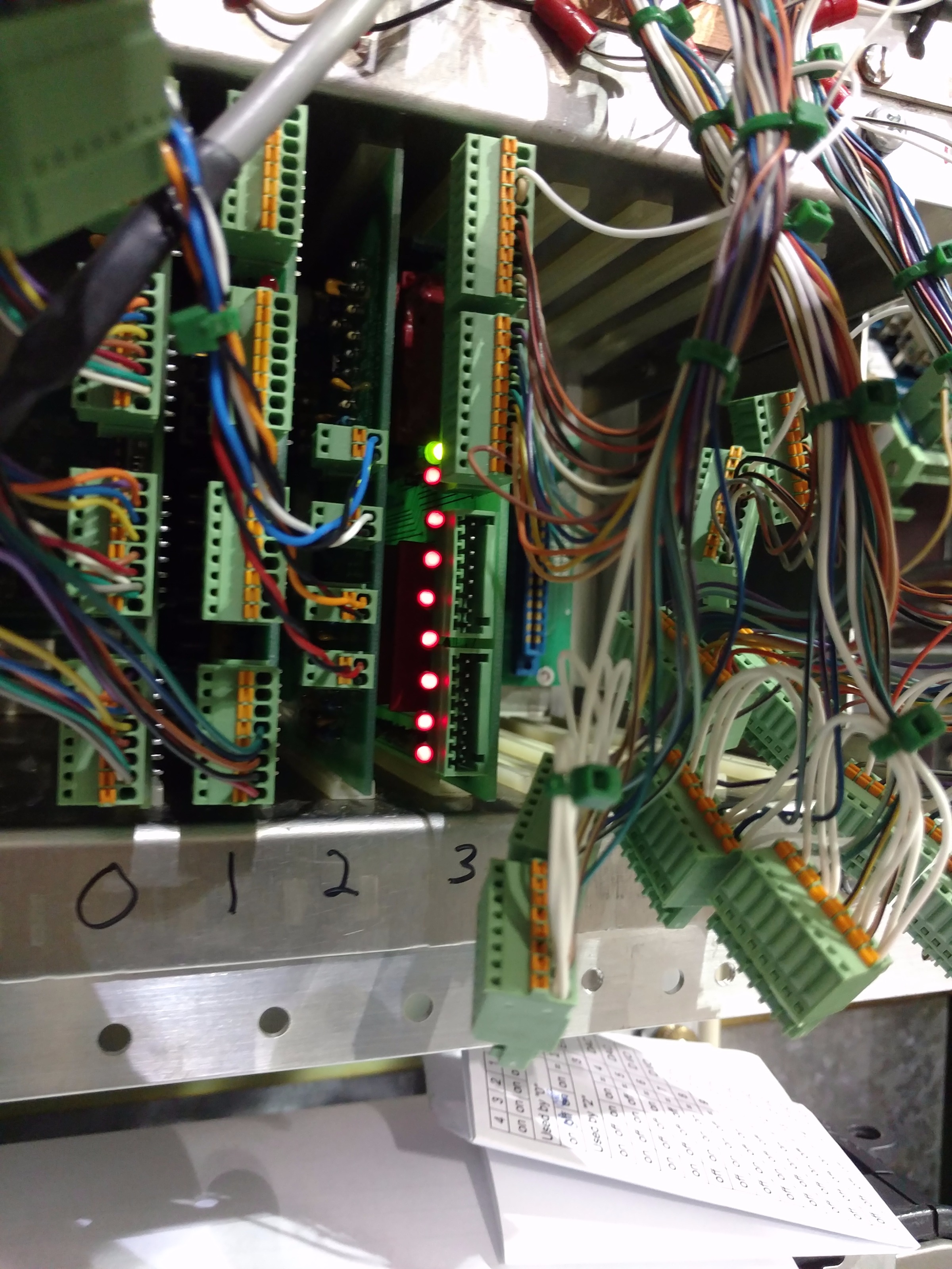

28 Dec 2016 06:10 - 28 Dec 2016 14:17 #84791
by tjamscad
Replied by tjamscad on topic Error, this machine is killing me!!!
I did test them one at a time and the results are listed with serial number of the card in that zip file.
The green and red lights are all on they do not flicker.
Last edit: 28 Dec 2016 14:17 by tjamscad.
28 Dec 2016 17:39 - 28 Dec 2016 17:40 #84812
by jmelson
Replied by jmelson on topic Error, this machine is killing me!!!
Hmmm, this is really weird! Now, some of the older DIO boards did not have the readback feature in the firmware, so this result would be expected. But, there is one much later board (SN0041) that should have the latest firmware, so the readback on that one should be working.
When you power up the PPMC motherboard, do all the red lights come on immediately? That should not happen, the red LEDs should all be off, as the board should be in the power-up reset state, and in E-stop.
If you halt the diotest with ctrl/c, are all the red LEDs lit, or do they have some random pattern with some lit, some dark? (The diotest diagnostic sends random patterns to the SSRs and then reads back to see if the values match what it sent.) It goes so fast that the LEDs may appear all lit when the diag is running, but they are actually flickering on and off about 50%, but probably too fast to see.)
Jon
Jon
