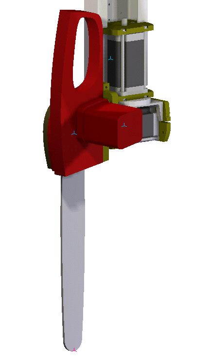

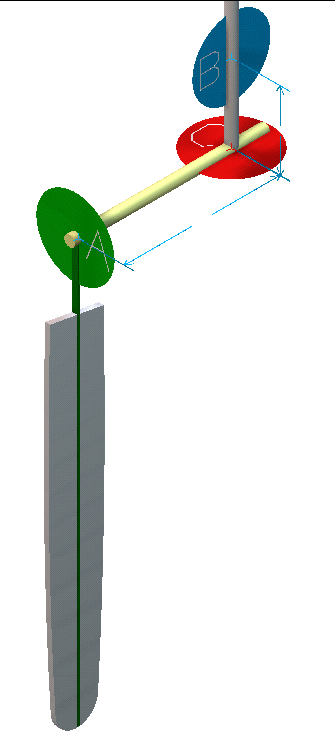

In writing the kinematics for an existing machine detailed in the attached .png files, the problem is that when I home all joints in joint mode (using the Axis UI), the machine coordinates reflect the correct offset of
X: 7.0625
Y: 0.0000
Z: 25.0000
A: 0.0000
B: 0.0000
C: 0.0000
but when I enter the following G-code into the MDI:
g0 c30
the manual display in joint mode shows
X: 0.9462
Y: -3.5312
Z: 0.0000
A: 0.0000
B: 0.0000
C: 30.0000
This result indicates (to me) that the head of my machine will be translated along the X axis FURTHER from 0. The trig in my equation ie:
adj.x = ((C_len * cos(C_rad)) * cos(B_rad)) ...
where rotating the C axis SHOULD yield a result for X CLOSER to 0 (as the identical equation entered into a spreadsheet does).
I have attempted various modifications of this statement including:
adj.x = C_len - ((C_len * cos(C_rad)) * cos(B_rad))) ...,
double C_reverse = deg2rad(C_deg + 180);
adj.x = C_len + ((C_len * cos(C_reverse)) * cos(B_rad))) ...,
etc...
but ALL equations result in a translation amount FURTHER away from 0X. This result is unexpected and incorrect.
Also, rotations of the A and B axes result in expected translations of X, Y, and Z (identical to the results achieved in my spreadsheet).
Comments:
This machine is complete and ready to start cutting. The only thing stopping me is this error in the translation results, and I have been attempting to achieve the correct results for about two weeks, to no avail. I certainly hope you guys can help solve this.
Regards,
niftyEnt

01 Jun 2013 10:18 #35076
No. * only means multiplication if it is between things that C expects to multiply. As I understand it spaces are ignored in C syntax.
So, *a and * a are the same.
Whether the * is multiplication or dereference is context sensitive. Don't ask me to defend C.

01 Jun 2013 22:20 #35098
I don't understand why you think that X=0.9642 is further from the origin than X=7.0625
Replied by andypugh on topic C code in <any>_kins.c for an XYZABC machine
Any suggestions?
