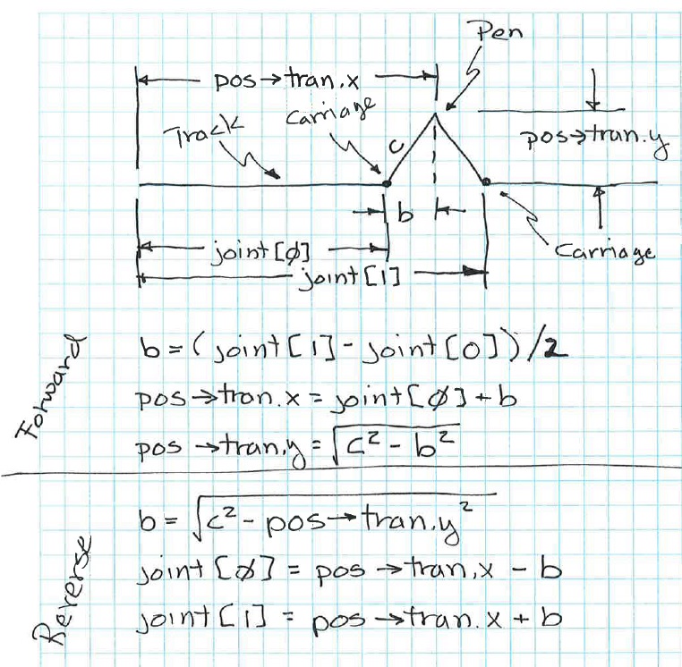

I am working with a group of CNC builders at the Chicago HackerSpace Pumping Station One. We are building a "simple" 2D drawing machine. The machine uses 2 belt driven carriages on a single linear bearing. The math is pretty simple and is attached. Believe it or not, we actually got the machine drawing in Mach3 using the "functions" feature.

Using the MDI tab with G code commands we are able to get X motion at the pen. That is pretty simple because for X, both carriages always run at the same speed and direction as the pen. We can command the pen to move in Y, but only at very low speeds. If we try to go fast EMC gives us all sorts of joint speed and position errors.
Atached is our current kinemantics file (We just modified trivkins.c). At this point I think it has been hacked beyond our initial successes, to completely broken.
1. For this type of machine, what do we return for kinematicsType()?
2. What do I want to do in kinematicsHome(). When is this function called and how often?
3. Why does the machine starting running immediately.?
4. Can everything be done in the mykin.c file or do I need to modify other areas of the HAL.
