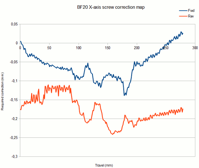

Connected the encoder output to motion.analog-in-00 and wrote a few lines of G-code to travel the entire range in 256 steps and write a compensation map using (LOG, ...).
Result. Scale is milimeters, blue is the required compensation (midpoint between fwd/rev corrections), red is compensated:
I find the blue graph hard to believe. Will have to do some extra checking with analog dial indicators.

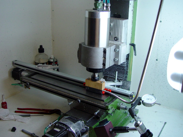

Did a decent mounting of the glass scale:
New compensation map:
Oh my, that's a terrible amount of backlash :evil:
It used to be less. I suspect the ballnut mounting method used on the BF20/G0704. Backlash on the X axis is bugging me ever since I bought the machine. Thought it was the leadscrew, so i replaced that one with a ball screw and backlash went to 0,02mm. But I guess the leadscrew is not the root cause. *sigh*
At the moment I have the axis running in closed-loop using the screw map for the majority of the compensation and a PID-loop to cancel the residual error. It runs a little rough and I get an occasional following error, but it seems to work.

Can you twist the bed in its guides? How much does that move things? With your new mounting you can detect anglular as well as linear backlash.
You might learn a lot from putting the DTI on the end of the ballscrew. Perhaps the screw moves in its bearings?

Bearings are tight and preloaded at 1,2kN. I checked screw movement, but it is nonexistent (as it should be).
The slide moves on the base (Y-axis slop) about 0,01mm when pushing or pulling with full force. X-axis is worse; that's around 0.4mm with the table at the end of the travel (maximum extension).
I already tried lapping the ways with some grinding paste, which improved things a little. Scraping is probably the only option that yields good results.
