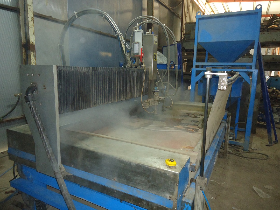

we are currently doing a retrofit on a waterjet system.

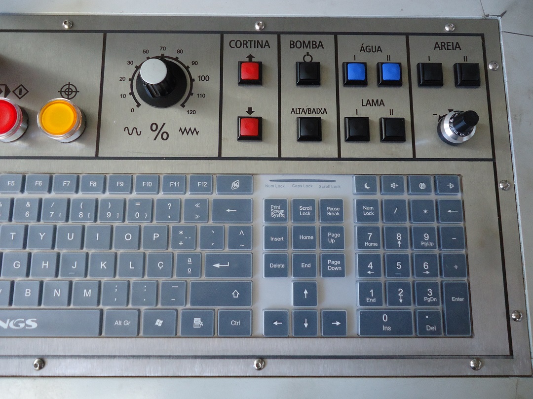

the user can turn on and off the 2 nozzles and the 2 abrasive senders by the buttons on this panel. This buttons are connected to a toggle component, and in each state of the toggle it sends a M code. Its like press one time, turn on nozzle1, press another time and turn off the nozzle1. But currently we have a problem. If the machine is running a program, in auto mode, it just ignores the inputs of the buttons. For example if is wanted to disconnect the abrasive sender, it can't be done.
Is some way to have control all the time by the panel buttons?

- neodym
- Posts: 11
06 Oct 2017 04:13 #99981
by neodym
Replied by neodym on topic Waterjet panel buttons
Hello João
I am interested in the keyboard which you have installed. Do you have information about the manufacturer?
Micha
Micha
- jtc
- Posts: 147
- Thank you received: 12
06 Oct 2017 04:23 #99982
by jtc
Replied by jtc on topic Waterjet panel buttons
NGS ivory I believe. It should be hard to find in theses days.
João
