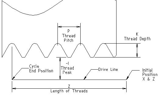

Hi!
Usualy lathe has front turret layer and the moving in G76 (threading cycle) cycle begins from X max to X min (in the deep of workspace).
But I have back turret layer, and when I use G76 command, the drive line moving hit tool in the metal.
I need to swap drive line from positive to negative, but don't know how to do this.

Negative for internal thread, but I have external thread.

1. There is drive line.
2. I start the treading cycle.
3. "I" parameter positive for external thread and negative for internal. But in my case, I parameter TOLD THE CNC TO MOVE IN METAL AND NOT IN SPEAR SPACE! So as material is from other side of tool as in Fig 14.3 in "LinuxCNC User Manual".
The moving is from top to bottom (Fig 14.3) in my case and not from bottom to top as shown in Fig 14.3.
Replied by aike on topic Back tool turret layer and G76 (threading) problem

26 Jul 2014 03:21 #49147
In that diagram bigger-X is down.
Which way is "bigger X" in your case?
It's all just numbers, the controller has no idea what is on the ends of the wires.
I am sure that the problem you have is not because of the rear-toolpost.
You can prove it by manual MDI. Imagine a 6mm thread. You would move to X7 Z0 and then use I=1 and K=1
First pass is made at X = I + increment = 5.9
Then it moves to the start X (7)
Then it returns to Z = 0, and repeats.
As long as "bigger X numbers" == "further away from the work" everything works just the same for rear toolpost as front toolpost.
Of course, if you are using negative X numbers for the rear toolpost, what I just said isn't true. But there is no reason to do that unless you have a front toolpost too.

I use front and back tools. I don't do anything with the axis.rc file.
I use G10 L2 R0 and G10 L2 R180 to rotate the coordinate system around the Z axis.
The same g76 parameters are used whether front or back.
The tools display correct but you need different orientation & angles for the back tools.
Tool Defs:
P is Tool No. I & J are angles, Q is orientation.
G10 L1 P4 R.002 I120 J60 Q6 (Front tool)
G10 L1 P7 R.002 I-120 J-60 Q8 (Back tool)
