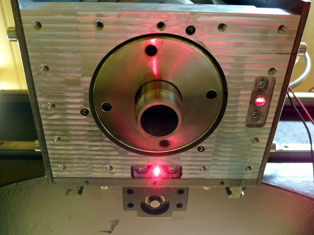

First I'll have to finish the mill itself
It spent the last two evenings milling the work area flat (and it is not even done yet). I do this very slowly by taking a pass and waiting a few minutes; if the temperature of the surface rises while the bottom is still cold it will warp. Until now there are not many surprises, which is a good thing. After that I have a couple of other jobs to do to, but then I will continue with the 4th axis.
For that 4th axis I have a 1.1kW/3000rpm servo motor with 2500 lines encoder. In positioning mode it can do 3000rpm, but in (analog) velocity mode it should be capable of doing a bit more with loss of torque; I can set the maximum velocity up to 5000rpm. I am thinking of gearing it down 1:3 or 1:4 using a wide steel-reinforced toothed belt with large pulleys. That way I can do ~1250rpm or ~14Nm of torque. Should be sufficient; most of my turning needs involve POM, aluminium and brass or small diameter steel. I also need a fairly large/heavy chuck to match the inertia of the chuck to the servo. Even then I think positioning is not stiff enough for 4-axis milling (there must be a reason why everybody gears down that 4th axis 1:100 or so), but since most 4-axis milling can be done using simple indexing, a brake should take care of that.
But I suppose that leaving a little space for a second set of pulleys and an encoder on the main spindle is not such a bad idea
I intend to mount the lathe tooling to the Z-axis column itself, not in the spindle. I drilled a bunch of holes in the bottom plate just for the 'I want to hang something on the column, now where do I attach it?':
I think that handling the brakes is best left to one or more external components instead of one big monolithic millturn-helper component. That allows easier tailoring to a certain situation.
Having LinuxCNC swap display modes and possibly the meaning of the X and Z axes when the component is activated is also not very high on my priority list. Personally I don't need it when using mixed mode since the NGC code for that is most likely handcrafted anyway. And if I intend to do turning only I might as well start another configuration.
