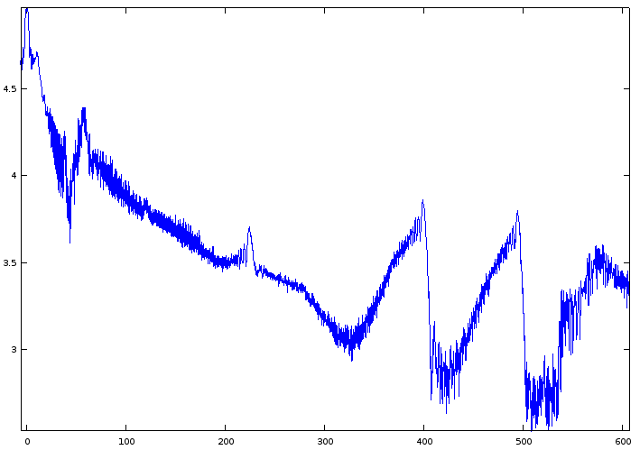

23 Oct 2014 03:39 #52308 by DaBit
Sinesweep and white noise excitation of the servo (directly fed as torque to the amplifier), the measured value is the velocity coming from the encoder, logged with sampler/halsampler.
Images are very raw Octave plots; I didn't even window the FFT data or bother to put labels in the plots.
White noise:
Sine sweep:
Looks useful.
Around 11Hz and 13Hz there seem to be a few peaks.
59Hz is strong, 224Hz, 400Hz en 493Hz also.
Lets add a few notch filters and see what happens...
