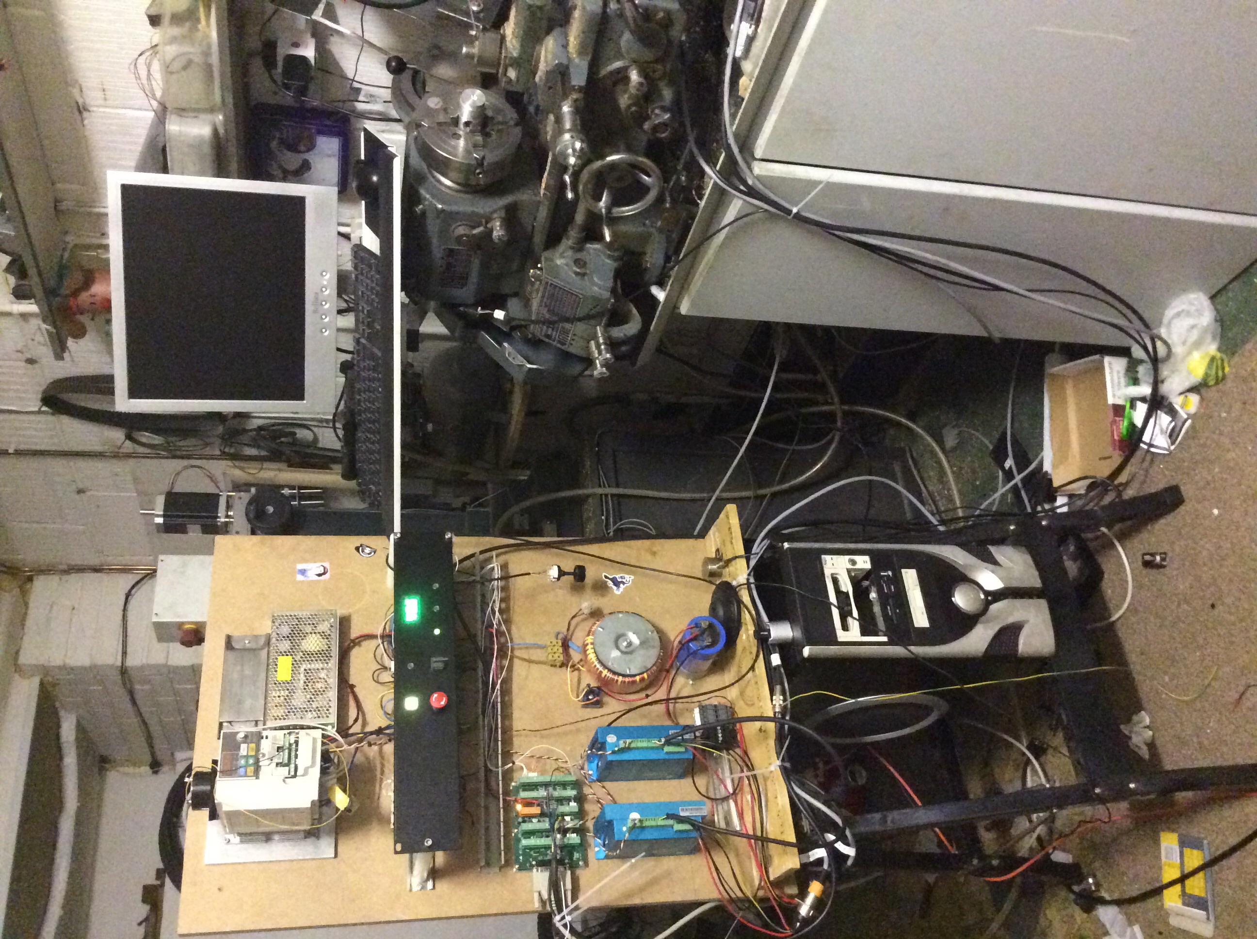

Thanks ArcEye for taking the time to sort the problem out !! I did have a good go at it had tried the net command and it's like you said !! Have managed to write a Mcode script and can change the parameters using that will sort some buttons out on my gui !! But would just like to have come a long way since January this year the Mesa cards are brilliant !! This problem has made me look at the c components and will use one for the lathe tool changer we have built !! Have added a picture of my lathe so far thought putting all in one place was a good idea but it's massive !!!!
Mike

Thats the problem with getting everything together and working, you just want to use it, not spend time making everything tidy!
Most of the pictures I have seen of 3D printers look like explosions in spaghetti factories,
the builder got right to the bit where it worked and then left all the wires etc exactly where they were
I am sure you will be able to squeeze it all up enough to fit in the filing cabinet under the lathe, where you can close the door and forget about it.
