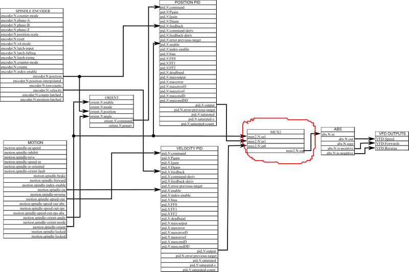

<thinking aloud>
You can "sets" the spindle-index-enable in the HAL file.
If the position-control loop was arranged to output a fixed spindle speed if the index-enable was still set when position mode was enabled, then the spindle would first move through index before aligning itself.
This could be done with a mux2, I _think_ that the mux2.N.sel pin can be connected to the index-enable signal, but I am not 100% sure.
One would have to be careful to consider the case in a specific HAL file where the spindle was in velocity mode for rigid tapping (as an example) where the index-enable pin goes high before the start of the move.
In the typical setup:
You could replace the circled Mux2 with a Mux4, and connect position-mode-and-index-enable-set to a fixed speed, position-mode-and-not-index-enable to the position pid, and the other two inputs to the velocity pid.

Sorry to hijack but I must know.
How did you generate the HAL diagram in the above post?
- Posts: 19908
- Thank you received: 4658
02 Sep 2015 16:17 #62059
By hand. I did it some time ago for the Wiki.
The component tables were copy-pasted from halcmd to Excel, then formatted and aligned there, and copied to Inkscape where the arrows were added.
Replied by andypugh on topic Homing the Spindle
