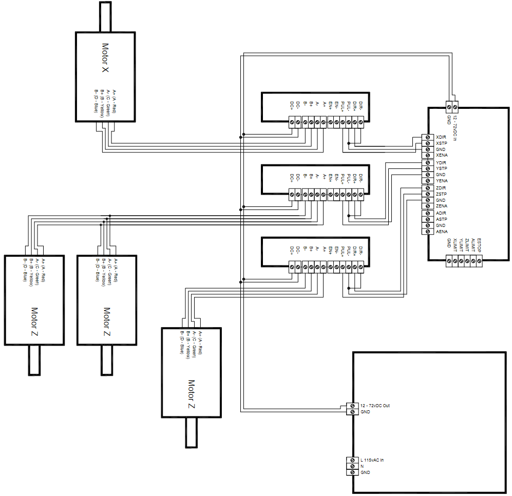

- cncbasher
- Posts: 1744
- Thank you received: 288
05 Sep 2015 16:24 - 05 Sep 2015 16:36 #62144
by cncbasher
Replied by cncbasher on topic Using Axis to drive DC motors via quadrature
Jerry
the main problem is not the question of lcnc but down to the actual hardware , i doubt with everything else , you'd manage with a parallel port
if you seriously want to increase , you'll be far better saving for a mesa 5i25 /7i76 combo etc .
reason being this take the stepgens off from being software generated to being in hardware inside the fpga chip
this takes things like latency out of the equation , and you get quadrature encoders and just about every permutation of connections out
but this comes at a price .
it will give you about a 10x increase in clock speed over a parallel port
software can only run so fast ,
but as all things it's down to budget , but once bitten you'll never go back haha
as far as controllers go , the cheap chinese boards stay away from them
if one driver fails the whole board fails ,
go for seperate leadshine controllers capable of say 60v , and get a seperate power supply capable of about 5 volts lover that the drivers , but at least 10 amps , more the better
you'll find easier to work with , interface bob go for the non opto type if you can , as the leadshines already have opto's so you dont need 2 for each sig
the higher the voltage of the drivers the better , but dont exceed the psu keep around 5v lower
see attached general connection , if you need to
