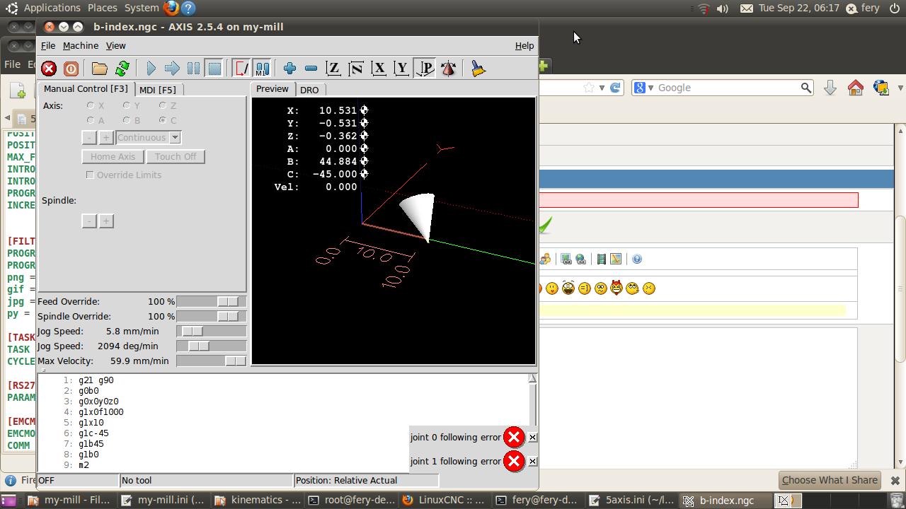

How to fix this problem..??
on the 5axiskins.c, if i use :
*(haldata->pivot_length) = 10.0;
no error..
but if i use :
*(haldata->pivot_length) = 250.0;
show error (joint following error) like this:
no error..
but if i use :

This probably means that the result of the calculations are such that the motor can not turn fast enough to follow the commanded motion of the controlled point.
Or, conversely, that the normal positioning error from the encoder feedback is magnified at the controlled point by the long pivot length so that the f-error limits are exceeded.
Have you tried adjusting the f-error limits? How do those limits compare to encoder resolution and the linear movement of the controlled point at a radius of 250?

Thanks andy. you right..
Now i use f-error=100, and the result is no error
but, could i use this f-error value?
what the meaning of f-error?
is it safe if i implement on the machine?

www.linuxcnc.org/docs/html/config/ini-co...s__lt_num_gt_section
Replied by andypugh on topic Joint following error
Look at FERROR and MIN_FERROR here:what the meaning of f-error?
I don't know, that is for you to judge. But it seems high.is it safe if i implement on the machine?
