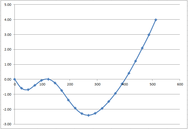

wrt to correction curves, the datasheet for the max31855 says
"Because all thermocouples exhibit some level of nonlinearity, apply appropriate correction to the device’s output data."
they outline the logic in their evaluation kit
forums.adafruit.com/download/file.php?id=25577
i think the max31856 has linearization built in.
thanks for for the help and guidance
11 Apr 2016 04:53 #73091 by andypugh
Replied by andypugh on topic best way to do temperature pid with linuxcnc
So it does.
docs-europe.electrocomponents.com/webdoc...0900766b813d54ca.pdf
I had missed that.
The question then becomes "how much is the error, and do I care?". For a filament extruder or similar you probably don't care about the _absolute_ temperature, and can optimise your machine around a slightly different temperature scale.
this graph shows the error in the output of the 31855 output against temperature.
I think this is a case where I would accept the error for my own use, but feel obliged to correct it in something I was planning to release to the wider world.
