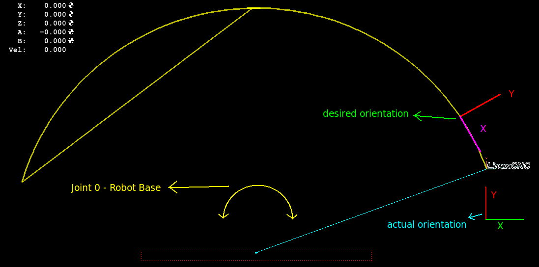

Hi everyone,
I have a issue with my homing configuration and the orientation of my robot.
I have a 5 DOF industrial robotic arm, I set the ini file to home all joints, but when I want to run any G program, the orientation of axis Z is wrong (same axis of the robot base). You can see the picture...
The joint 0 angle home in the ini file is 70°, and this is the offset that generates the issue........
How can I offset that? or Are there another solution?
Thanks a lot.

Replied by andypugh on topic Orientation Error when homing Robotic Arm
Maybe you need to set the HOME_OFFSET to -70 ?
