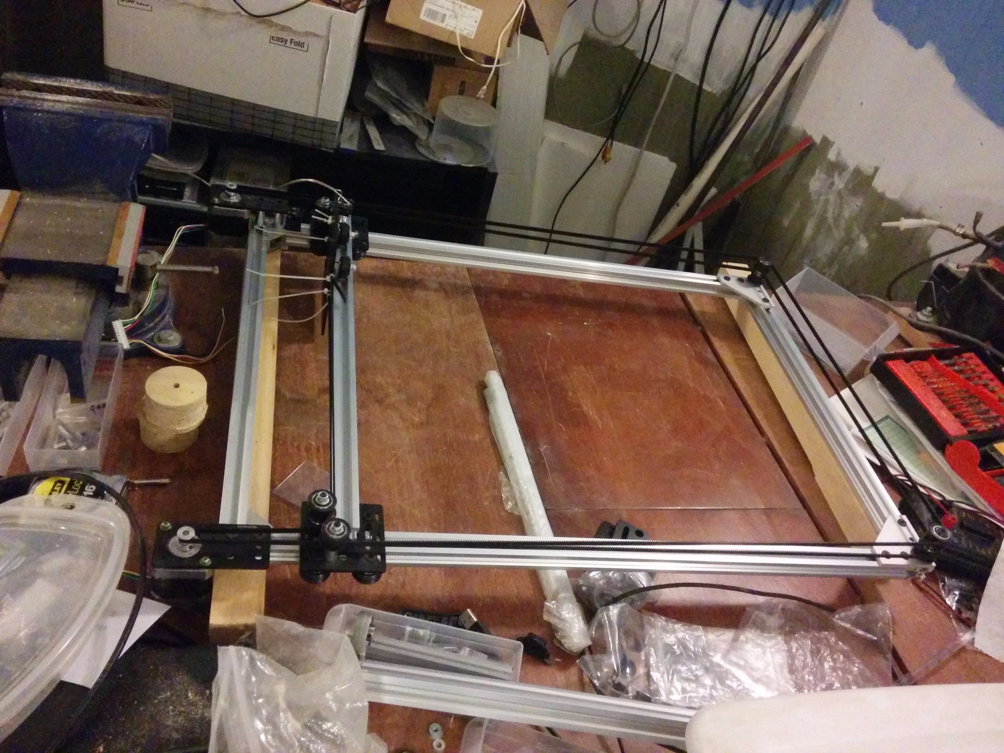

I'm interested in building a Rail CoreXY in the near future to replace my cheap Prusa i3 clone. Do you have a photo of your machine? And thanks for the links to the kins.

Re BigJohnT: Attached below, but right now there's not much to see. Currently I just have an 'XY' axis dummied together and stood off the table with wood scraps until I can confirm there is a path forward getting the kinematics working correctly. The Z is actually hooked up to my earlier CNC build on a separate table (not pictured - a MDF and pipe clamp monstrosity) just so LinuxCNC has something to home. I think you're onto something about the kins being bugged; see below.
