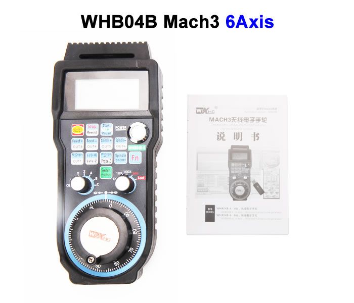

I had recently bought
this
device and now need some help here. So I tought for some unknown reason that this is the same device just like the XHC-HB04 but with 6 axes. But it is not. So I need to write a code to operate this MPG.
I thought the the drivers for the xhc-hb04 would be a good starting point, so I have copied the cc, tcl etc. files and renamed them to whb04b accordingly
I have done so far:
1. replaced the USB id in whb04b.cc from 10ce:eb70 to 10ce:eb93 as the transceiver is using this. Compiled successfully. When I ran whb04b alone, Im receiving something, as lines advancing with working with the buttons.
LinuxCNC wont start it stucks in waiting for components to become ready and giving me a steadily growing bunch of dots. Forever.
Now Im stuck, dont know where and what to look for. My guess that the "magic" packet is changed and the hal driver cant recognize the mpg. But how can I test it ? What Should I look for?
any help will be appreciated.
I have done so far:

I made some progress, restarted from scratch from github source, compiled the module, and now it definetly working. Because it is doing something: randomly changing manual, mdi modes, and switching off machine when I play on the encoder, so there is communication, there is sometimes a percent (%) sign appears on the encoder, so the communication is two way, now I need to adjust the settings and debug the protocol.
Anybody knows how to do it ?

with whb04b program itself I have identified these output commands:
Axis select:
04 XX XX XX XX 06 XX XX - Off
04 XX XX XX XX 11 XX XX - X
04 XX XX XX XX 12 XX XX - Y
04 XX XX XX XX 13 XX XX - Z
04 XX XX XX XX 14 XX XX - A
04 XX XX XX XX 15 XX XX - B
04 XX XX XX XX 16 XX XX - C
Resolution
04 XX XX XX 0D XX XX XX - 1X
04 XX XX XX 0E XX XX XX - 10X
04 XX XX XX 0F XX XX XX - 100X
04 XX XX XX 10 XX XX XX - MPG
04 XX XX XX 1A XX XX XX - Lead
Buttons:
1 2
04 XX 01 ZZ XX XX XX XX - Reset
04 XX 02 ZZ XX XX XX XX - Stop
04 XX 03 ZZ XX XX XX XX - Start
04 XX 04 ZZ XX XX XX XX - Feed+
04 XX 05 ZZ XX XX XX XX - Feed-
04 XX 06 ZZ XX XX XX XX - Spindle+
04 XX 07 ZZ XX XX XX XX - Spindle-
04 XX 08 ZZ XX XX XX XX - Morigin <-
04 XX 09 ZZ XX XX XX XX - /2
04 XX 0A ZZ XX XX XX XX - Worigin <-
04 XX 0B ZZ XX XX XX XX - Spindle On/off
04 XX 0C ZZ XX XX XX XX - Fn
04 XX 0D ZZ XX XX XX XX - Switch Coorinate
MPG:
04 XX XX XX XX XX 01- XX - MPG+
04 XX XX XX XX XX FF- XX - MPG-
04 XX XX XX XX XX 00 XX - MPG idle
And I dont know what second and eight column does, they seem to change with every input, but I cant see the relation.

8th column could be a checksum, or even a serial number.

Here we see that mpg pulses are in bytes #6, instead of #4 for original XHC-HB04.
You will need to patch here: github.com/LinuxCNC/linuxcnc/blob/af15a4...mps/xhc-hb04.cc#L440
Also, you will need to adapt buttons coding.
But the tricky part will be adapting the LCD display framing, if it has changed.
To guess the framing, one solution is to boot a windows machine with the official driver, and capture the USB traffic with an USB analyzer software.
Would like to help, but I do not have this pendant on my side.
Frederic.
