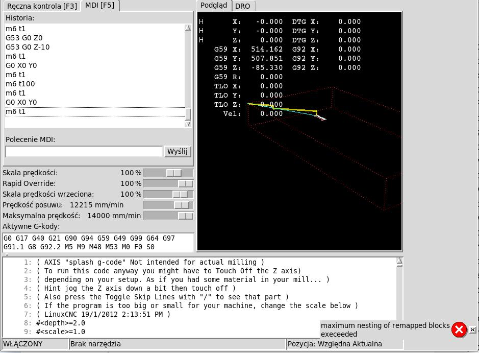

14 Aug 2021 10:44 #217752 by szatri
Replied by szatri on topic auto tool measurement working
Hello, I have a problem with this tool measurement procedure (in total and with a few others). The program starts normally, the machine is based on limiters, and in MDI I will enter M6 t1. It shows me a message that I don't understand, I don't know where the problem is.
16 Aug 2021 18:38 #217928 by andypugh
Replied by andypugh on topic auto tool measurement working
Can you paste the [RS274NGC] section of your INI file?
17 Aug 2021 09:26 #217987 by szatri
[RS274NGC]
PARAMETER_FILE = linuxcnc.var
SUBROUTINE_PATH = ./ngc
FEATURES = 12
REMAP=M6 modalgroup=6 ngc=tool-change
REMAP=M06 modalgroup=6 ngc=tool-change
doubling this entry is probably not necessary
