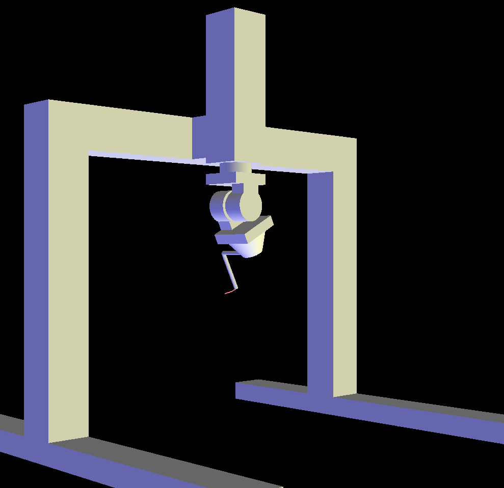

Here's an example of what I am trying to do. This right angled shape would be just one tool I want to change to, with the two pieces being
1) automatic cascading of tool offsets to kinematics
2) Getting the trace in vismach to match (tool model not so important)

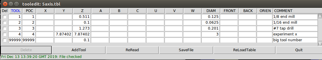

The tooltip describes an arc, rather than pivoting about it. My tool is 200 units in the z and y, so I changed this section in the 5axisgui to:
Its entirely likely I have 100% misunderstood the purpose of this part however. Out of curiosity, where is self.comp.tool_length defined? I noticed that the pin :tool-len reflects the value in the tool table (7.84) rather than the 200 input here.
I use T4 M6 G43 when loading the tool.
Here's the tooltable. I tried putting inches and mm (200mm, ~7.87 inches). I am using tool 4
from vismach import *
import hal
import math
import sys
# give endpoint Z values and radii
# resulting cylinder is on the Z axis
class HalToolCylinder(CylinderZ):
def __init__(self, comp, *args):
CylinderZ.__init__(self, *args)
self.comp = comp
def coords(self):
return -self.comp.tool_length, 0, 200, 200Its entirely likely I have 100% misunderstood the purpose of this part however. Out of curiosity, where is self.comp.tool_length defined? I noticed that the pin :tool-len reflects the value in the tool table (7.84) rather than the 200 input here.

Looks like I have made a bit of progress, I can now get the tool offset to show up by piping the HAL pin to the vismach script, updating the tool size in vismach and the tool point.
I assume now something clever needs to happen with passing that new length to a kinematics script, I note that xyzac-trt has some of this built in so will raid that for guidance!
