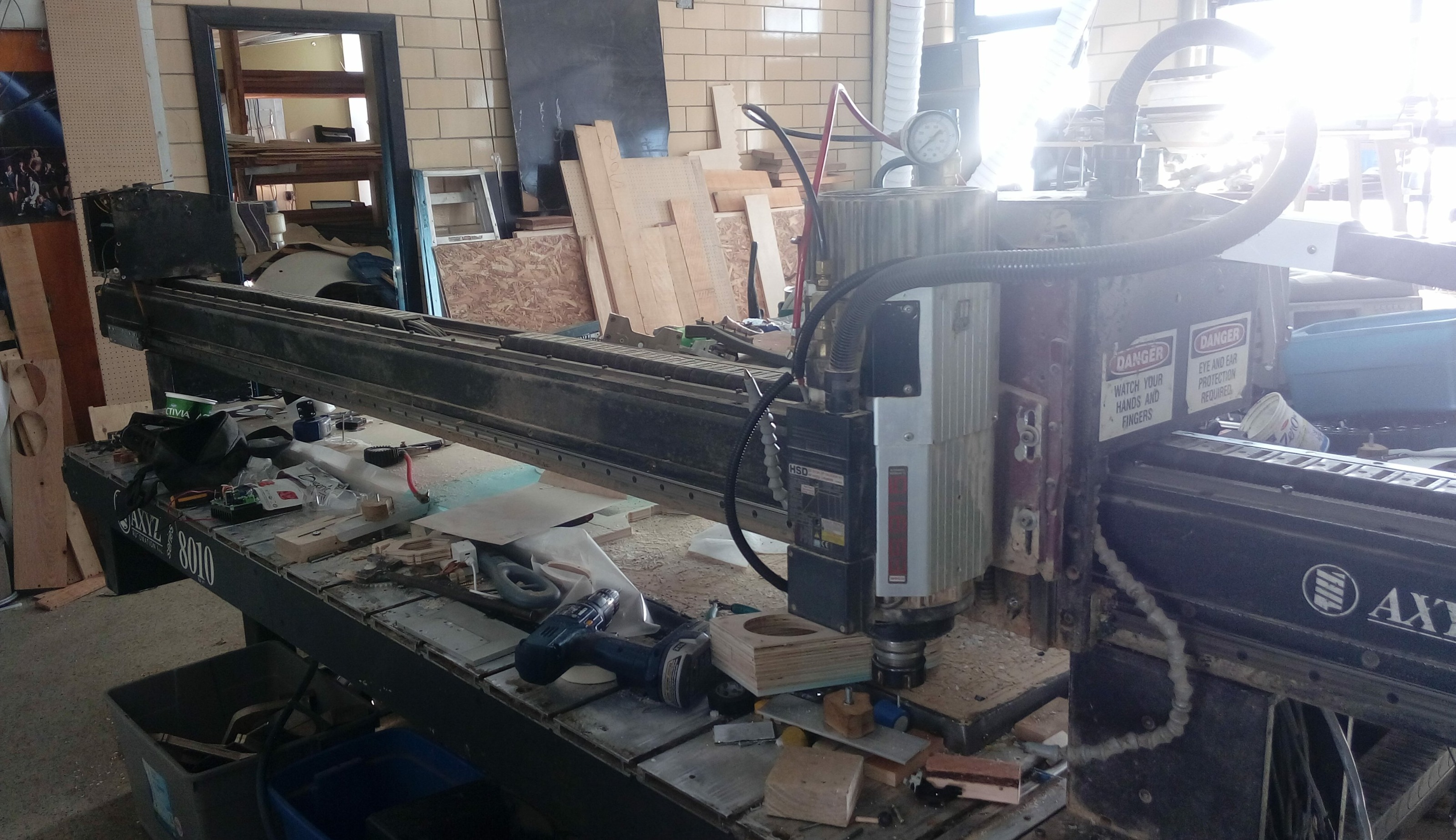

I have a gantry with two tool heads, they were originally meant to work in tandem on production runs.
I would like to use one head for the drill and the other for the laser.
The drill works fine on the y axis.
The laser works fine when mounted on the drill. But the 25 kg drill has a bit of inertia and enhibits the laser to move fast for engraving.
Each head can be parked out of the way so they would not be traveling together.
My question: my question is how to select a head (tool) to park the drill and make activate the laser.
and vice versa?
Also, it would be nice if the Y coordinates be used for both heads.... in other words, I wouldn't have to post process the Gcode for to change the Y axis to A . but this is a possibility.

Good luck, and the machine looks stable !

this machine was built like a bridge.

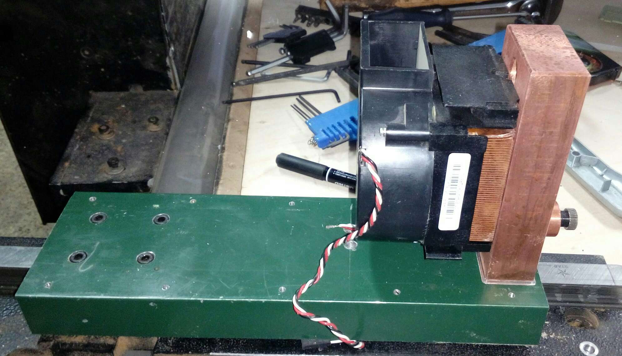

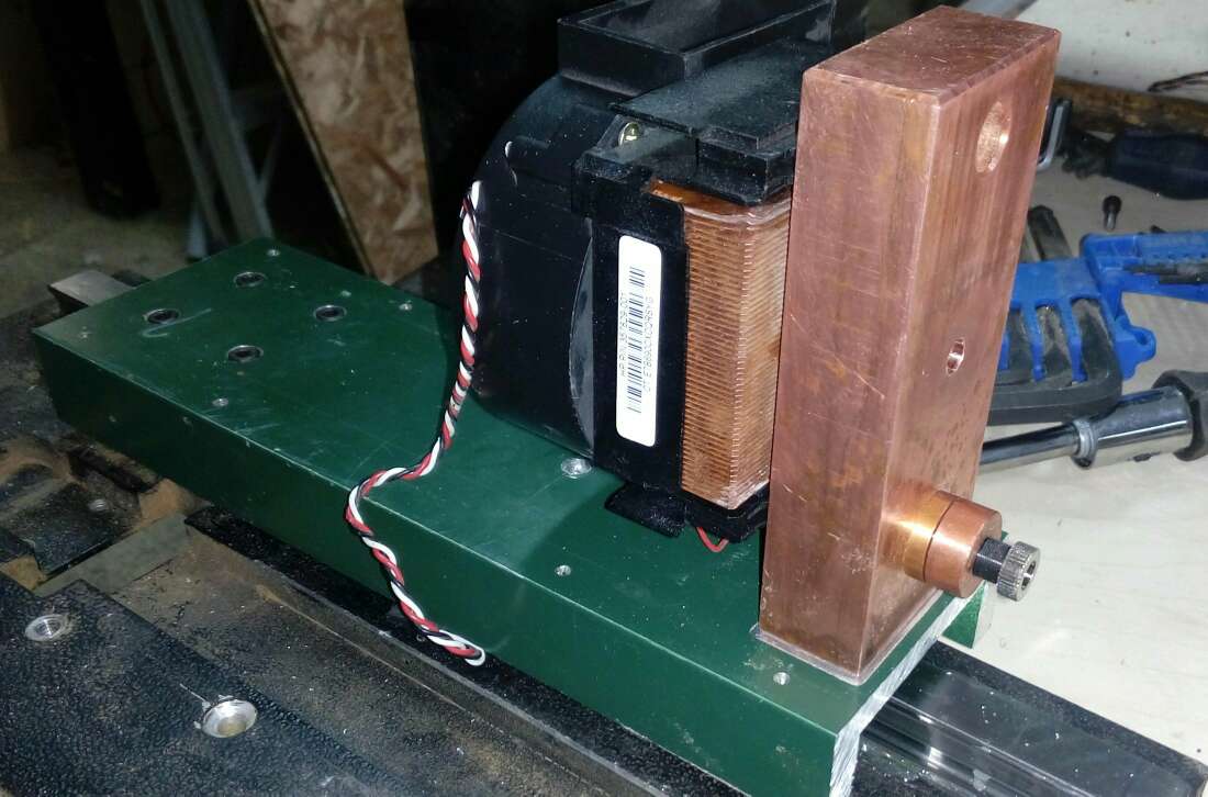

I am currently building the laser head - 7W Nichia with integrated PWM drive in the copper holder mounted on 2kg copper block with a copper heat sink and a 15W blower which is temperature sensitive (the hotter the air the more the blower works) all that mounted on a 8mm thick aluminium U channel which also provides heat sink.
