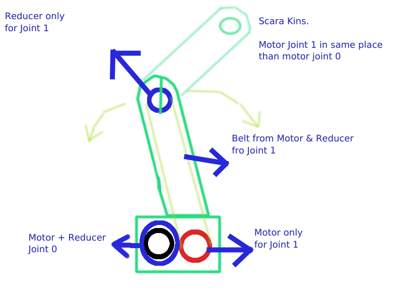

I created a scara as a 3d printer, to have less weight I put the motor of the joint [0] and joint [1] in the same place on the structure, while I put the reducer alone in the place where normally the motor + reducer is located in a traditional scara.
I am attaching a sketch .... I have arranged the kinematics as per the attached file .... I have created a pin to introduce the reduction value between the motor and the Joint [1] .... I use that value to correct the kinematics.
I haven't tried yet because I'm afraid to break everything .... can you go?
regards
bkt

void rtapi_app_exit(void) { hal_exit(comp_id); }I haven't tried yet because I'm afraid to break everything .... can you go?
regards
bkt

dont you fear the Print can grap your arm as there is no Spring load and the arm will pull load on the print

my fear is to go crashing at the physical limits (structure) ... in fact the arms of the scara are made of printed petg-carbon fiber and I would not want to slam break them .... it has happened to me once .... I don't want it to happen again.
So before powering up again, I'd like to have someone's opinion and understand if I made mistakes.
It's been a while since I haven't been trafficking on the kinematics and I could have made mistakes that I don't see.... plus in addition I have never been a genius in these things.

For sure my kins is wrong .... because i need to use angle of joint[0] not joint [1].... these for those people that whoult try to use it.
