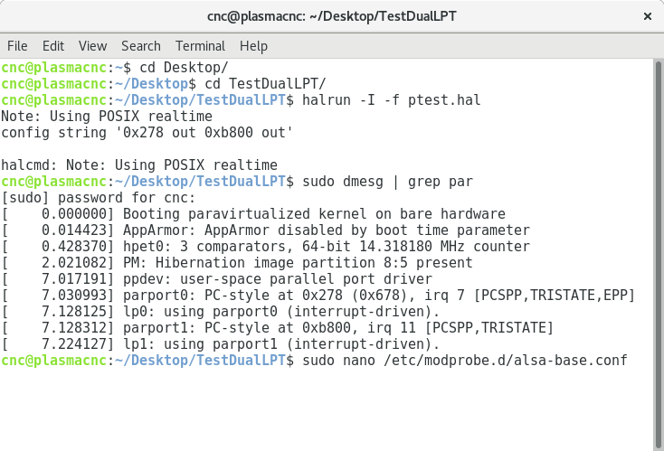

I have finally solved it
Steps:
1. Add new file

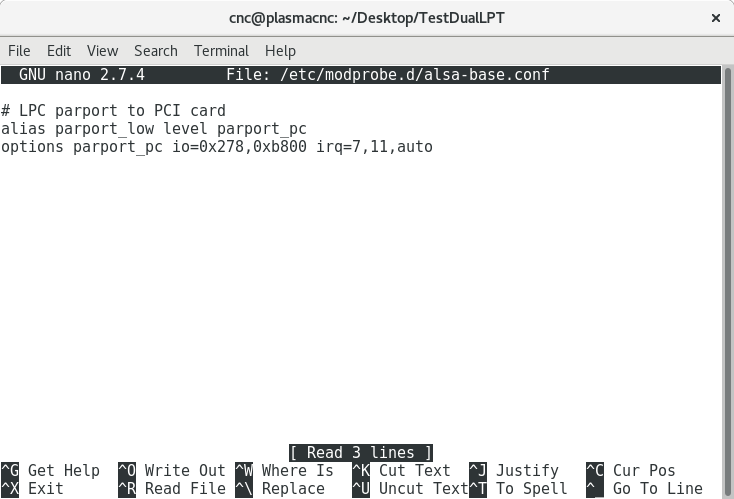

/etc/modprobe.d/alsa-base.conf
2. In the file, I've added BOTH ports - the onboard port by the base address and PCI card by the address from commands
dmesg | grep par
lspci -v
3. Rebooted the PC
sudo reboot
After that operation, I've changed settings in sconf by setting parallel port address as 0 for the first port and 1 for the second port. It also solves the problem with the test reporting port error :D

The first hint was that the test app (ptest.hal) works OK and that was suggesting that I have fully functional hardware (as it was linked by address). Then I figured out that both ptest and LinuxCNC are giving me the same error saying that port @47104 cannot be loaded - that is the decimal value of the port address 0xb800 in hex. I've checked that it requires a port which is in the sequence of 0,1,2... so I thought that what is missing is mapping of the address to the port number and then I have discovered how it's done...

1. First, run "lspci -v" to check if the device providing additional ports is detected
2. If detect note it's address and IRQ
3. Next, run "sudo dmesg | grep par" - that will give you the list of lp0 (or lpX) ports that are already "mapped"
4. Note port address and IRQ of existing ports
5. Edit or create /etc/modprobe.d/alsa-base.conf and add lines as per my config, where "(...)io="<LPT1 address>,<LPT2 address>" irq="<LPT1 IRQ>,<LPT2 IRQ>,auto"
where <LPT1 address> is the address of lp0 listed on "dmesg | grep par"
where <LPT1 IRQ> is the IRQ of lp0 listed on "dmesg | grep par"
where <LPT2 address> is the SECOND address of PCI card listed on "lspci -v"
where <LPT2 IRQ> is the IRQ of "lspci -v"
I hope it will help others in the future. If you need any help then send me PM.

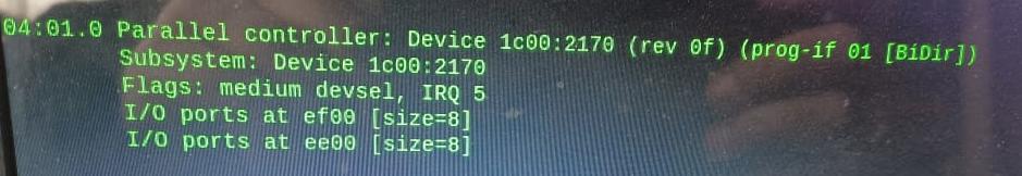

Hi all. i have lpt pci
the output of lscpi -v gives the output that the port is in the slot.
but in "sudo dmesg | grep par" I don't find the parport.
what are the options? look for another lpt pci?

Try the addresses shown on the firt picture,
0xef00
And if it does not work, try
0xee00

thanks.  this is the first thing i tried and it doesn't work

How doesn't it work? No outputs or fails to load the driver?
